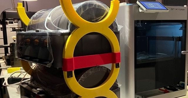

This V3 version has new first stages that are Orange vs the V2 that are Yellow and of course different than V1 which requires a logic board replacement to use these new Feeders.
The case is also different now. This is the third type of case out in the wild with a different distance between the side mount slots. Had to adjust the model to support this new AMS vs the other two version I have which are also unique to each other.
Have not opened it up to see if there is a new logic board or second stage but clearly a new version has silently come out.

The one I used is this model for the rack.
and just cut out the two posts on each side of the center post as seen on the image… The original files were not in the project and did not feel like re designing the model since it was and easy cut and fix to support V3 AMS’s

I have the new style AMS purchased in February 2024 and I made a stand for it and my AMS purchased July 2023 with 5 pockets in the side. I posted it on MakerWorld: AMS Mount - 2 tier tall stand that does not use much desktop space. by Ovityons - MakerWorld
