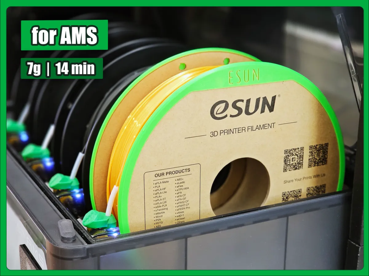

I have a couple friends who use Overture and Polymaker that have cardboard spools. They use an adapter like this:
And have stated they have not had any issues. I’ve not used the adapter and just respooled. The adapter would be easier so if you use a lot of filament that has cardboard they would be worthwhile.

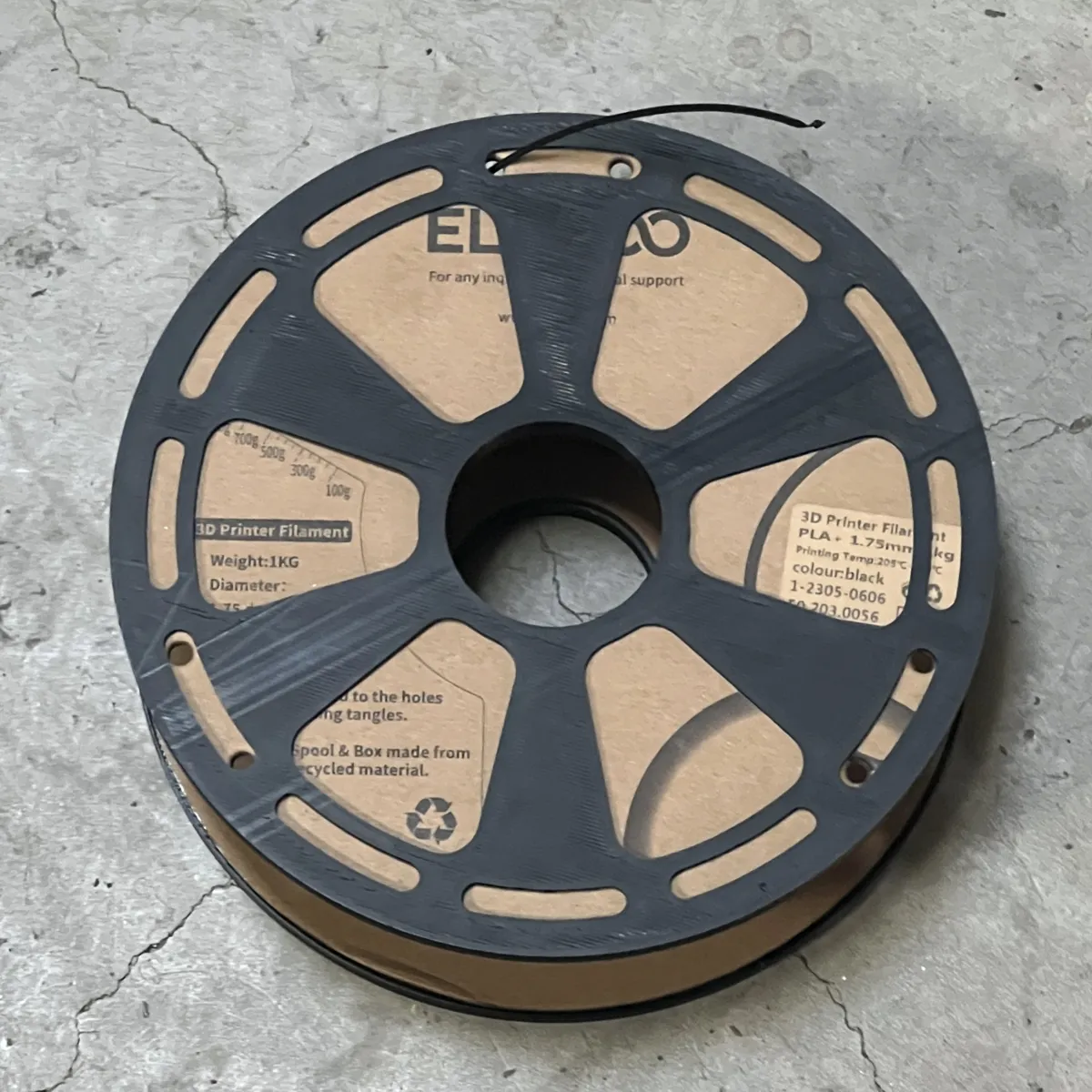

I tried one kinda like it. Didnt work for me, they did t fit well and fell off or broke. I used one like this and it seems to work fine so far
To clarify - it was that type of adapter for the cardboard spool they use. I’m not sure which one exactly they are using.
The one you picture certainly looks more durable than the quick look version I posted.

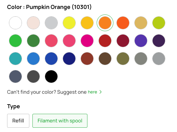

For a complete 3D printing newbie, I would recommend using Bambu Lab filaments for at least the first month or two. This will help make things simpler at the beginning.
The Winter Sale is on for a few more days until the 5th. To get the bulk savings, order 14 rolls of filaments, most if not all, PLA Basic filaments. This is a very good deal for Bambu Lab filaments.
There are a few color choices of PLA Basic that have the option of coming with a spool. Buy a few of those and you would have some spools to use with refills later.
