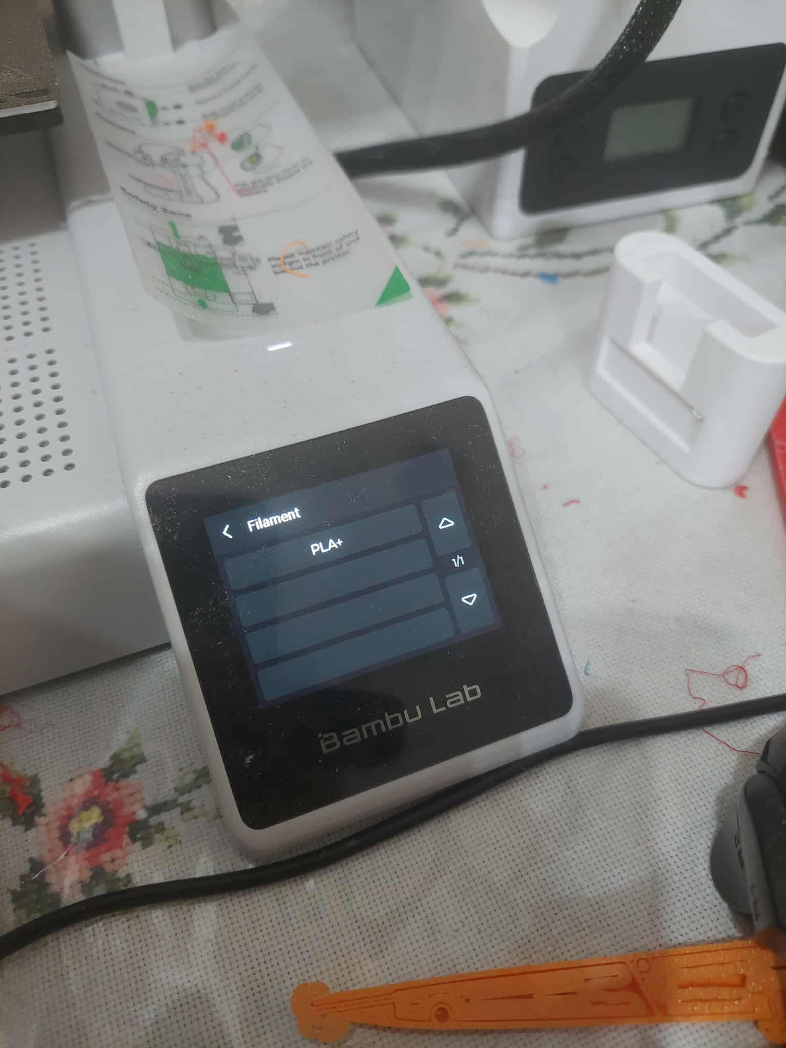

When trying to set the settings on the mini screen on the printed,under esun menu there s only pla+,no petg.What can i do?

Can you clarify what you want to do?
Did you use to have PETG in the menu? If so, discard the text below.
If not, note that these built-in presets for third-party filaments are limited to some brands and filament types.
If you are looking for the straightforward solution, select Generic–> PETG as filament. This is the standard for any unlisted filament.
Alternatively, create your custom filaments, where you could set PETG for the eSun vendor, e.g. Creating custom filaments in Bambu Studio | Bambu Lab Wiki.
If you need further details on how to, let me know.
Add customs filaments in Bambu Studio. Then use Bambu Studio > Device to select filament. There is no reason to use this screen to select filaments.
