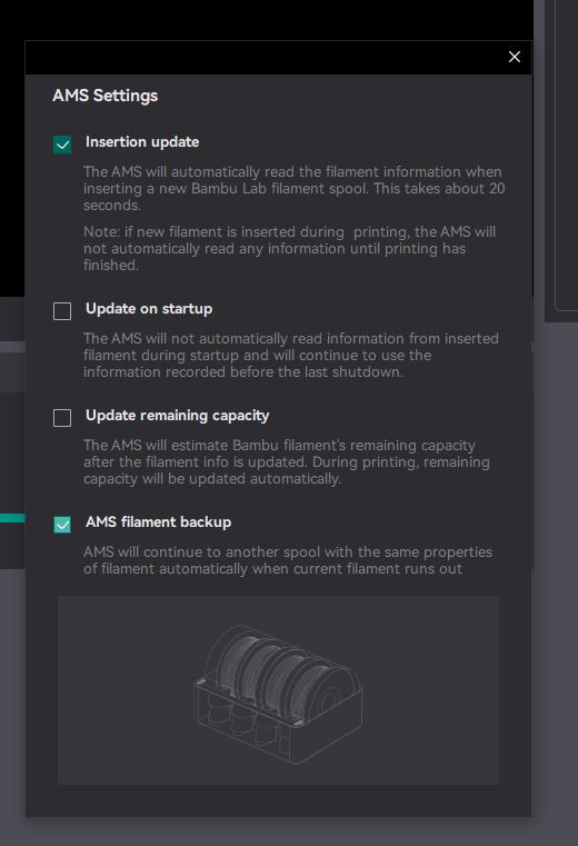

Twice ive had prints continue after filament has run out. Im not using the ams, as the filaments are abrasive. Is there a setting im missing somewhere? I cant find any info on this. Advice appreciated thanks.
Hello s.3,
I don’t know of any other settings unless for some strange reason you have to have it turned on in the AMS so the side load option will detect it but I have not tested this out yet on the side load option.
But it looks like it should work Filament runout test this guy has a video on it :grinning:
AMS Settings:
Let us know what you find out :v:
Thanks, ill enable that setting & see if it works.
This worked, thanks for your help!
