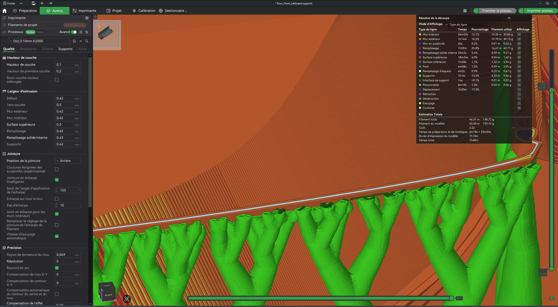

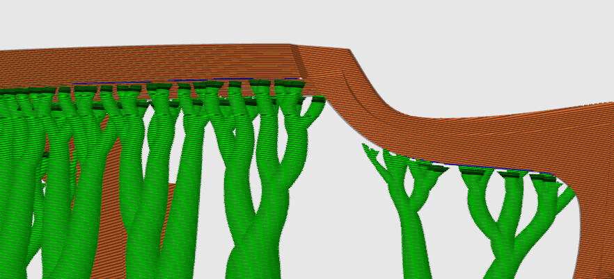

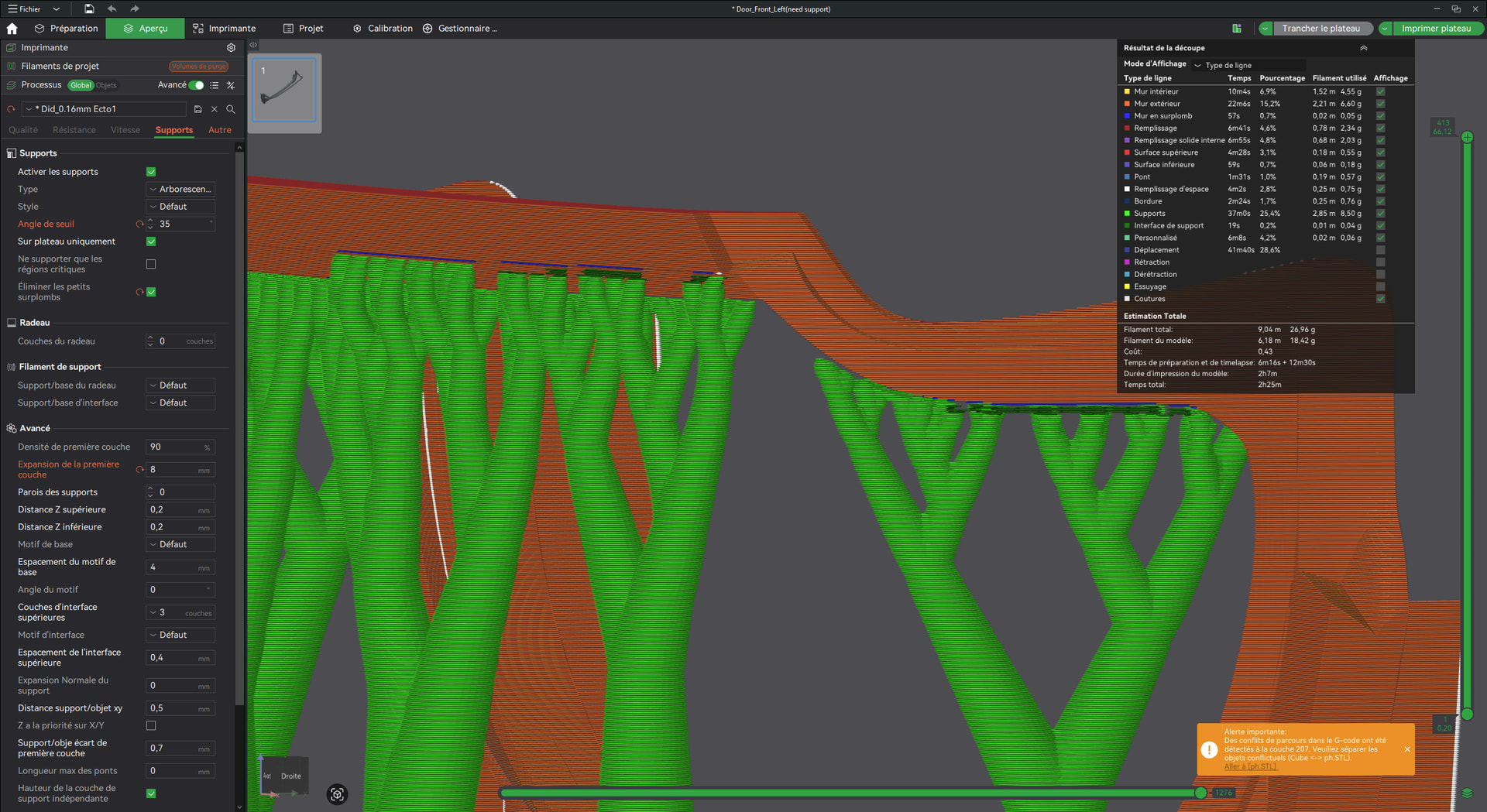

No interface on certain parts of the media! Since the update
nothin under the wall no INTERFACEs !!! SINCE update

Can we assume you have tried messing with number of interface layers, style, etc with no improvement?

Door_Front_Left(need support).3mf (392,8 Ko)

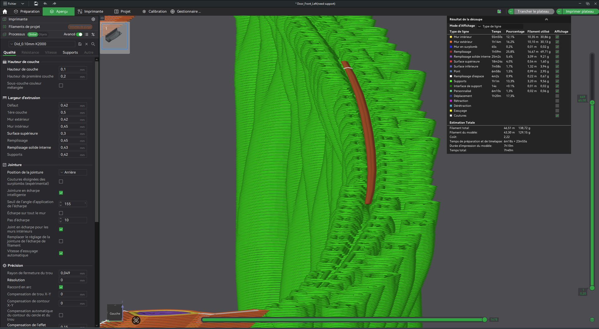

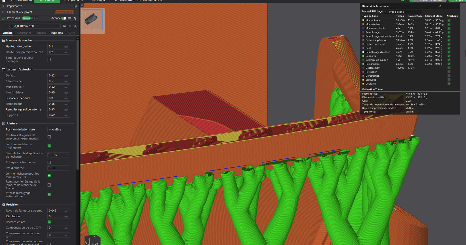

This is the 3MF look at the top of supports , INTERFACE is MISSED in some parts , nothing under the walls
this is the 3mf , notice gape without INTERFACE on many tops of supports

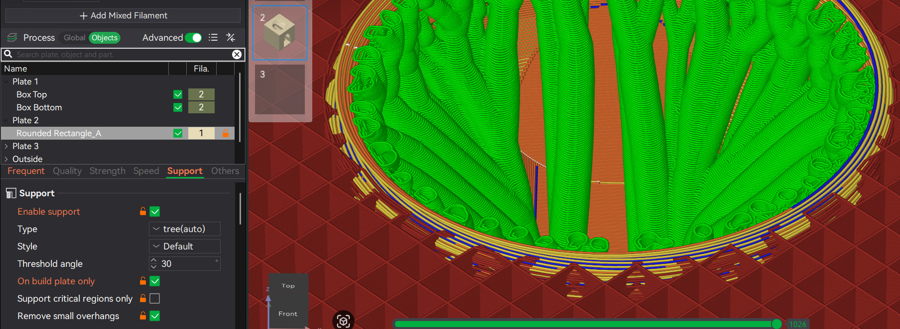

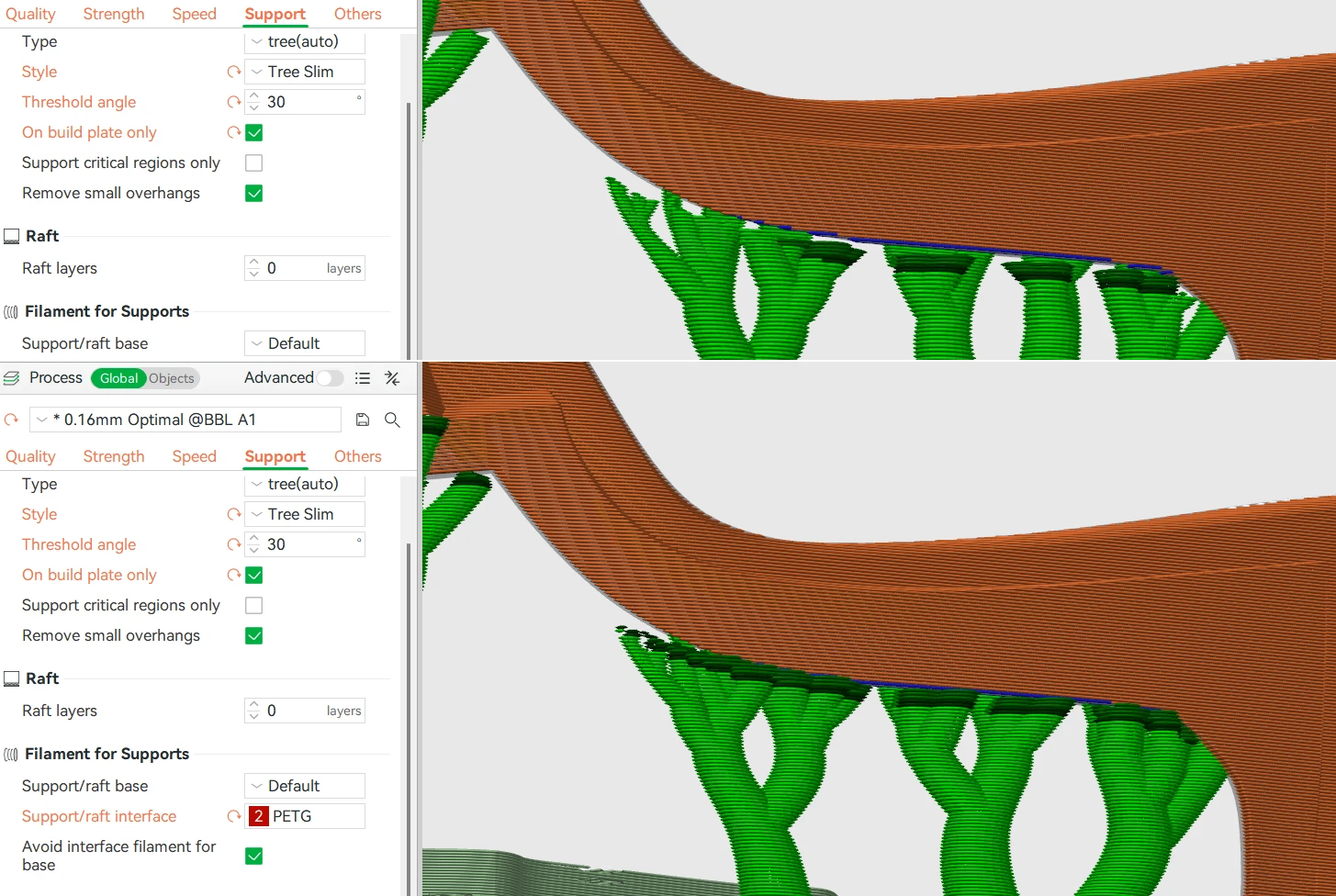

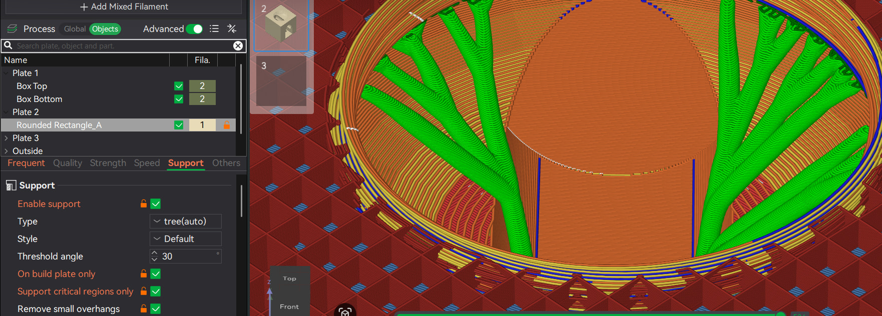

Tree styles Slim, Strong, and Hybrid will provide more interface than Default or Organic. There are narrow, upward-curving areas that will still lack interface, but I think those areas might print without support anyway. The bug might not be a lack of interface, but unnecessary tree branches.
I do have have other questions about the project.
  • Were the many changes to the default support settings an attempt to create more interface, or were there other reasons?
  • The two Cubes are different sizes and placed asymmetrically. They are also not merged with the rest of the model, causing G-Code conflicts. Are the cubes supposed to be integral to the model?

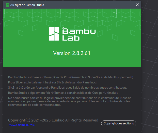

Whether I’m using the latest version or an older version of Bambu Studio, I get the same result when slicing. Have you tried an older version of the slicer yet?

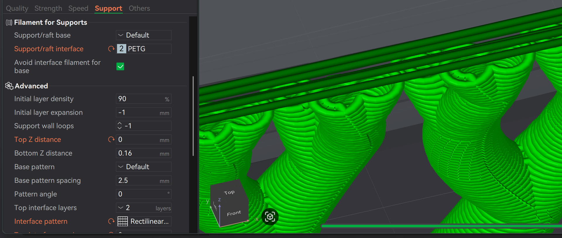

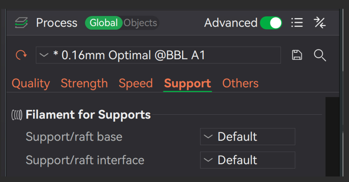

Do you want to use support interface explicitly?
If so, you’ll need to enable it; it’s currently disabled in your 3mf:
If I configure it and use PETG as the interface layer, for example, then it works as intended:

On narrow parts of the model, the slicer has little choice in how the interface lines are laid down— it cannot create an interface with less contact. If the interface material and the model material are the same type (PLA and PLA), there is no point in switching filaments because the very small amount of contact will be the same. Only if the materials are different (eg., PLA and PETG) does the slicer switch spools and show an interface layer.

Even after several requests, the version number still wasn’t provided - fortunately, it was included in the 3mf file. It’s very hard - if not impossible - to understand what you’re trying to say. This isn’t meant as criticism, but it does make troubleshooting extremely challenging.

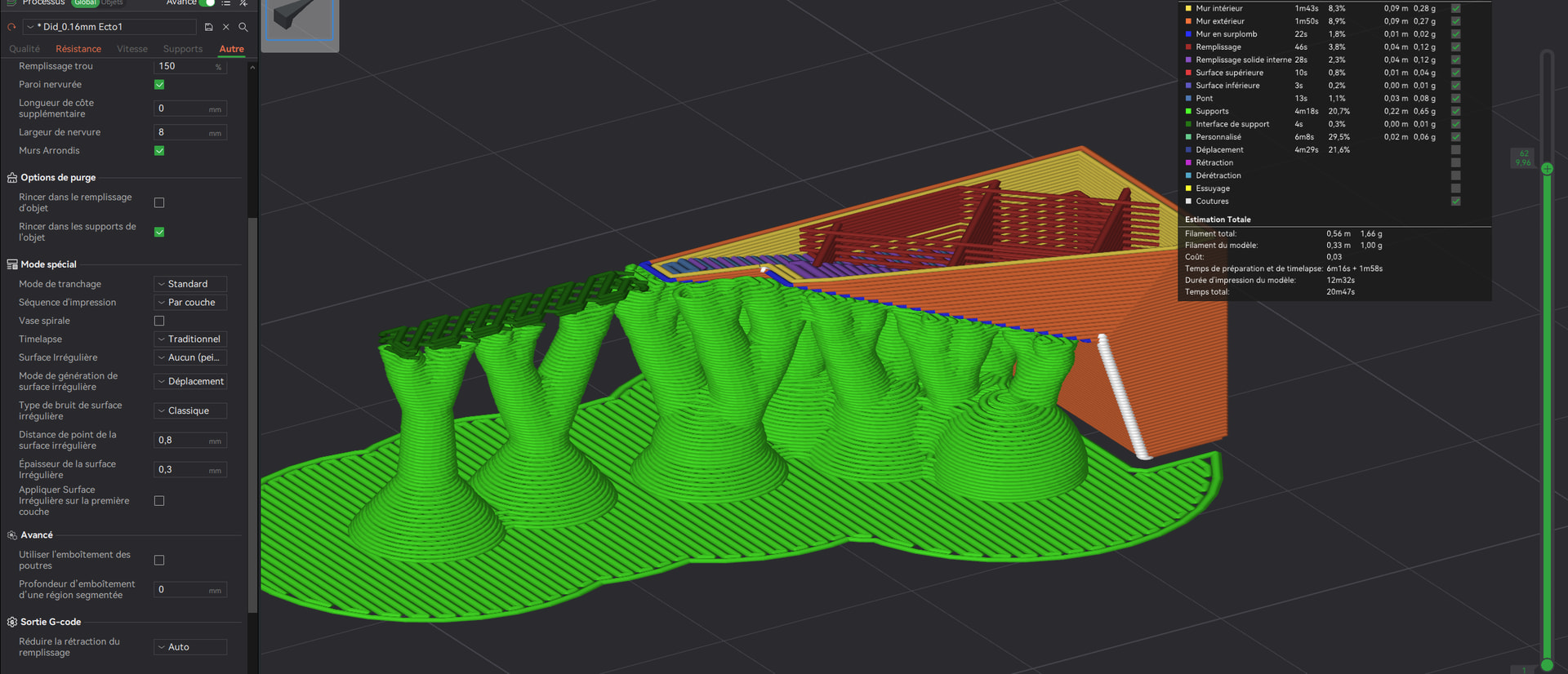

Just because there’s no interface layer in between doesn’t mean it’s floating in thin air; that assumption is completely wrong.
And now, as the next step, please do this: As mentioned in the first comment, please let us know if the problem goes away. :grin: :+1:
None critical supports appear to be missing a interface .
Perhaps because thet are not needed ? as with this thread
