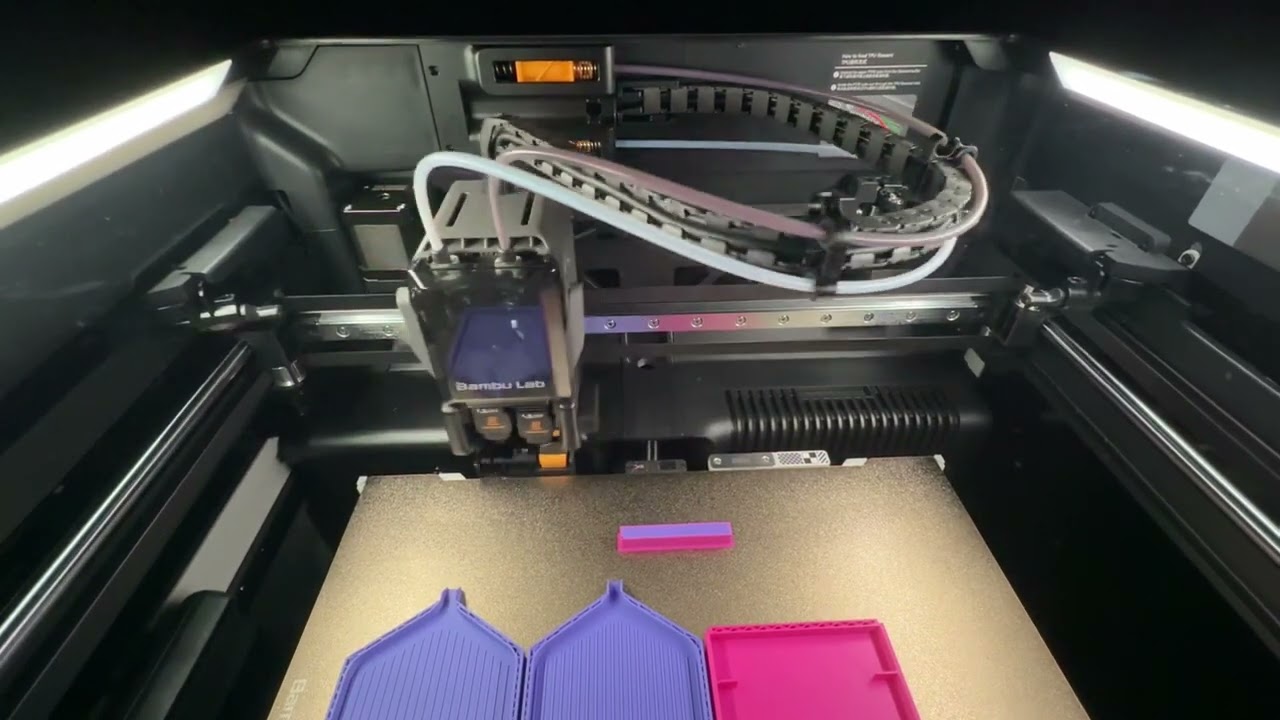

Hello my machine has been making a noise when switching from the Left to right nozzle. It has made it since day 1 however it is getting quite worse. I have opened up a ticket however would like to see if the community has any ideas either. I have pulled PTFE tubes and looked around the tool head but not seeing anything. I am thinking it is the buffer making the noise but haven’t looked into how to remove the assembly and check it.
https://youtu.be/RZHHHy_CGwg
If you remove the filament from both extruders, you can manually switch the nozzles in the menu. Then you know if it are the nozzles or if it’s the filament in the buffer.
Thank you will try this… it looks like the noise happens before the extruder switch cam even begins to turn. This is why I was leaning towards buffer and only on Left to Right does not do it on Right to left. It is odd, the noise was barely there when I got it but now it is louder than the printer by a good bit
Might it be related to the AMS? You might try to disconnect the AMS and set up 2 external spools. Check if it still happens.
If it’s still there, then the buffer is probably the cause.
