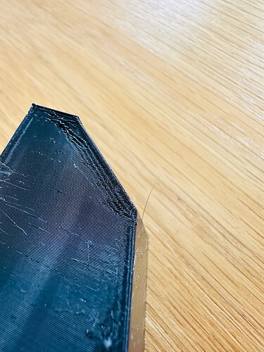

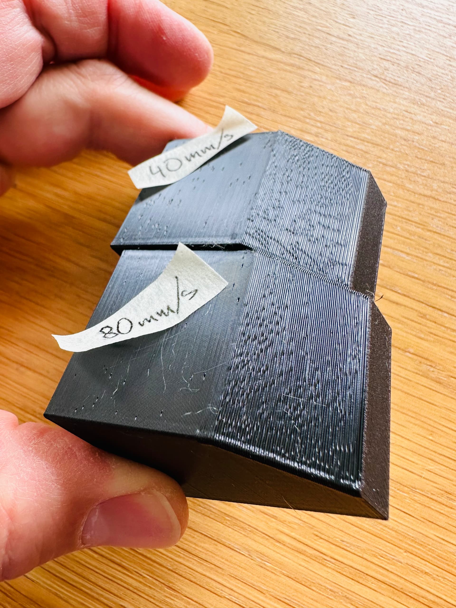

I am printing a Box with wired angels. I ran all the calibration test in orca slicer 1-2 weeks ago, tried different settings, fan speeds and so on…
I ran out of ideas by now… so the thing why i am posting this is i always get the same wired pimple and wavy pattern. I will share the .3mf file and some pictures.
I would really appreciate any helpful ideas to get a perfect(ish) result.

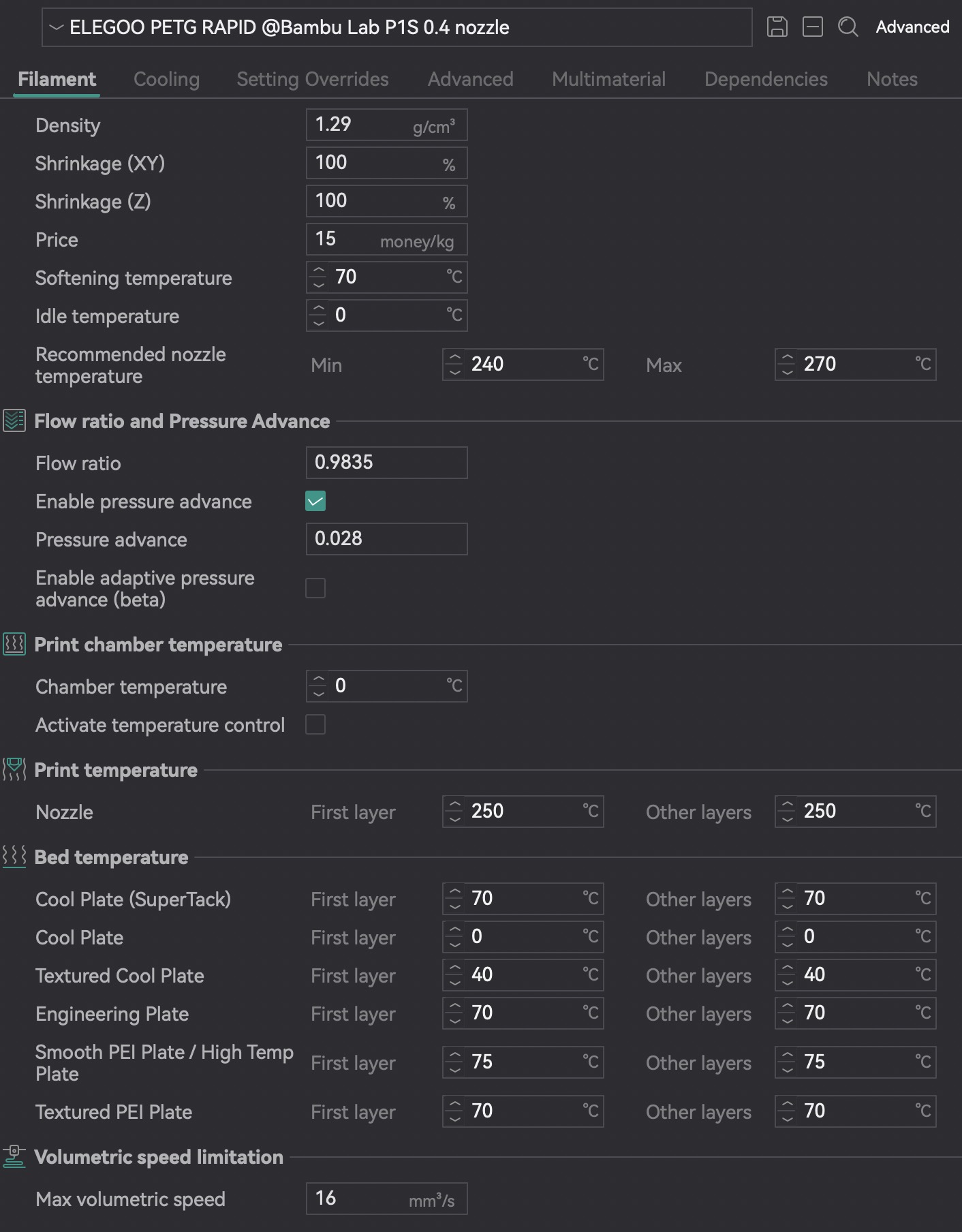

Slow down print speed for start, like under 100mm/s. Secondly what is your PA?
Hi Simon,
what is PA? Pressure advance? that would be 0.028

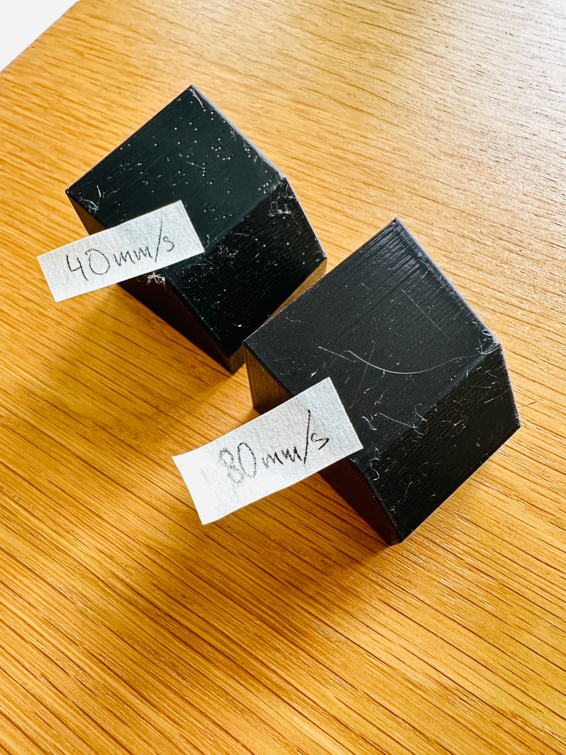

I am printing it now at 80mm/s right now… lets see how that turns out :wink:
hate to be that person but you never mentioned if you dried your filament or not.
hehe… its always good to be on the safe side. Yes its dried :wink:
so i printed one at 80mm/s yesterday… looked a bit better but still far from perfection.
Than i put the filament in the dryer at 70 celsius for 20 hours and printed today it at 40mm/s

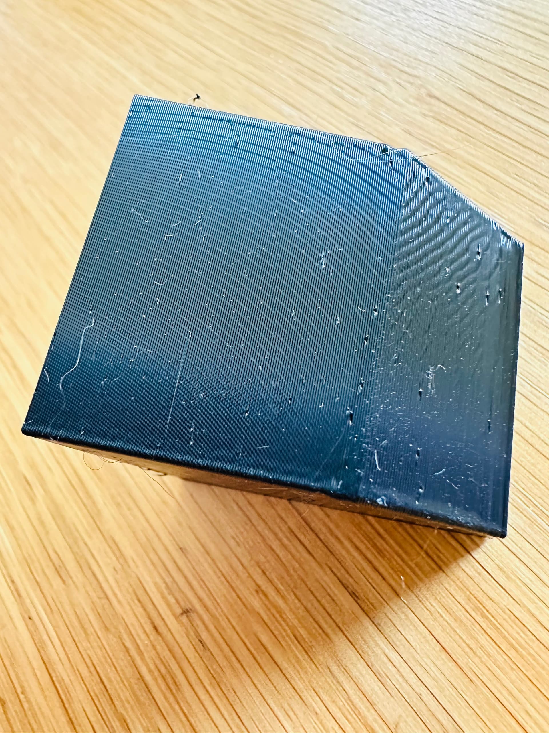

At 40mm/s it seems that these imperfections are kind of holes!?
Anyone any ideas whats going on?
From the pictures, I can’t really tell if it is random seam or bursted bubbles. Did you set it random seam?
There is stringing, so I am still thinking of wet filament.
What is the humidity of the room you are drying your filament. Drying filament effeciency depends on dry air to take away moisture. If your drybox is sealed, no air in or out, then pretty much all moisture still stay inside the drybox. Same if your room is already saturated with moisture.
Simon I fear you’re right! After drying it the scale showed more than before drying, and i thought the clutter on my desk must have interfered with the scale somehow… but after checking the humidity in the room (66%), I really started thinking, was it maybe really “just” moisture the hole time!?
I found the dries room, which is sadly still at 53% humidity… I am drying it again and checking on the weight until it loses some significant amount. How much water can 1kg petg hold? ChatGPT claims 0.2-0.5%

That really looks like wet filament to me.
If your environment is humid - and you’re leaving the spool out in the open environment while printing - it’s going to absorb water.
Are you printing from your drier?
agreed.
the zits + stringing combo really screams wet
if its been dried its possible the filament was just already bad due to prolonged moisture exposure and no amount of drying will fix it.
I have seen this - filament that no matter how much I dried it for how long I dried it - would just never print right.
That said it was generally cheap no-name PETG, and not a name-brand.
Yeah the water knocks something out of the filament; I forget what but it chemically alters it.
It’s why you’re not supposed to have too many spools of filament going at the same time but yknow. Kinda hard to resist. :')
So i dried it for over 24 hours and the dryer claimed the humidity inside was 12%. it just lost close to 1g of water in the process aaaaannnnnd prints the same ;(
So the more i think about it its sounds like its damaged irreversible. Its that something i could confront the reseller with or do they don’t care? anyone any experience with that? I sill will try the suggested settings above but i am not really hopeful at this point! Having said that i am very grateful for all of you taking the time to share this with me… I was really disappointed and as still beeing new to all of this, felt like its all my fault. So thank you everyone.
