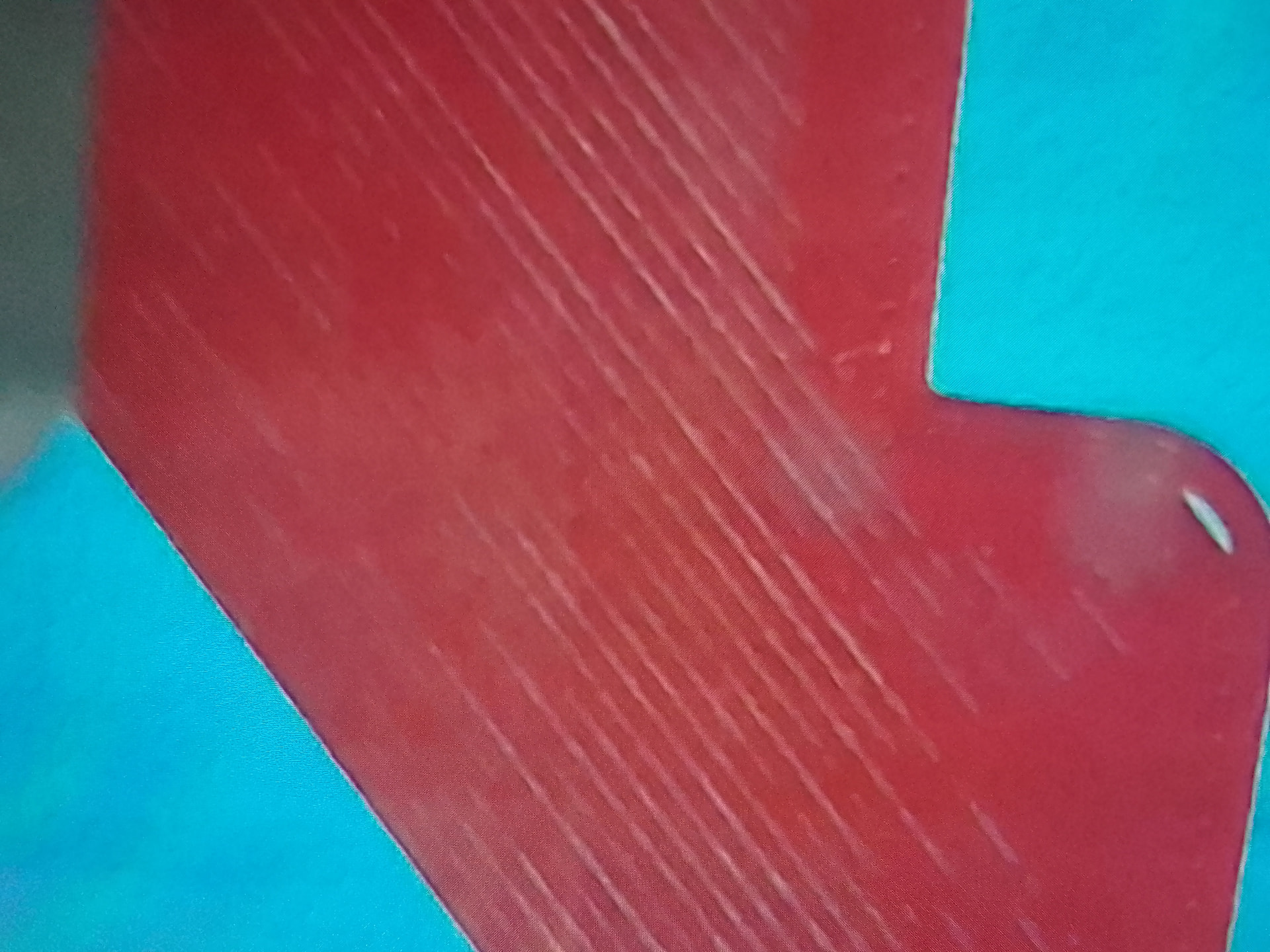

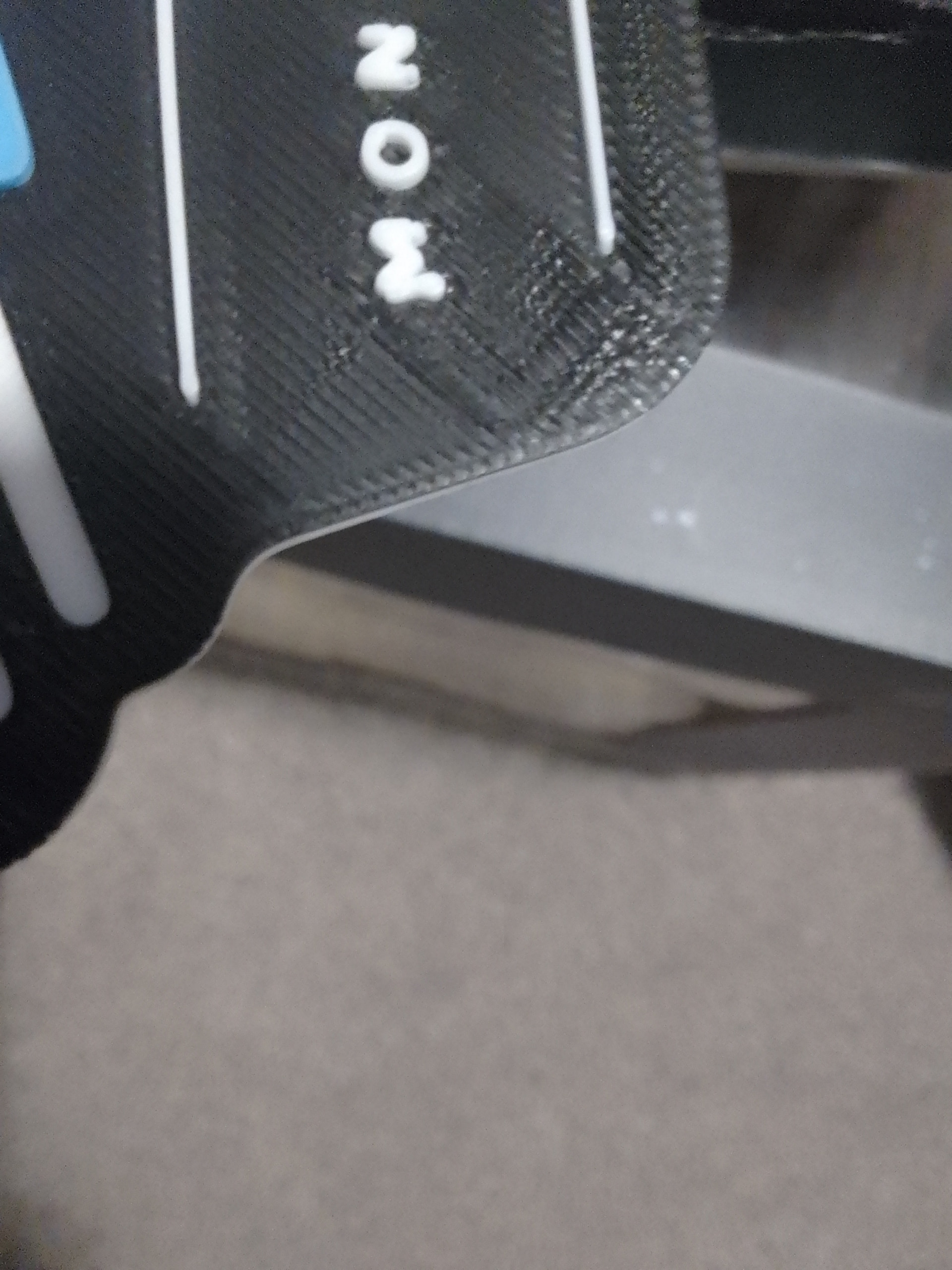

Not so good prints anymore
Hi, I’ve had my p2s and AMS for 8 months with great results. Know the prints are getting worse. I hav3 put a new nozzle in made sure the bed is clean and even factory reset it’s got a bit better but still not great. Any help would be appreciated thanks.

Whenever I see someone mention things worked ok but prints are getting progressively worse, it’s a strong indication that they may be seeing moisture issues. That was exactly how water issues manifested for me. I got my printer and things were great until seasons changed and humidity increased. Then prints started showing minor water issues that were getting worse and worse to become major water issues. The only way I was able to fix it was by drying my filament properly.
Bingo! Agree 100%…the image looks exactly like moisture in the filament.
