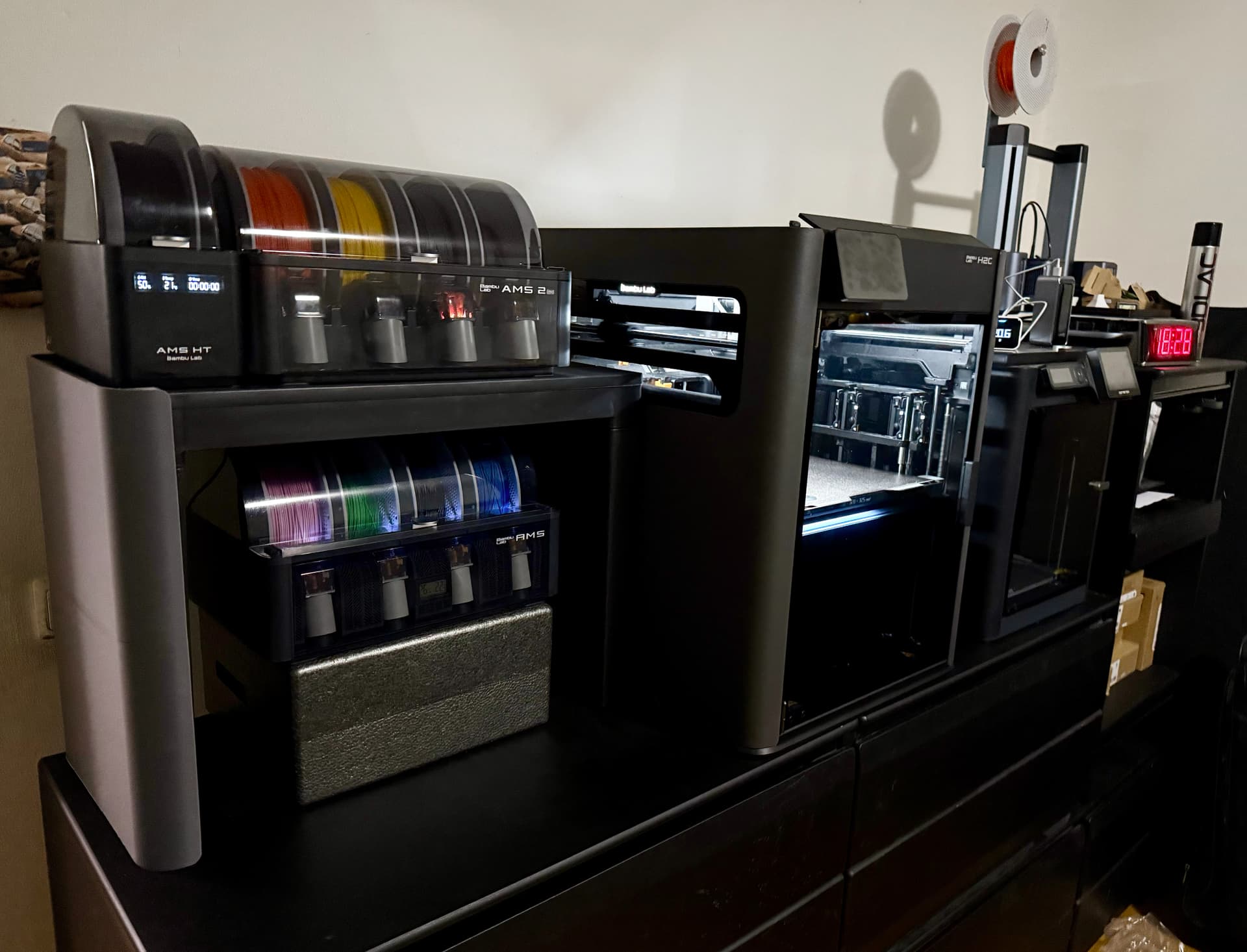

Not sure if this is ok but sharing ams2+ht stacker for h2c to keep tubes short
Probably not best design but here is a picture of my quick solution and a youtube link to see how it works. Far from perfect and need to redo some part but maybe useful for someone to get a idea.

That looks amazing. Great job man. I thought you cut a printer in half, for a second
Well its work in progress but didn’t think about the but in half design idea but guess you have a point. But wanted some space in front since you allways want to put something down. It’s about 35cm deep. Guess it looks ok just very basic compared to some of the amazing moving/flipping/rotating designs on makerworld but these would result in longer ptfe tubes i feel.
This looks great! You nailed the design language of the machine.
That seriously looks awesome! Kudos!
Great design and functionality. Hope to learn more on how you did this.

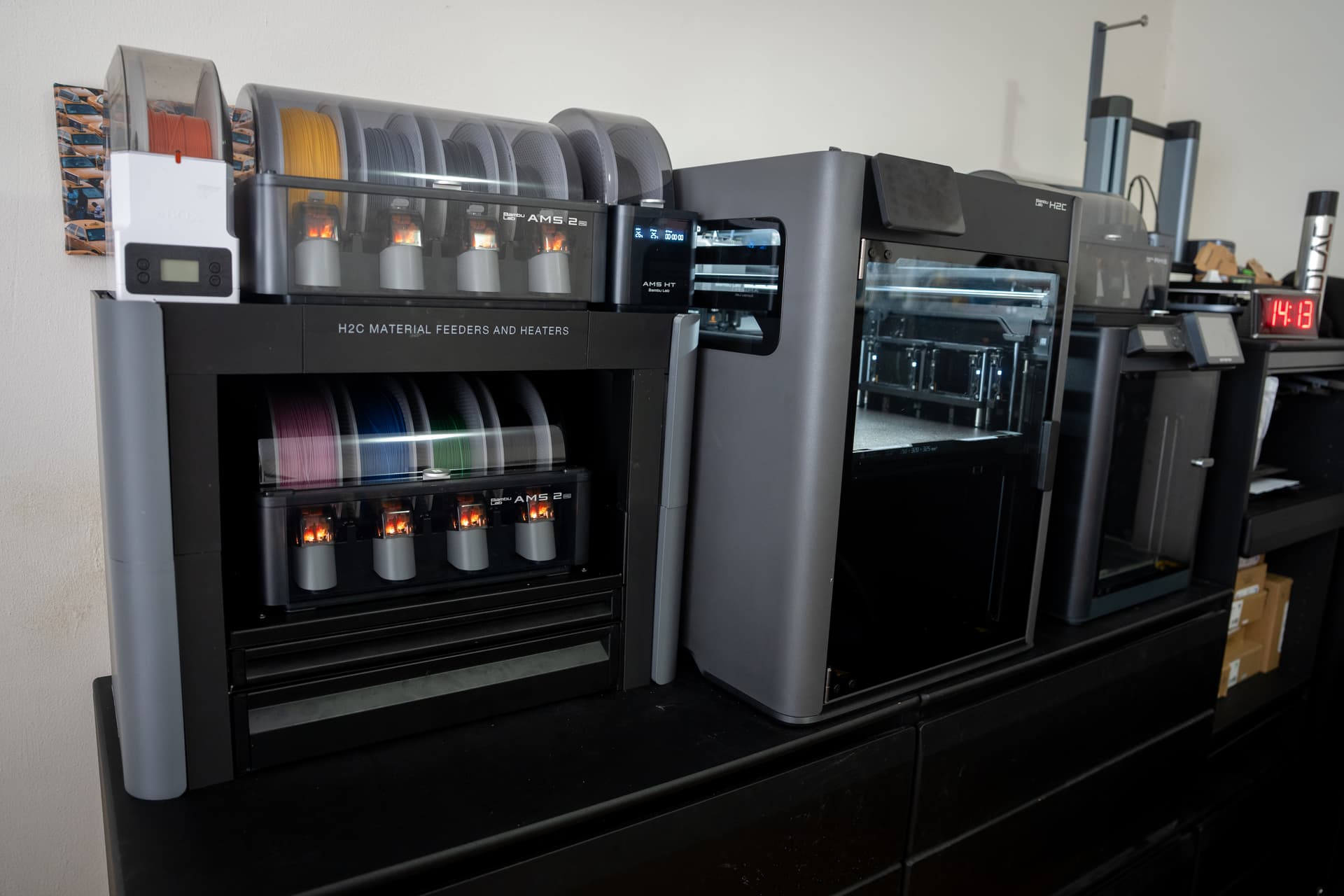

Sure let me share some pics, the reason why i don’t want to put it on say makerworld is that it’s more a 'take what you have and add things. So here is what i did i got a garden chair thingie that was 18 euro and could handle 200lbs since i wanted it to be stable given its next to printers that like to shake about.
The well put part of it off and 3d printed some U shapes that slide in to make it stable again. Tested with some cheap kitchen slides but that would tip over.
Added the sides to make it look like the h2c
got 3 19" server rack parts (i can share brand i wanted) 1 slide, 1U drawer and 2U drawer. i just glued then together a little and the normal attack points (in the front) created the side parts to hold them in place and give the normal screw rails. Also added the top cover with the for now name/title.
lastly added the 2 drawers, added sides and put some black cloth on the back feed all the cables in/tubes out.
will shift things over when the other HT units come in (backordered) and move the h2c a little (one ptfe is too short need to make a new one once i have all in place). And started on the gridfinity boxes for the nozzles/tools etc etc
Hope this helps its all very basic since most of the trust is in the cheap bench and the 19" rack parts that are rock stable and means you don’t need to print 4kg of stuff.

You are welcome. Using 19" rack parts is very cost effective and you know its build sturdy simply because in a datacenter it has to be able to take some load and abuse.

Indeed my plan was not really to make a 19" rack it just sort of made sense to use these parts so i am looking forward to your solution. Maybe if i would do it again i would have fully gone that route and still would try to add the sides to make it look the same since i wanted the more matched look.

I guess you can use many parts to build it but keep in mind in my example the bottom one is on a slide that can come out 100% so you can open the ams on the lower rack thats a important part of why i went the 19" rack slider and 2 drawers.
