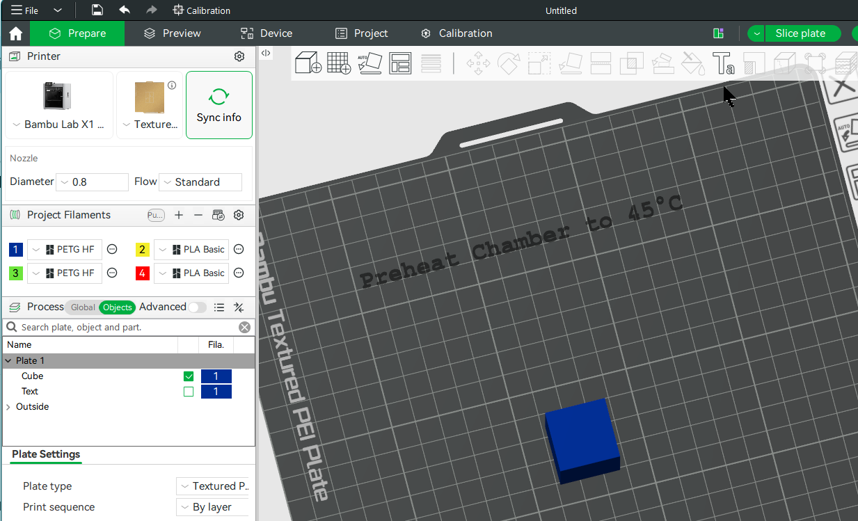

The Text tool can be used to place text on the plate, or on a particular object. Make it non-printing by clearing the check box in the Objects menu.
