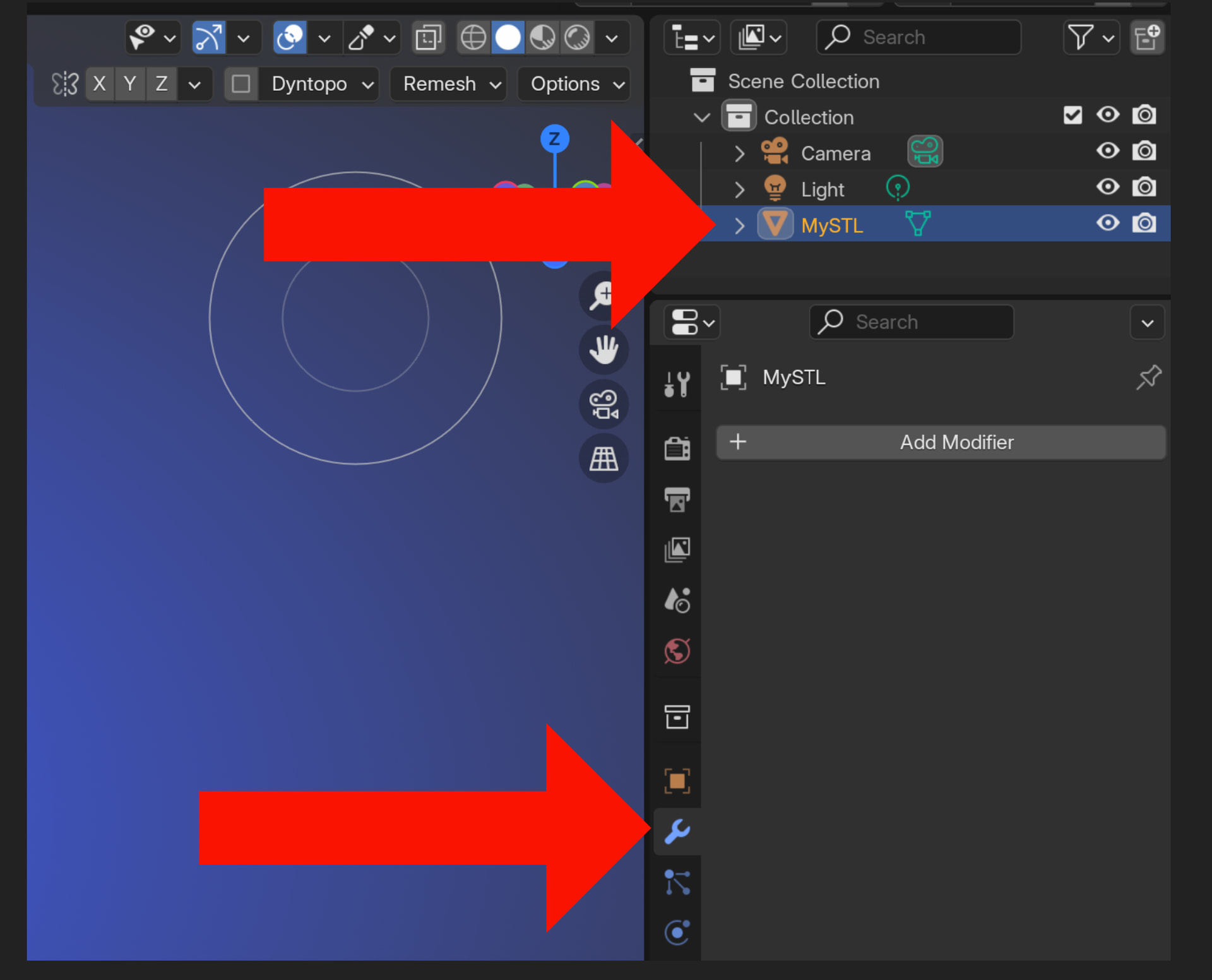

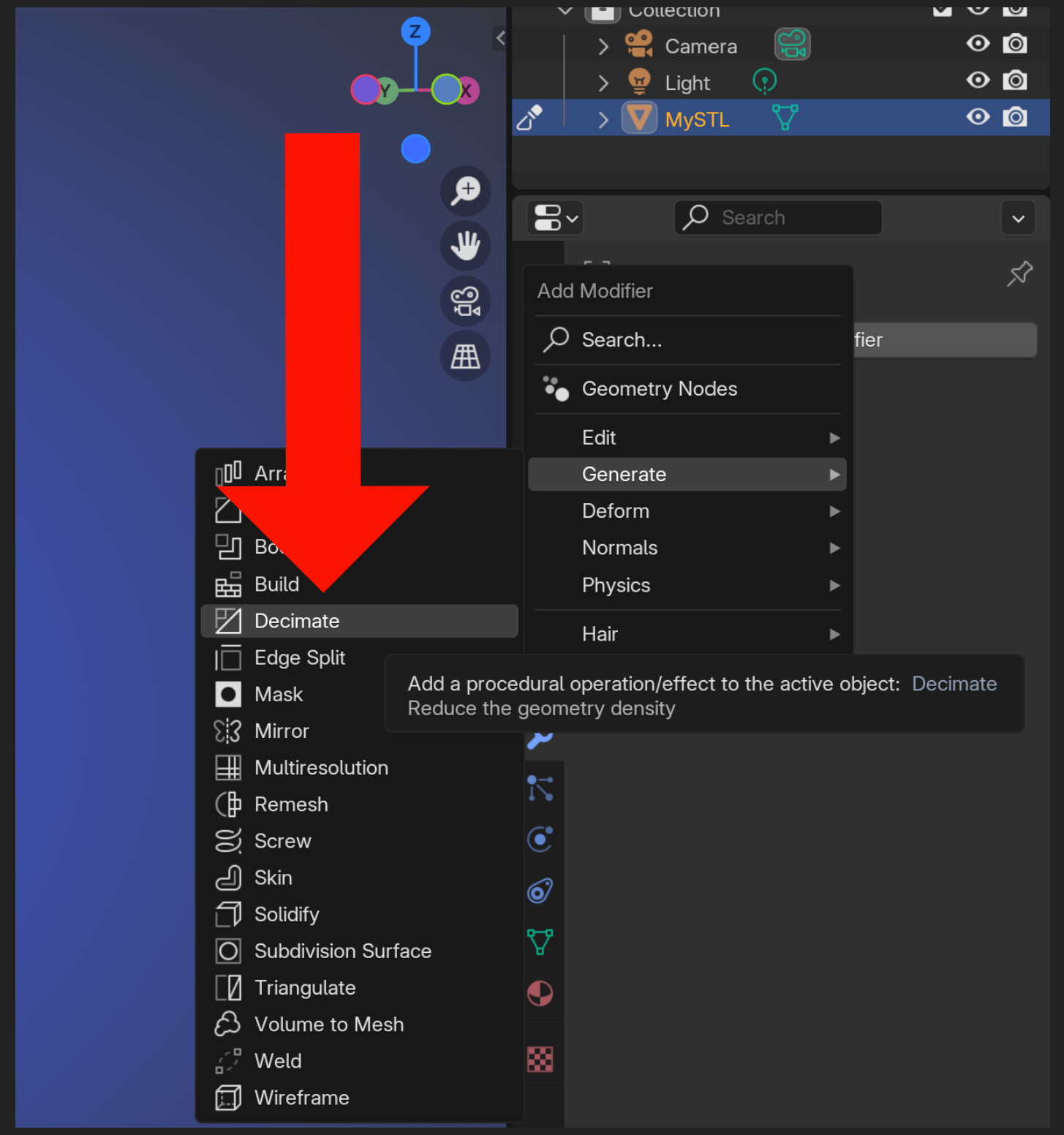

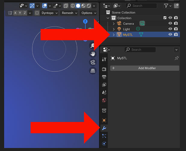

Here’s a workaround: Use Blender - portable version, if necessary - you only need one feature, and I’ll show you it:

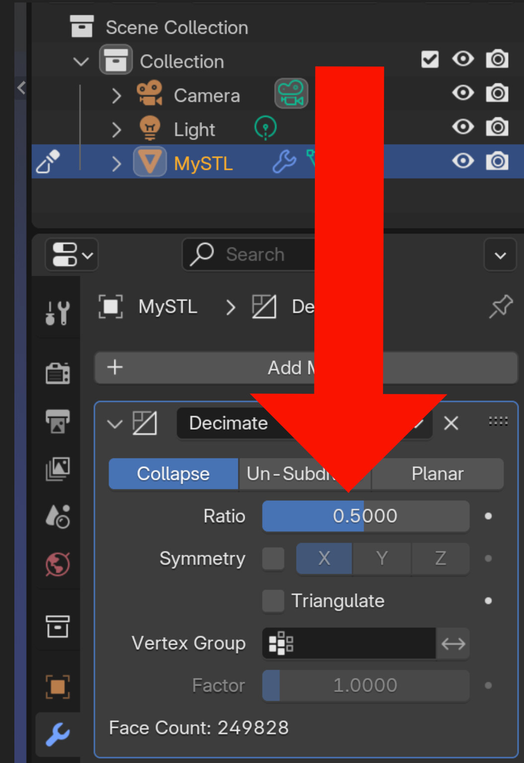

0.5 = 50% “simplification”

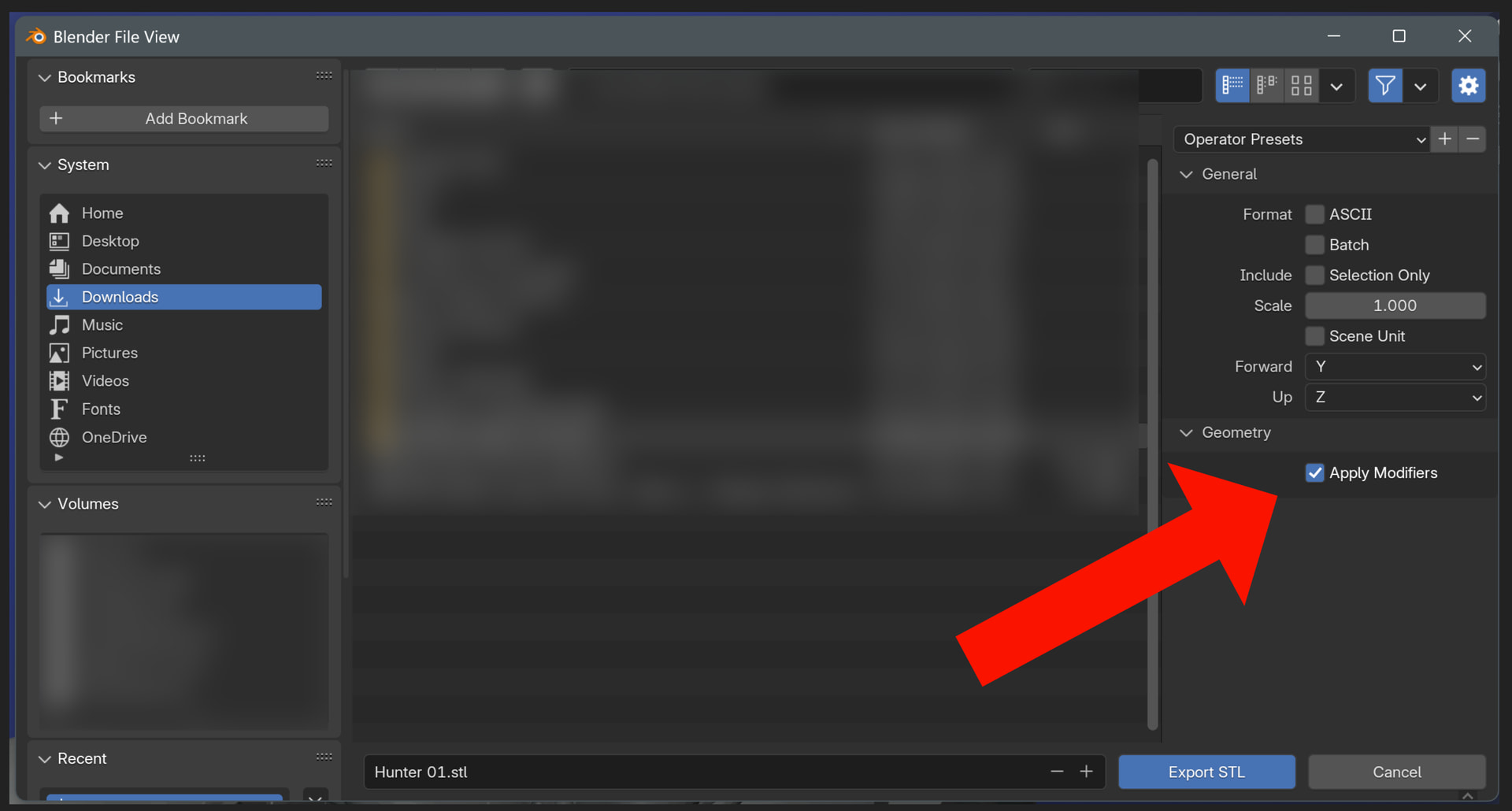

Export as stl
