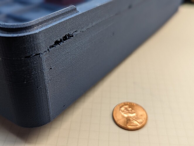

I’ve gone through 4 spools of Bambu PETG-CF so far with .4 and .6 hardened steel hotends. The .4 is much more problematic than the .6. I can get good prints most of the time, but I ALWAYS have a lot of buildup on the nozzle. Yesterday I tried a print with the .6 I’ve been using for a few weeks and couldn’t make it past the first layer without failure. I’ve been exclusively printing the same item (a large battery enclosure) with this material. Put a brand new .6 on and still had buildup, but no failure on a ~10 hour print. I’m thinking these nozzles are either getting really dirty or scuffed up internally due to the carbon fiber leading to issues after repeated use. Going to try thoroughly cleaning the original .6 nozzle up as best I can to see if it can make it through another print with it.

I posted this in another thread but in your printer config set the z offset to 0.05 and blobbing goes away completely. I also agree that slowing down the infill helps with whisps and edges of infill not attaching to walls.

  2. Using Bambu Lab PETG-CF prior to 01.07.02.00, I was getting stringing and under extrusions. Using Tinmorry PETG-CG I was getting perfect prints but still the build up on the nozzle. Post 01.07.02.00 with the default settings the Bambu Lab PETG-CF was getting less stringing but still under extrusions(gaps in walls). Tinmorry PETG-CF would no longer adhear to the textured PEI plate. I found that making two changes solves everything but the buildup around the nozzle, however the buildup stays out of the way and has not caused an issue. Is there a setting for how often the printer will do a wipe while printing? I’m also going to try @wiremeup suggestion for the z offset. I increased the nozzle temp from 255C to 260C and the bed temp for the first layers from 70C to 75C. Bambu Lab PETG-CF has some very minor stringing now but no under extrusions, and the Tinmorry PETG-CF prints absolutely perfect.

Going to share my experience in case it helps anyone. I use the standard 0.4mm hardened steel nozzle and the default Bambu PETG-CF profile with a textured PEI plate. The only change I made was bump up the bed temp from 70 to 75, and nozzle temp from 255 to 260. Everything else is default including the fan speed.
Initially, i changed the fan speed to 40% min/30sec and 90% max/6s but found the nozzle pulling the previous layer off the print on the odd occasion as it was laying down new filament, presumably due to poor layer adhesion. This also had the effect of gooping the nozzle with filament. I quickly changed back to the default fan profile which worked much better.
I also tried changing the z-offset from -0.04 to 0.03 as some suggested but found that I had bed adhesion issues. Changed that back to stock immediately.
The nozzle temp made the biggest difference. I found running it hotter meant the filament didnt have a chance to cool fast enough to start gooping on the nozzle. I’ve gone through 2x 1kg rolls printing large parts up to 10 hours and have no filament collecting on the nozzle and it prints wonderfully without any artifacts or stringing.
