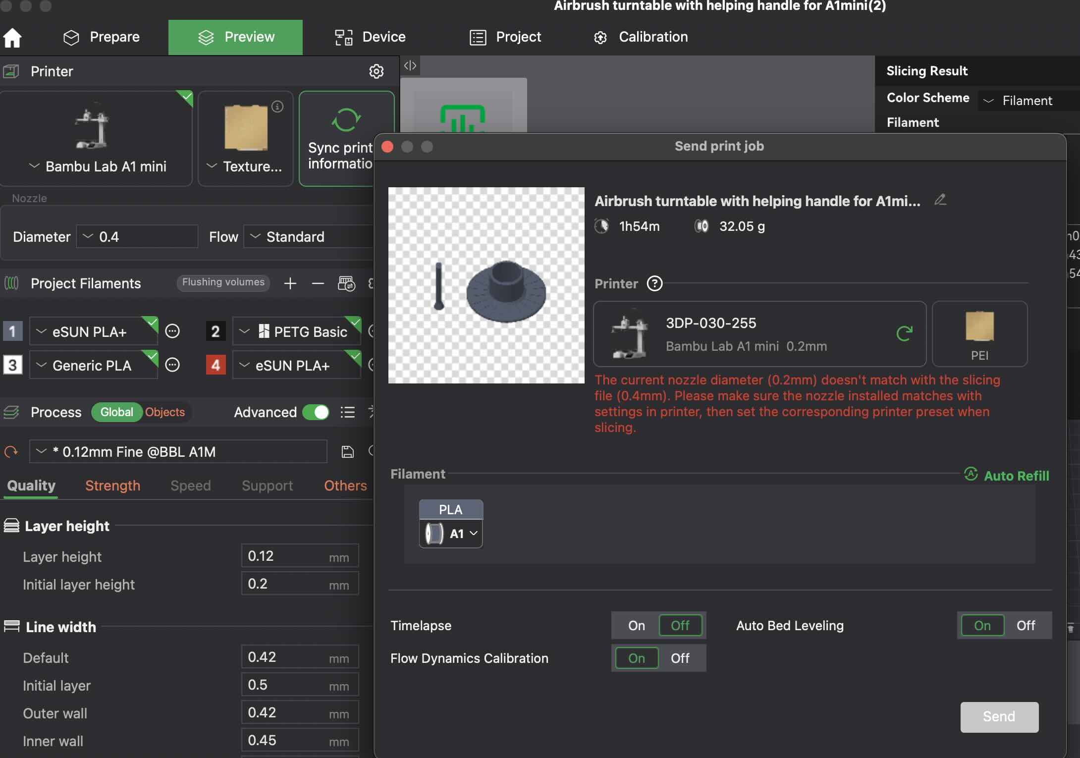

Hi all,
When adjusting my print in Bambu slicer, I set the printer nozzle diameter to 0.4 (which matches the installed nozzle), but when I try to print I get an error saying 'current nozzle does not match slicing file;. Any ideas of cause on this?
if you haven’t yet resolved, it probably has to do with the fact that you have to select the correct nozzle from the physical display on the a1 mini
option → maintenance → nozzle → 0.4 ( stainless or hardened )
I did think that setting in the SW via Bambu slicer would work - but you’re right, needed to do it on the printer itself.
it used to work, i always did it via Bambu Slicer, but in the last update they removed that option
