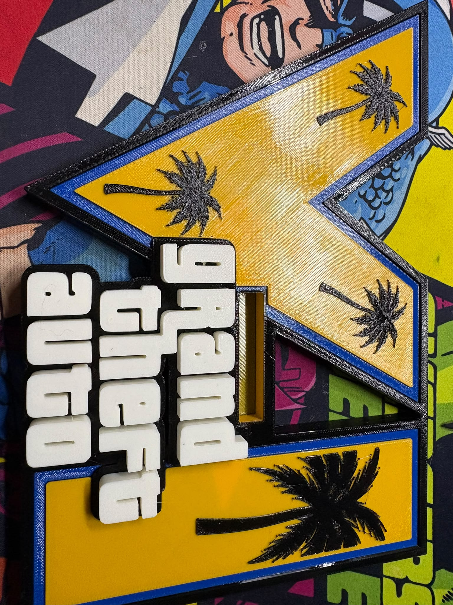

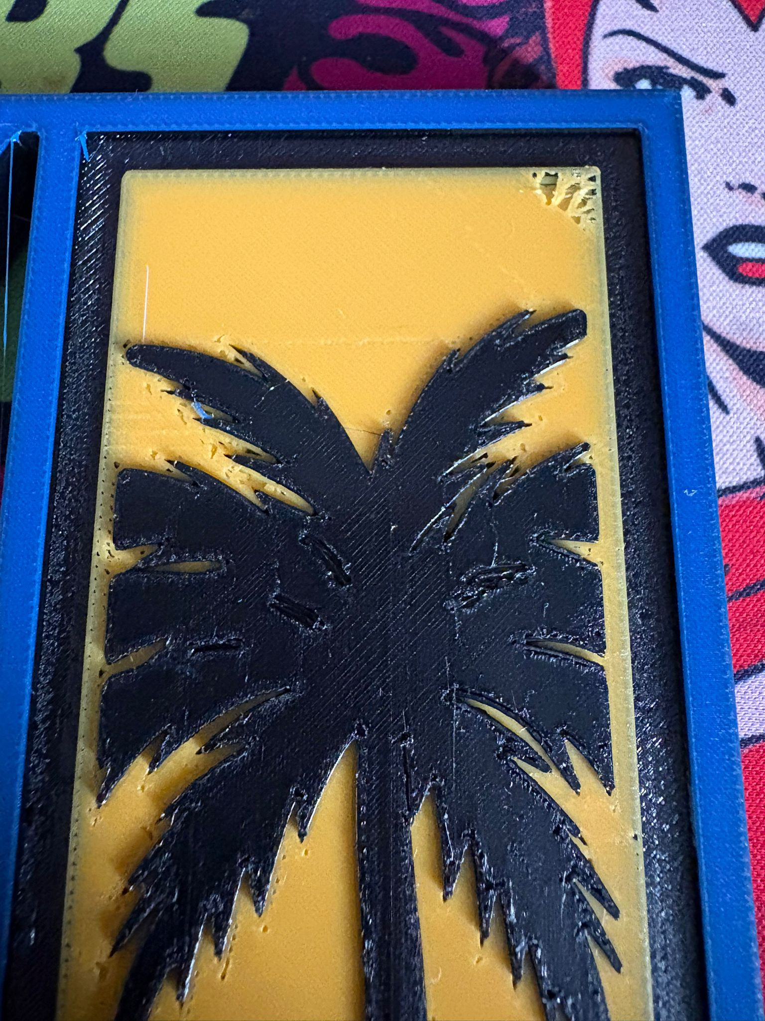

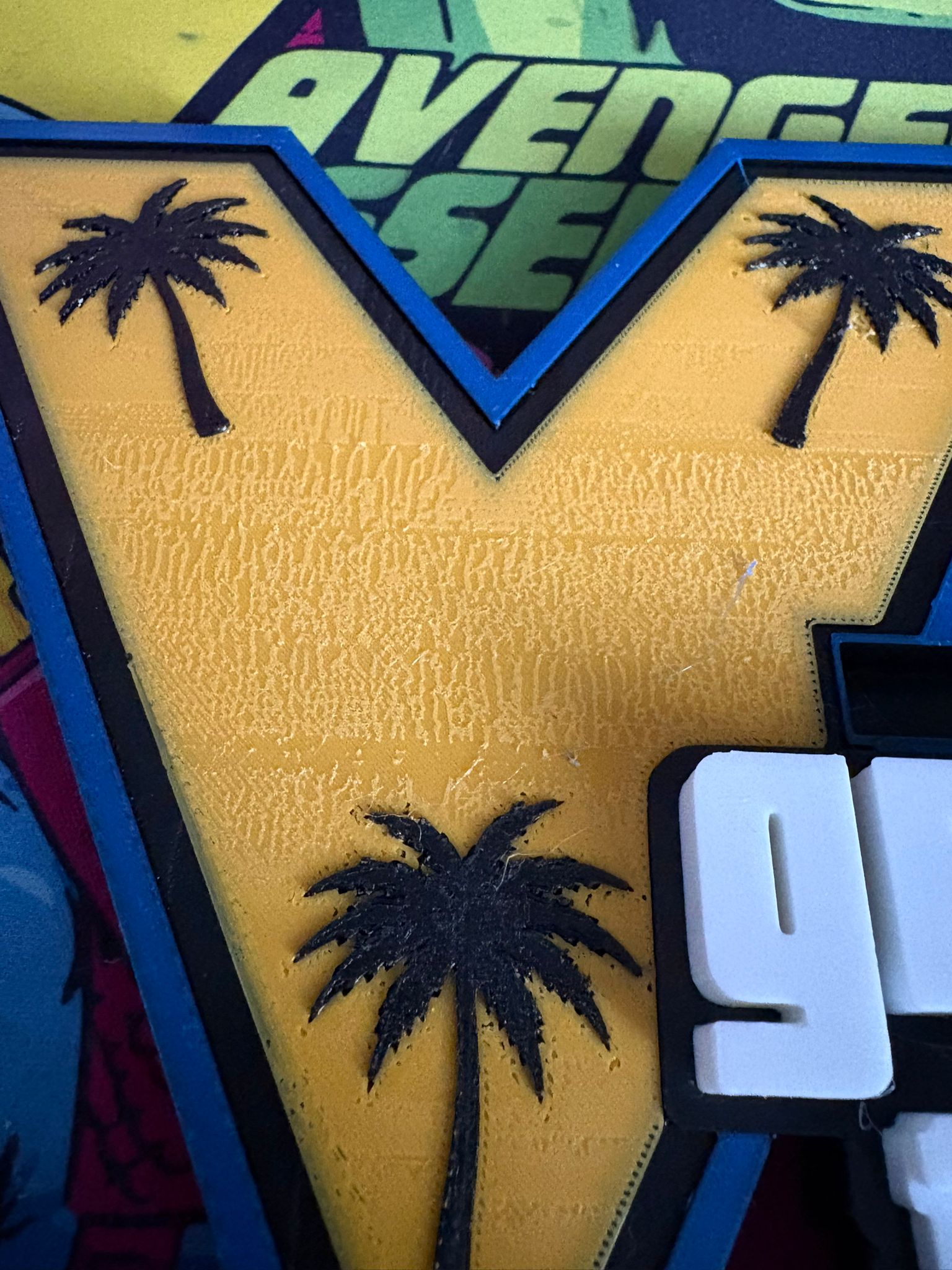

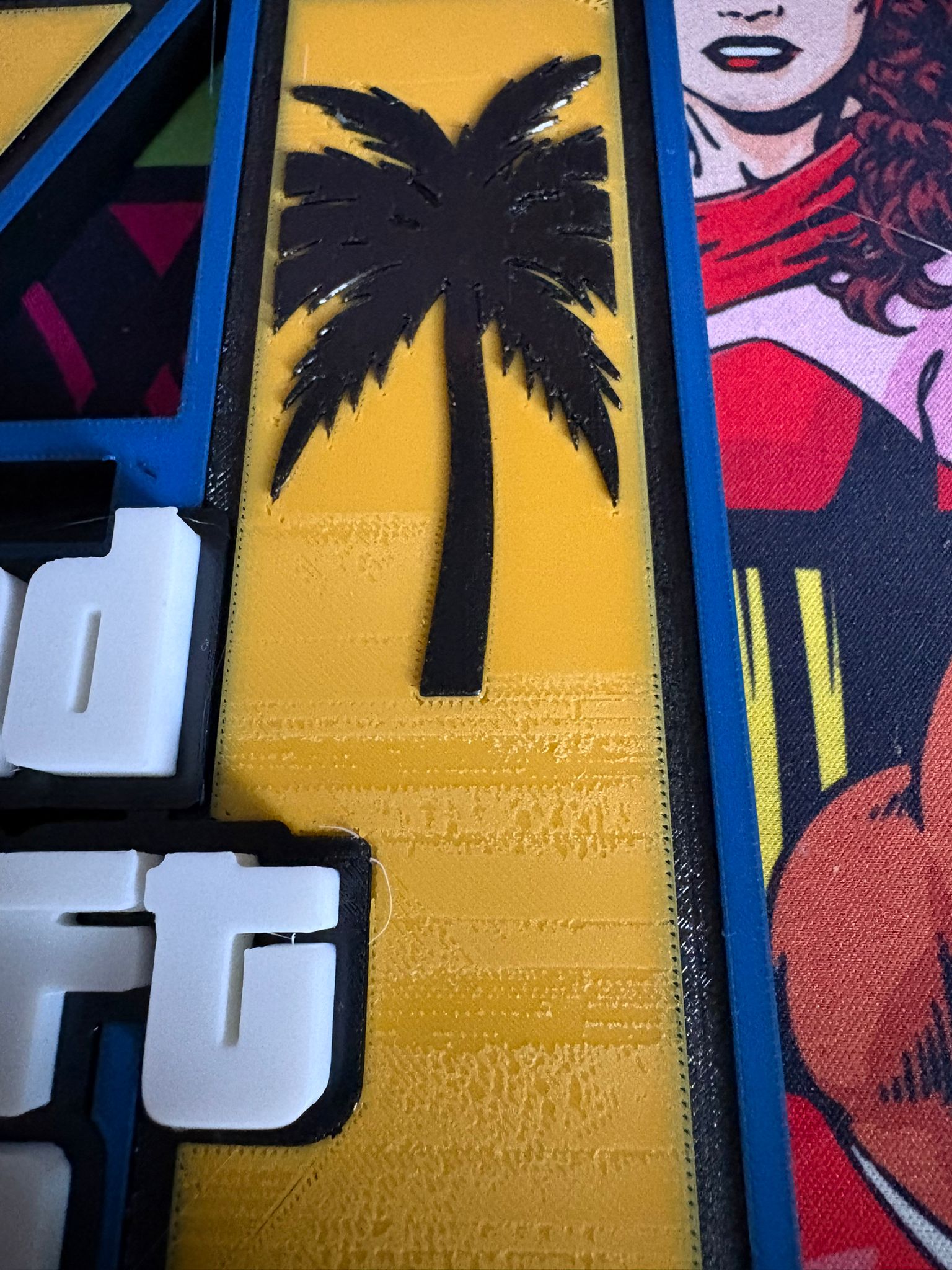

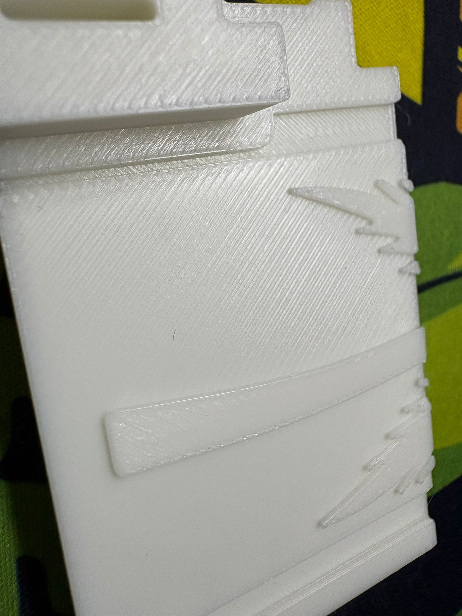

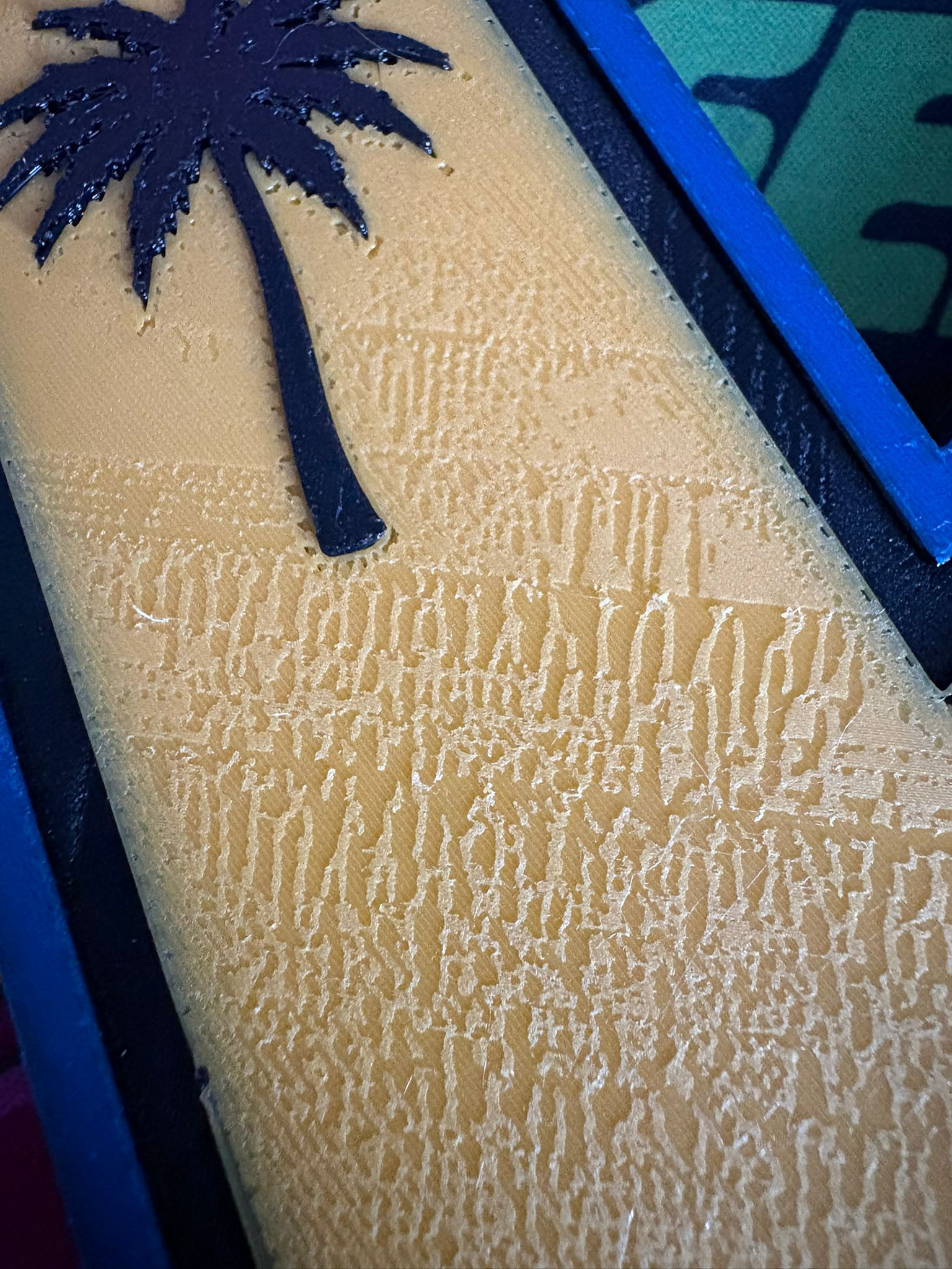

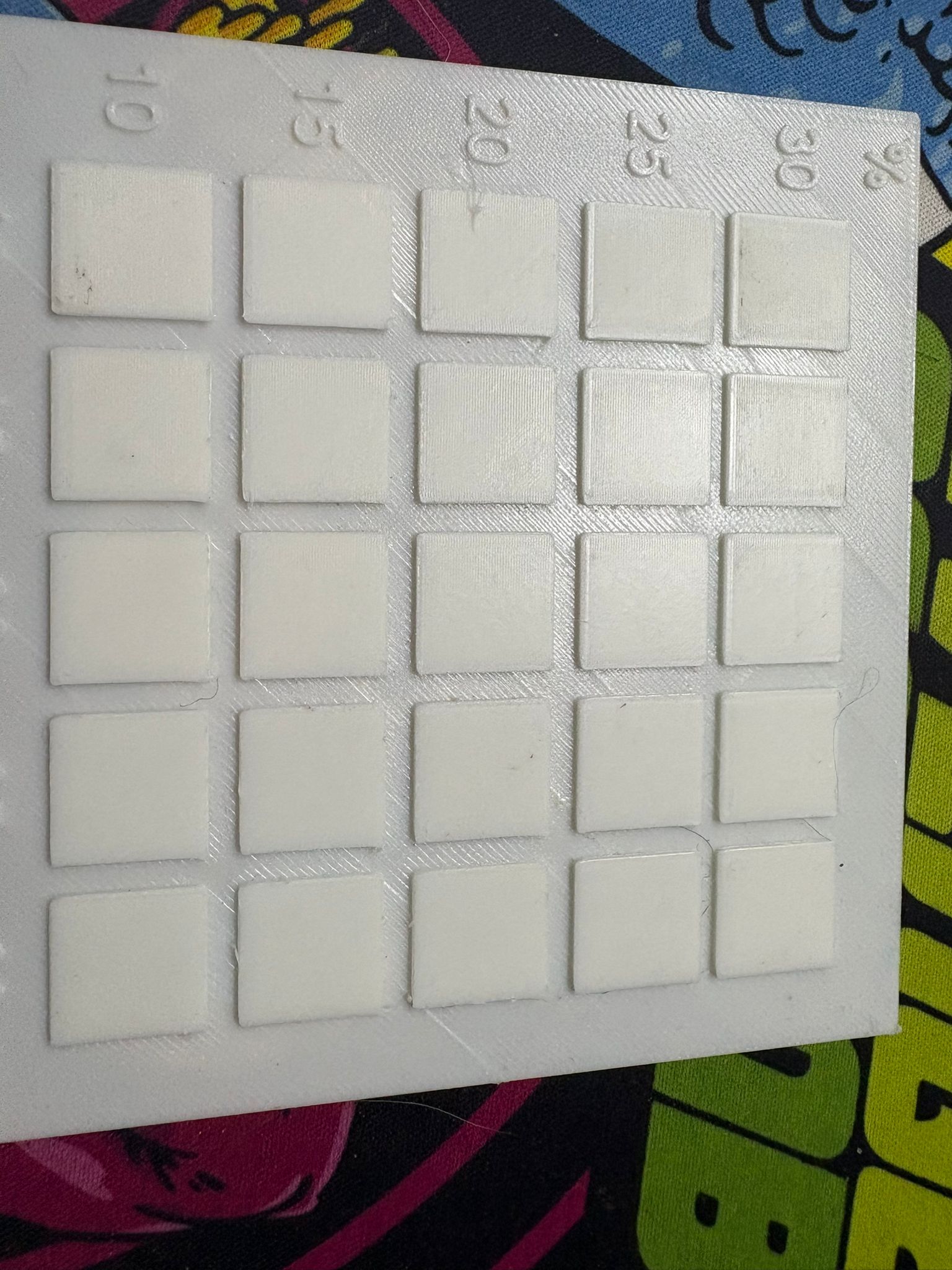

Hi all, total newbie to 3d printing. I am slowly getting to grips with the basics but i tried this large print for my son and the first attempt turned out ok but all the layer lines were visible and you could litteraly feel them if you ran your finger nail across them. I did a little research and added some ironing settings and set it printing agin over night and woke up to this. It looks like the nozzle has been dragging over the print. This one looks worse than the first one. I just want to get a smooth surface of the print. I am using the Bambu A1 combo with a 0.4 nozzle, kingroon PETG filament and a smooth plate. The first image is the first attempt without ironing and the rest are the second attempt. Any help and advice would be greatly appreciated.
I tried Monotonic Line + 30 mm/s + 0.45 mm top surface line width + ironing OFF on a small test section and it looks a bit better but the lines are still clearly visible.
search, download and print from MW the ironing test. there are few
