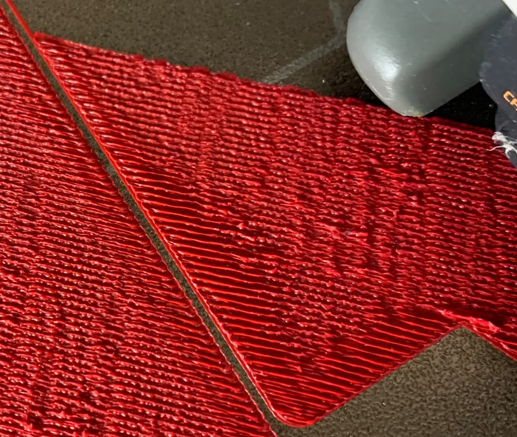

I’m having a problem where, across all filaments and print settings tried, the nozzle is rubbing against the build plate when printing the first layer. It causes ridges in the first layer, and horrible grinding noises when printing the next few layers. It also causes excessive elephant’s foot, and excessively strong bed adhesion with PETG, and continual false “nozzle covered with filament” errors. It coincides with having to generally raise nozzle temperatures 5-10°. All these symptoms started after I disassembled and reassembled the toolhead (without replacing or changing any parts), which seems like a strong hint that the problem is mechanical in nature.
With this information, is there any chance of pinpointing the problem? Like, is there a toolhead reassembly error that would cause the bed levelling to consistently detect too low at every point?

Typical appearance of 1st layer (Bambu PLA Basic shown)

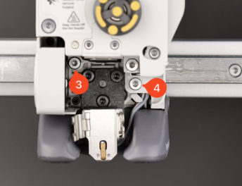

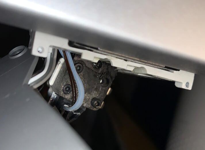

The heating element and thermistor are located behind the hotend which is in one plastic unit held on by 3 screws. Behind that are some smaller screws. This is a common fault with the A1. You can try tighten the smaller screws as this sometimes resolves the bad first layer issue. I’ve had to replace that whole unit on 2 of my A1’s

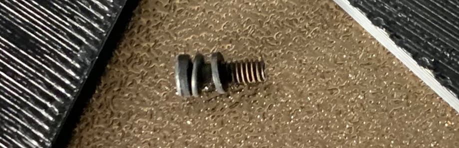

Thanks for the explanation, GuyH77. On my unit I overtorqued one of those screws and stripped the plastic, and that’s probably the root cause if I had to guess. Machine screws driven into plastic are set up to fail and require extreme care.

I feel you pain on the stripped screw holes in plastic. The parts are not very expensive so I replaced those that were defective. The nozzle no longer drags on the plate.

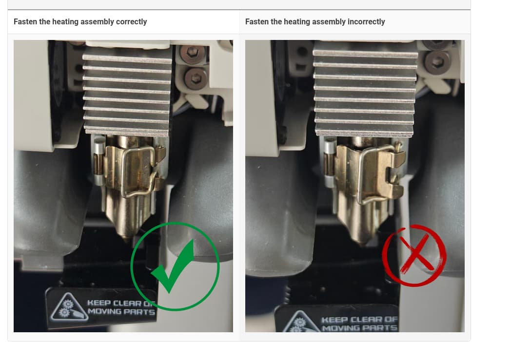

i’ve already said this before in another thread but make sure your heating assembly (the remove-y nozzle-y portion with the heatsink) is installed correctly and re-run the calibration if you do find you latched it on incorrectly.
Loose screws anywhere on that head assembly will cause issues. But, be careful, you don’t over tighten them, or they will strip out. When the printer checks for bed leveling and something is even a tiny bit loose, the z axis comes down closer to the bed than if everything was snug and did not move. When the printer comes around to print, it uses that reference when it checked at bed leveling and drags the nozzle. When you install the nozzle, make sure the whole area is clean, especially where the nozzle mates with the heater. Before you fold the clamp over the nozzle, push the nozzle toward the heater and slide it up to be sure it is seated and snugged against the stops, then pull the clamp over the nozzle.
