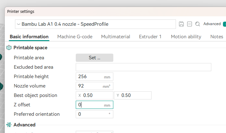

You can alter Z offset in the machine settings.
This translates roughly to “autocalibrate does whatever it wants to do, then apply this modifier to that result”
In your case, I would set it to 0.10 [positive] and see, to pull it back from an extreme too-close-to-bed. This is for troubleshooting, leaving this value in here permanently is perhaps covering up other issues, but thats for bambu support to decide.
