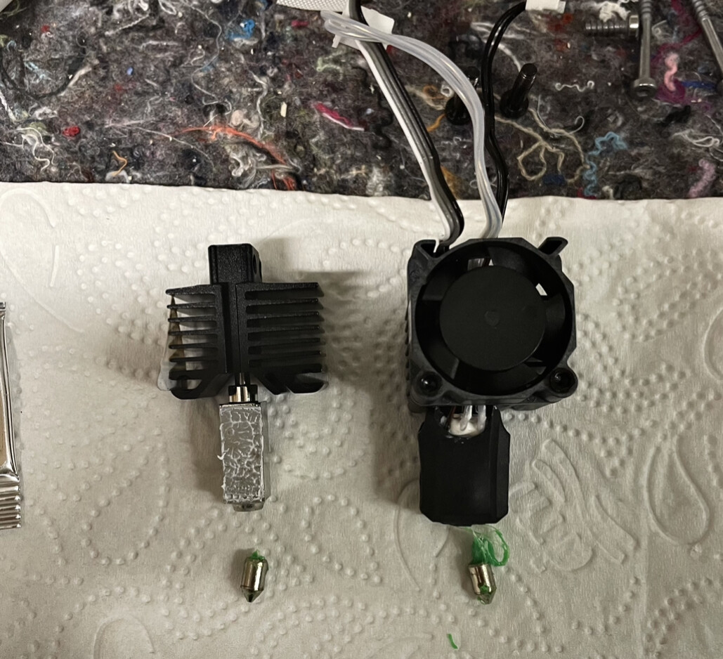

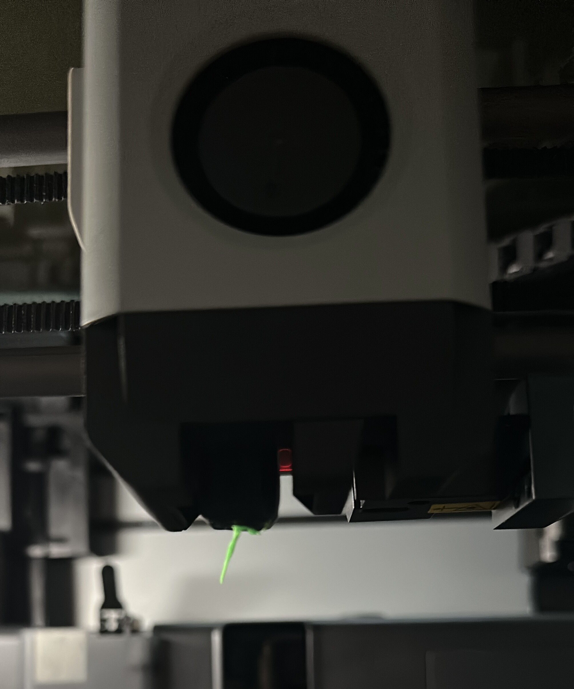

Hi,
I’m a newbie to the x1c and to the forum.
I had an issue during my 2nd print that the tip off the nozzle fell off.
I should note that I left the printed material of stripes on the cooling plate.
Please, see the pics for better understanding.
The cooling plate has now engravings.
My question is if I can fix the nozzle? Or what should I do?
None of this is good. That nozzel is now broken, you’ll be replacing it.
I’m not even sure how it didn’t stop itself from gouging the bed, you need to put in a ticket.
Is that the stock nozzle? This shouldn’t happen on a stock machine.
Thanks for your response.
Yes, it is the stock nozzle (and overall system).
I’ve already put one ticket. What are potential verdicts for such a ticket?
Your printer came with a second nozzle that you can install while waiting to hear back from support.

Wrong, this is 100% manufacturing defect. Nozzle is interference fitted and if it falls out, it’s a manufacturing defect. The worst that can happen due to user error is nozzle slamming into something and tube located in between of the heater and radiator get bent.
I have to agree. The nozzle piece is pressed into the assembly during manufacturing and even a hit so hard that it bends the assembly should not make the tip come loose.
No, I followed the written steps in the manual as this was my only second print.
I got a response to my ticket and they will be sending replacements for both the nozzle part and the plate sticker.

Hi I’ve written this to another thread but I guess this here is the right one. So I experienced the same issue. I installed my new x1c yesterday, I printed the Benchy and then I try to print a spare spool, that fails. Sadly I didn’t make picture form that but at the end it looks like the pictures above. Both nozzle are damaged and both loose the tip while printing. I guess that the cleaning process at the beginning of a print causes this issue.
This is a QC issue at a minimum and more likely a design issue… These tips are press fit. In no way should the wiper, extruder pressure, etc, be able to make this to fall off. Honestly the tip should be made with lip so that the only way it is to press it out is backwards through the hot end (while still being a press fit around the diameter).
