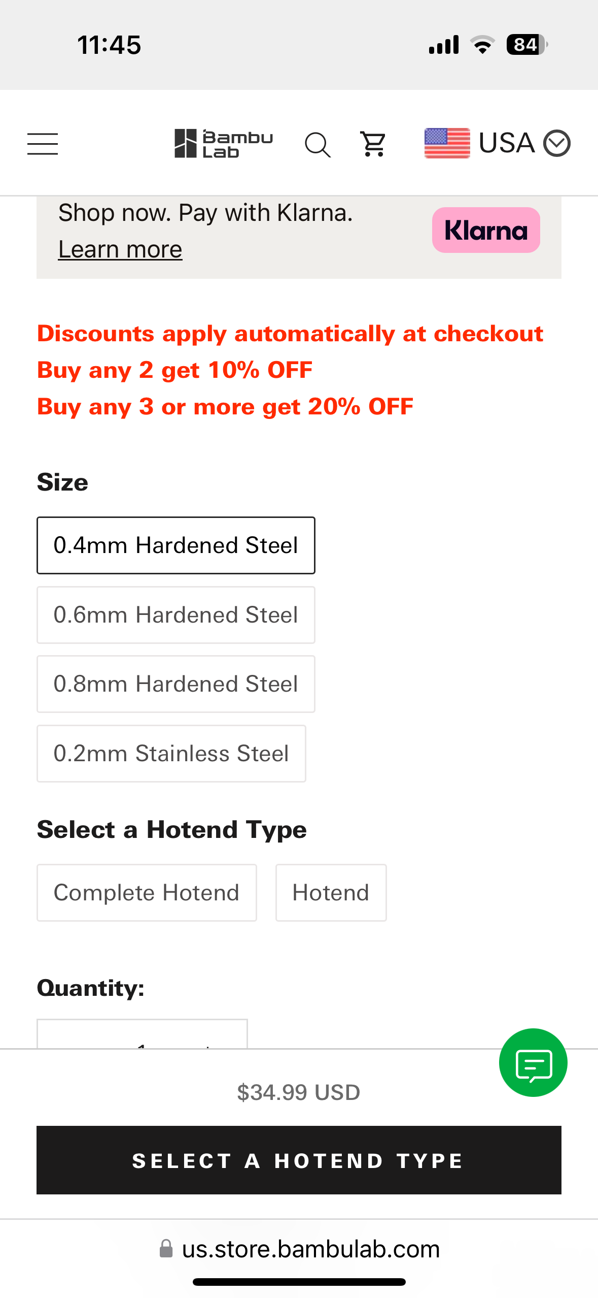

I can’t see any stainless steel 0.4mm option available in the bambulab store… are we sure the preinstalled nozzle isn’t hardened steel?

i’m just saying that they don’t sell stainless steel 0.4mm hotends for the p1s in the store. that led me to think that maybe they don’t have those and are shipping the printers with hardened steel 0.4mm hotends preinstalled.

They may be out of stock, or just selling hardened now. On the US store they do have a .2 stainless right now. The moral of the story is though a hardened steel nozzle is cheap and you really shouldn’t print abrasive filaments without them. The very abrasive filaments can actually wear down a stainless nozzle in a single spool.
