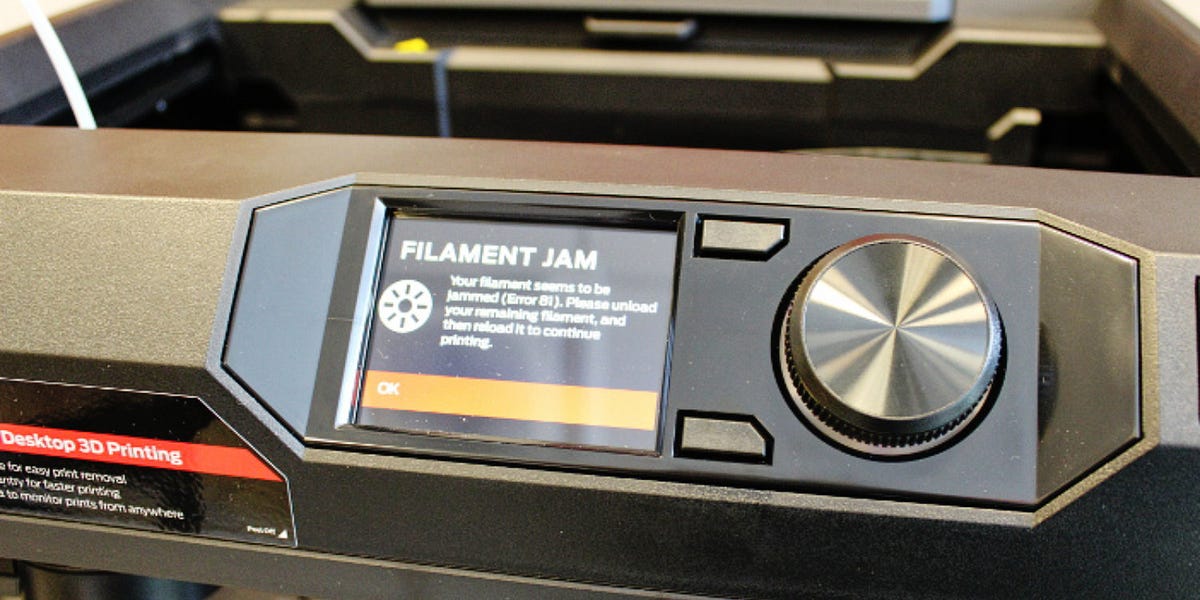

MakerBot (mentioned in this thread) is before my 3D printing time by quite a bit but this has a little bit of the history of what happened to them. (apologies if I am repeating something already posted here).
Maybe classified as a cautionary tale?
Edit: and no, it’s not directly related to the RFID issue of this thread.
