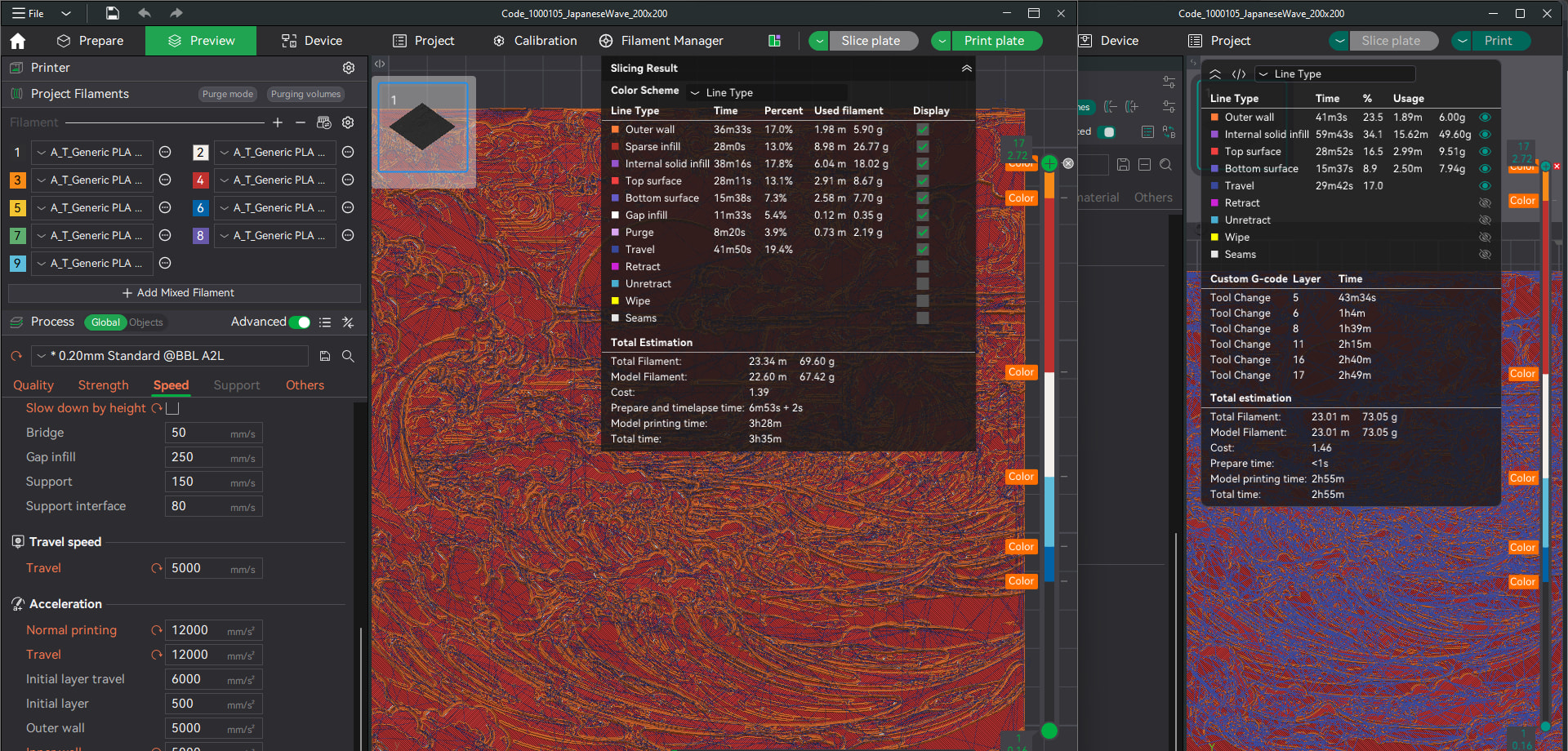

One file slice in Bambu and orca has huge print time diffrent
Hi there , my new hobby is printing Hueforges , i do have a Creality K1C and one bambu A2L.
i used to print my file on K1C with orca but now i am converting the files to BambuStudio ,however the time to print makes huge diffrence and when i see the line type i see more of it to be Travel and gapinfill , i realized that i cant cancell gapinfill which is unfortunate but why is my travel like 1.7 time the K1C ?
i did change a lot of settings but i got no luck .
i should mention that i set the speed tab parameter the same , Quality and Strength are the same too, prime tower is off , i am using Arachne , which is wierd cause sometimes makes things better but sometimes i get better result in Classic , you see the print material used in both are identical
For starters, it would be helpful to only turn on travel lines in your previews so you can see if the travel distances look approximately the same.
Big picture - there’s a ~40 minute time difference between the two slice jobs, travel is accounting for only ~25% of that difference. It makes more sense to identify and address the source of the other ~75%, and depending on the solution the travel time delta may go away.
It looks like the combined infill time of the Bambu Studio slice accounts for almost 50% of the time difference, that may be the better issue to attack first.

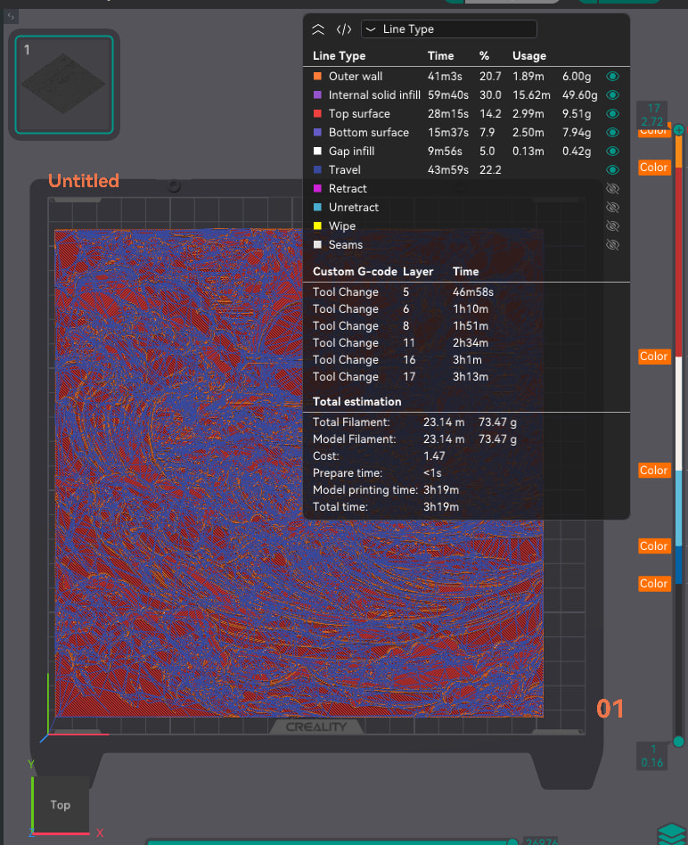

Now when i apply gap fill to “everywhere” in orca the time changes badly :
Orca after turning on gap infill :
So it seems to be the Gapinfill which is destroying my timing ! is there any way to get rid of it ? i never had any problems with gapinfill off in orca

Orca only uses Solid Infill but bambu creates both Solid and Spare infill , i turned on Infill Combination and even used the same Pattern , hoping i could get one of them (Which i would like to know if is possible please)
the infill (solid/spare) combined is 8 minutes more than the orca ( :smiling_face_with_tear: )
the top/bottom surface layer is Same as what orca makes ( :neutral_face: )
the Wall is consuming less time than Orca ( :smiley: )
Gapinfill Dose not exists in Orca which is +11 minutes in bambu
and travel is 13 minutes more
