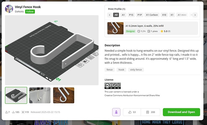

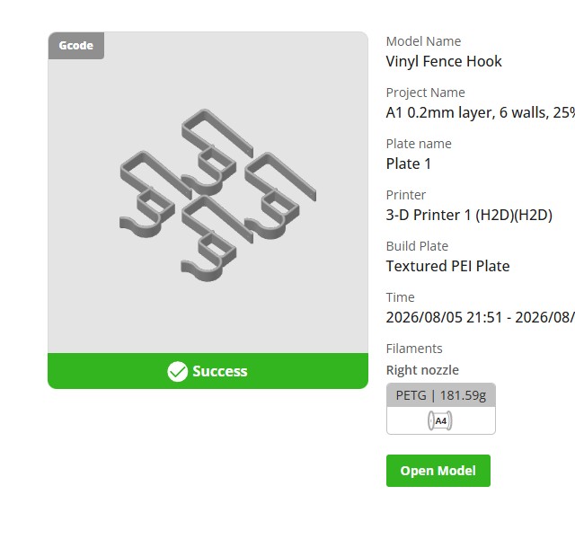

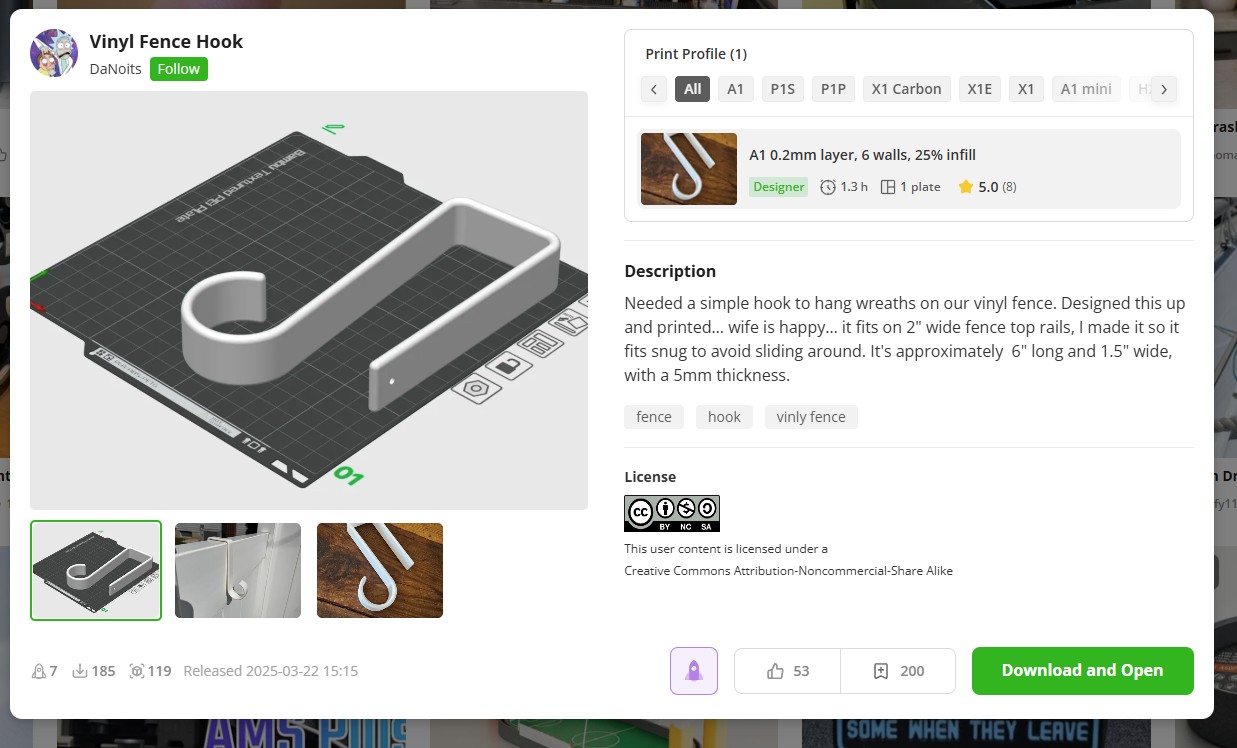

I have noticed in Bambu Studio (2.7.2.62 and earlier) that if I go to the print history and click on the icon for a print I want to either print again or redesign, that the thumbnail is accurate but the file it opens is an earlier version.
Here is the work flow:
Print a design. Like it and save the file.
Open file at a later time and modify it. Print it and save under the new name.
Go to print history and both thumbnails are correct but the file name is only the older version.
Seems like its the fact that it wasnt saved before it was printed but it gets stranger. If I go to my office in another location and open the print history on that printer, It shows the two different thimh nails. Both have the version 1 file name but when I open the version two print (Using open model button) is downloads and opens the version 1. This office computer has no access to either saved file. Only whats in the printer.
