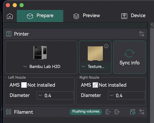

Orca nightly builds now have H2S/H2D support, you need to be on LAN + developer mode to make it work.
I ran into that one also.
Would be good to dig into that one.
Is it possible to import Bambu Studio filament profiles into Orca?
Yes for sure. Just make a 3mf in BS with every filament profile you want to import in the project, open it in Orca, then save the profiles.
Thanks!
I was considering to copy the filament profiles from the system folders over to Orca, but that might be a bit too drastic.
