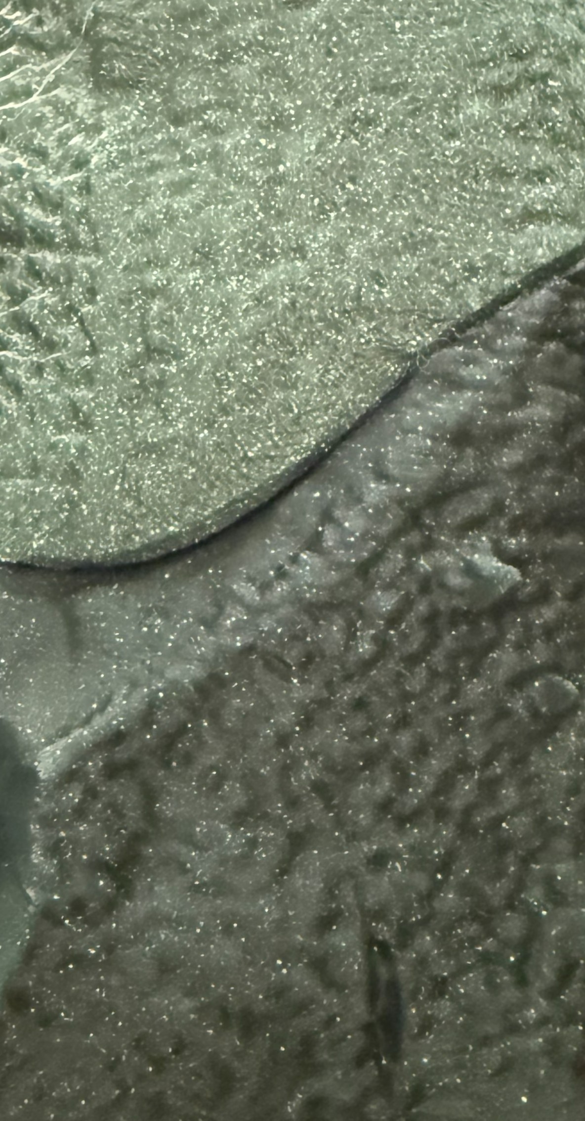

Hi! I searched the forum but couldn’t find an answer. I’m trying to print several parts of the same object with Bambu Sparkle or Bambu metal filaments, but the shine differs, causing noticeable colour changes. I tried adjusting the seam and position on the plate, but it didn’t help.
IMG_1428
Any guess?
Thank you!!

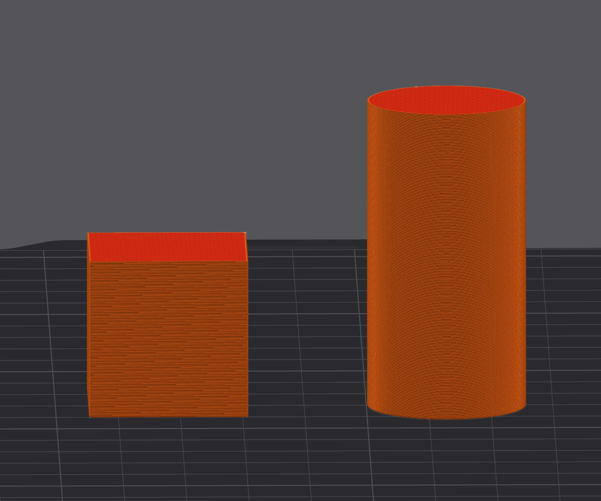

    Use a cube and a cylinder. Make one twice as tall as the other. If you see a change in gloss or texture on the taller object starting at the layer height where the shorter object ends, that’s a strong indicator that speed (or cooling) is affecting how the filament sets up.
