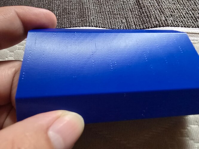

Hi, im getting this problem on mi prints. Ive tried with different filament but im getting the same. I recently made it maintenance, but it didnt solve the problem.

IMO this looks like something wet filament could do. Try to dry your spools before your next print. PETG?
It looks too sparse to be seam set to “Random” but if you have it at random, consider not :slight_smile:
Hi, the filament is dry it’s PLA+ from esun. I’m using back setting for seams.

Hm, then I will let an X1 owner chime in with more details
But if you still are interested in my opinion (lol) perhaps it’s near it’s limit for how fast it can melt. Maybe try a small test (cut that object up) adding 5-10 degrees to your nozzle temperature and/or slowing wall speeds 25-50% ish just to see if it dramatically changes.
When you say it’s dry, do you mean you dried it, or you opened it? Could just be running it too fast, this is the generic PLA setting, right? Or did you use an esun profile?
i have a ams 2 pro so i’ve dry filaments with it. I will share my speed settings, but it’s not fast, im using the esun profile.
