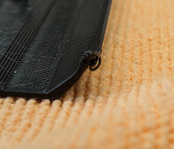

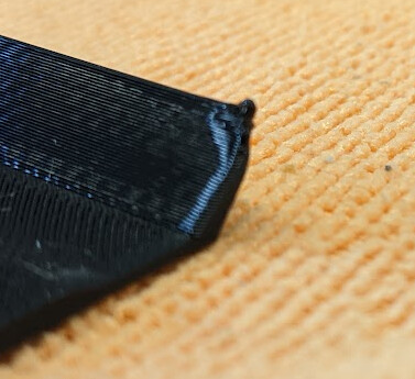

The one thing I cannot eliminate are defects near the top of thin edges. Any ideas?
I just use the Bambu Lab TPU 95A HF profile for Overture High Speed TPU.
It works faultlessly.
I do not experience the issue you mention.
Interesting, I tried that first and had worse results than with my tweaked settings above. At least for these thin prints with sharp corners.
For a benchy, the Bambu profile was fine.

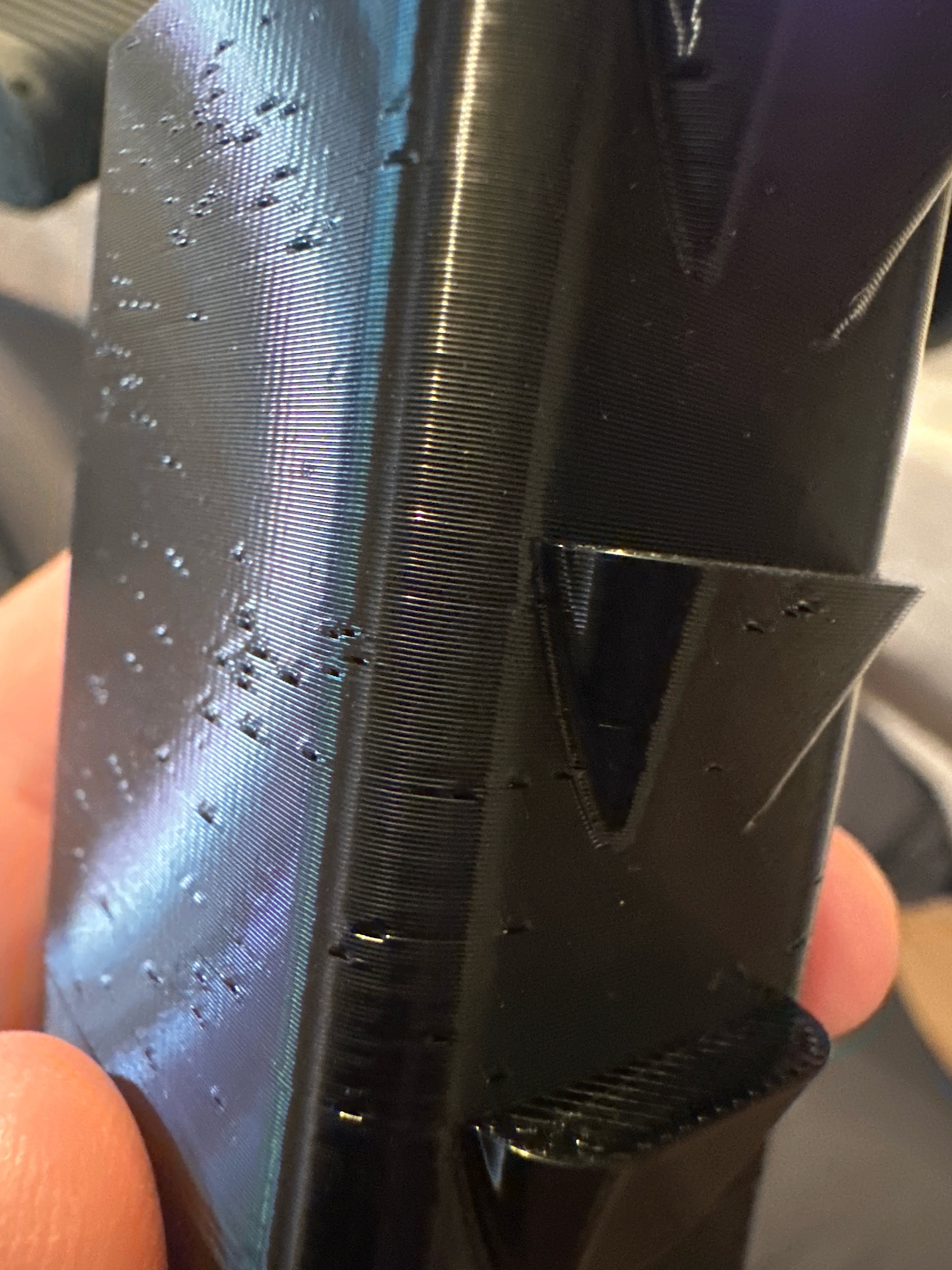

Does anyone get missing segments when printing straight with the overture tpu hs. I had mad parts in past with the generic tpu and now getting these sits. Did cold pull until clean dried for 11 hours at 54c and live in a low humidity environment and no improvement.
That still looks wet. Overture recommends drying TPU at 70° C.
I sure appreciate the feedback. Will heat it at 70c over night for 12 hours just to make sure it’s dry.
It’s weird because historically the filament opened new has always been dry. For the past several orders purchased it’s been doing the blob thing. Prior batches printed great right out of the bag. No changes to the settings so I agree it’s got to be moister.
Thanks so much for the input.
