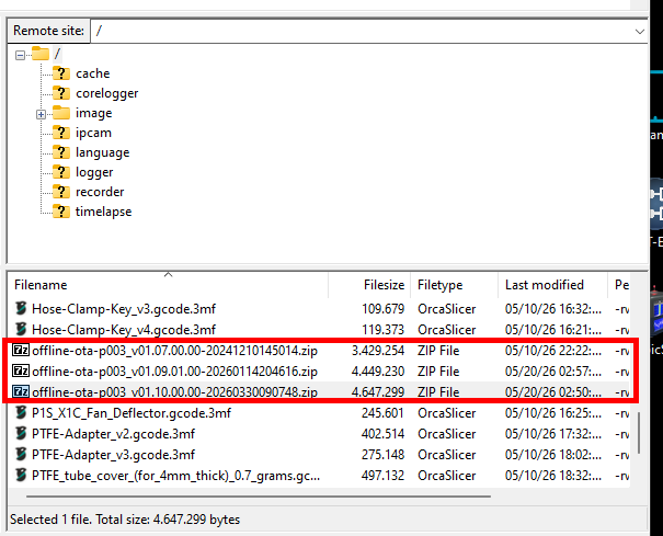

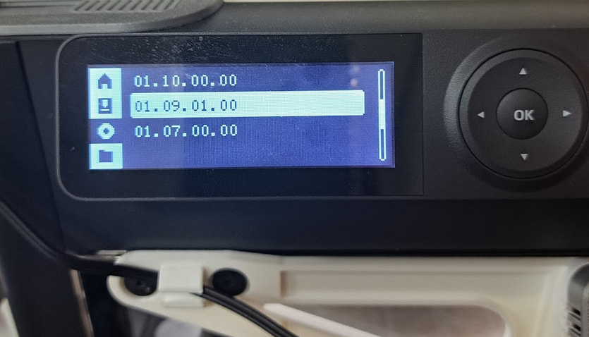

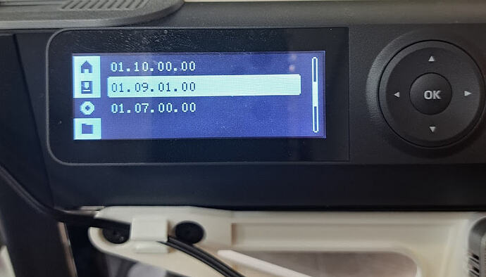

@print.in.3d Yes, you can downgrade from 1.10.x to V1.07.x and back.
I was on V1.10.x and copied V1.07.x, v1.09.01 and V1.10.x on my SD card.
Device shows firmware versions on SD card:
Images from my screen taken with time stamp during the test:
V1.10.x at 6:37pm
V1.07.x at 6:49pm
back to V1.10.x requires to flash V1.09.01 first.
V1.09.01 at 7:01pm
finally back to V1.10.x at 7:04pm
