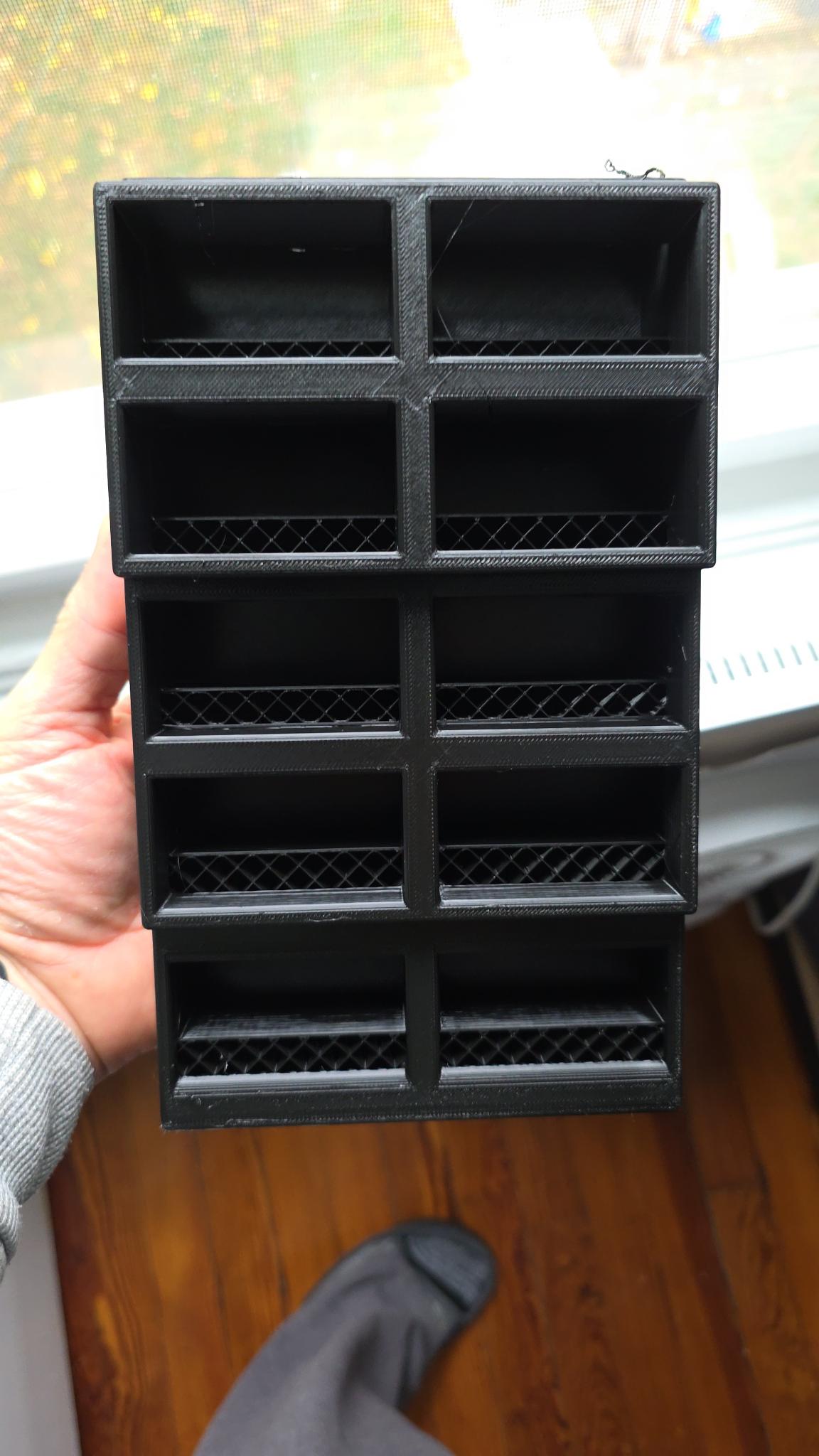

P1 is randomly shifting about 1inch into the print
So I’ve been running into issues with this shifting for a while. Sometimes its because it gets knocked off the base. I dialed in the settings and stopped it from coming off the base, but randomly through a print it will completely shift like the x-y axis moved 1/4" both ways for no reason.
One thing to note is I’ve had to set my zhop to 3mm! (not 0.3, 3.0) because it was also knocking things off the base.
Any suggestions would be greatly apprecaited

That sounds like a bed adhesions issue but I’m not sure what you mean by “shifting 1 inch”, are you saying that the model is coming off the bed or that the the printhead is shifting?
What kind of filament are you using?
BTW: I have yet to find a reason to adjust Z-hop although I’ve experimented with it, I’ve never seen it help much with any print issues. Most of the time I had issues it was related to something else.
What I can’t figure out is what’s going on with your brim? How did you get the slicer to only put the brim under part of your model? It’s more of curiosity than anything else and I’m not sure if it means anything but I’d like to know just in case there is something about the model that is not obvious from the pic.
As far as ideas go. I’m guessing you’re using Matte filament? I say that because of the lack of gloss and also because the problem you’re exhibiting is exactly what I experienced with matte filament.

  • Slow the print speed down to quiet(50%)
  • Try a completely different filament.
  • Did you clean the print bed? If it’s an adhesion issue Isopropyl alcohol or Windex will clean off any skin oils. Alternatively, washing it in the singe using standard dish soap works great too.
  • Attempt to cut the max volumetric flow in half via the filament settings.
  • Change the angle position of the model on the plate. It looks like you’ve got enough room to do a 15 degree rotation and that may give you insight as to what’s going on if the shift changes.
  • Vary the hothead temp both hotter or colder? If you are using matte filament, I can share with you that I found that matte filaments like it a lot hotter. I used PETG settings by accident and it actually cleared the problem.

I did have a similar issue on the X1C with a complex print on the smooth cool plate. I was able to resolve it by using non-crossing infills for the part and the supports (gyroid and honeycomb).
It may not at first appear that crossing lines of light infill can have much of an impact. However, the moment arm to the base increases linearly with build height. So if it always happens at around the same height, minimizing even minor “collisions” may help.

Thanks for all response and all the suggestions…The back part behind the arrow is actually a support for a piece higher up (that’s completely vertical so no tree supports)…and from what I’ve seen vertical supports usually do not have the brim (at least from what I’ve seen?)

I’m using rather inexpensive matte black PLA because I’m printing a full costume for my son!
I’ll try again without zhop (and use time-lapse as suggested for more info)
I’ll try quiet mode…I didn’t know about that, I just dropped down to fine quality, I thought that would reduce speeds?
About to order new fillament so I’ll let you know, I have some that came with the P1 so that’s probably the best place to start
I did clean the plate with soap and water and was very careful not to touch it.
I’ll try changing max volumetric flow
It might be tight for this print to shift, but I’m sure I can get by with 10 deg or so…I guess anything is better than straight x/y
I’ve only tried 210/215/220 for head
I’ve noticed the hotter bed is definetly better…50 worked much better, 60 was causing it to “jiggle” at the high print speeds I was using.

Just wanted to report back!
I stopped all zhop/length etc
kept bed at 50, nozzle 215
Rotated the prints ~10 deg
Changed infill to gyroid
volumetric flow from 12 to 9.
So far I’ve printed 4 objects without any issues!
Thanks everyone for your help. I have a feeling the infil being grid straight on the x/y axis might have been cause them to get bumped or something. Either way, gyroid is working great!
