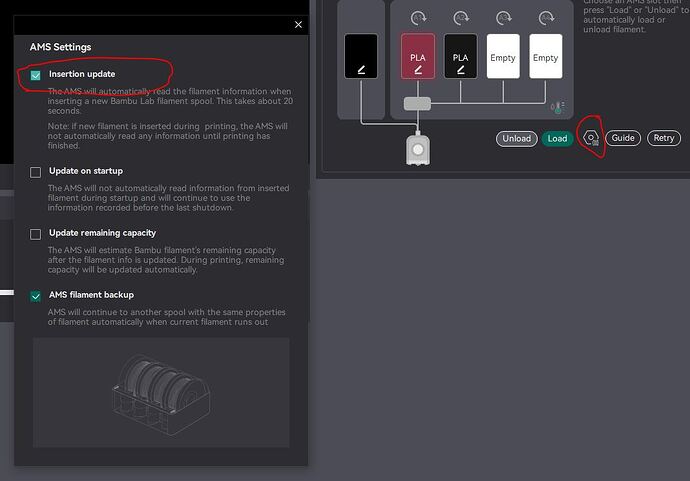

I bought some filament from Bambu, and when i load it into my p1p, Bambu studio just thinks it the generic PLA that i was using before, and i have to manually set the type and color. Does the P1P not have the RFID reading capability?

But in the slicer software add a part slice it.
Then click on the top device tab and see if you have these options.
Keep us updated ![]()
That top option was already checked for me when i loaded the filament. I ended up having to check “update on startup” and then restarted the printer, then it recognized. Thats a bit annoying to do everytime i change filament though, as it resets my access code, and i have to reenter it into all my software/devices again.

Sometimes you get a roll that will take multiple attempts to read for some reason. Refreshing the slot a few times eventually works.
I did add 2 separate rolls, and tried to refresh about a half dozens times for each one. At this point its just easier to manually set the filament i guess, so no point in buying the bambu labs filament then really.

You have to synchronise the AMS with Bambu Studio after changing spools in the AMS. In the next release an option is available for auto synchronisation with Bambu Studio.
