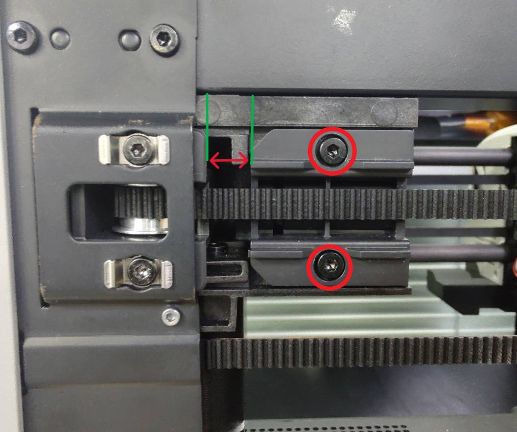

Now I noticed a squeaky sound from the [Rear Right Side] - <Facing @ Rear panel> and seen the belt would rub ever so slightly against the lower flange of the pulleys. Noticing how the pulley tensioners work isn’t as easy as how [BL] makes it seem when providing their video on tensioning the belts.
•This is the [Left Rear Side] photo above.
  • After an hour of tensioning again and again I finally was able to achieve the belt to ride in the middle but still shift near the top/bottom when all the way forward/back.
  • This generated a smoother flow of the toolhead without a squeaky sound as well.
  • I measured the gaps of the [Red Arrowed Regions] of the tensioner & pulley. They obviously are very different plus shift as machine warms up & ambient temps change with the belts
This is the [Right Rear Side] photo above.

Any update to this? I have run into belt alignment issues today that seems to be causing banding on prints.
Recommended to print a calibration model prior to doing this in order to have something to compare to afterwards
  1. The distance between the [Belt Tensioner] & [Idler Pully] marked with ‘Green’ line is the specific topic within this post.
  2. Issue: Due to the difference in assemblies and various factors, the “Gap” as we refer to when measured with calipers tend to vary by quite a large amount (ex. 0.056" inches)
  3. Test/Theory: When the distance is matched along both sides [Left/Right Belts] tensioner > pulley; there’s been improvements towards positional accuracy & reduction of VFA’s (ex. banding, ghosting, etc.)
  4. Resolution: Without loosening the belt tensioner, measure the distance between those [Green lines] and calculate the difference between both sides. (ex. Left=0.4355" Right=0.4052" Mean=0.42035")
  5. Now loosen screws and adjust the tensioner manually by slightly pushing towards pulley to shorten the gap while measuring with calipers to achieve the “Mean Value” in order to have both L & R tensioners be equal.
  6. Run a calibration print and spot any noticeable differences!
Let us know how it goes!

It did not help.
