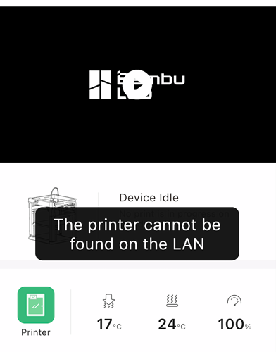

In my case the problem was an old printer firmware.
After disconnecting the AMS the p1p came up with the update immediately.
No it works everything.
This was it for me. I got the camera working in Bambu Handy. I feel all the dumb for not thinking about copy/paste. Also thanks to alexanderdubz’s post for the access code hint. Eight zeroes worked for me too.
Is updated my graphics card driver and it finally works on my Windows laptop! It was working fine on the iPhone.
I did not see any reference to graphics cards so I wanted to share.
Happy printing.
Windows Bambu Studio 1.4.0.18
P1P v 01.01.01.0

Hi everyone! Just dropping a message here that may be helpful;
P1P communicates on network using port 6000,
If you set up a dynamic hostname for your internet (or otherwise have a hostname), you can use the dynamic hostname to view the P1P’s camera outside of network.
To do this, set up port forwarding in your router for port 6000 from your P1P (might want to give it a DHCP reservation while you are there…), then, in bambu handy when on WAN, try to view video, wait until timeout, and put your hostname in the ip/hostname box, hit connect. Done, it works
@gabe.peters - Hi, Thanks, just tried this, port forwarding is setup on TCP 6000 and I have verified that the port is open.
But where is this “ip/hostname box” - I have no such box, all I have is an error message:
Ahh OK, Got it, that is the new firmware that has JUST been released, now I can see my P1P camera remotely.
The only problem is it only allows an IP address and not a hostname.
Also, on the iphone handy app, the numeric keypad is displayed without a peiod/dot so you cannot enter the IP.
The workaround is to open another app such as mail, type the IP address and then copy and paste into the IP Address box

Ok, Bambu Labs finally fixed this in Studio 1.4.2.13. Camera view finally works from the PC as well. They also added an option to enter the IP address of the printer if ssdp notify didn’t work.
However, when you try to look at Media, it still says ‘Missing Lan ip of printer’. Oh well, you can’t win them all!
Mine finally started working after the last firmware and software update.
But like others the media option still fails 'Missing Lan ip of printer’.
After trying so many things eventually got rid of the issue by checking the camera preserve settings on iPhone.
If someone is struggling to connect with the windows app to the P1P camera, the latest public beta version (v1.7.0) of Bambu Studio solves this problem (at least for me)

I have a new P1S, and it has been working fine yesterday. However, this morning I just started getting the error on Bambu studio as follows:
Initialization failed (Missing LAN IP of printer)
I have a P1S. I am using the latest beta of bambu studio (1.7.0.65), because it is the beta that knows about the P1S printer. I am trying to view the camera through the “device” tab of the studio. The Bambu handy on my phone still connects to the camera ok.
Then, after about twenty minutes of reading online and writing in this forum, it suddenly worked again, without my doing anything specific to try and fix it.
I’m hoping Bambu will get some official word out on this specific problem with this specific error message.
I am having the same issue as @Wruin, only my camera has not come back on yet in Bambu Studio. I did begin working this evening in the Bambu Handy app on my Android. Kind of frustrating really, because the P1S id finely tuned, at least mine is. I have had it almost a week and printed both ABS and PETG without any adjustments at all. But when i first printed the PETG, I had to sit in front of the machine watching for signs of spaghetti or bed adhesion issues because at the time neither of the ways to view the camera feed was working.
I also cant connect via the Cloud to my Printer. It always ask for the LAN IP Adress and than throw the Error that either the Access Code or IP is wrong. Is there a Solution for that?
You do a firmware update yet? Did you shut off and restart the machine?
Restart yes, but no Firmwareupdate.
Update: A Firmwareupdate fixed the problem for me
I looked for this on various websites including youtube and solved it using to permit camera permission.
