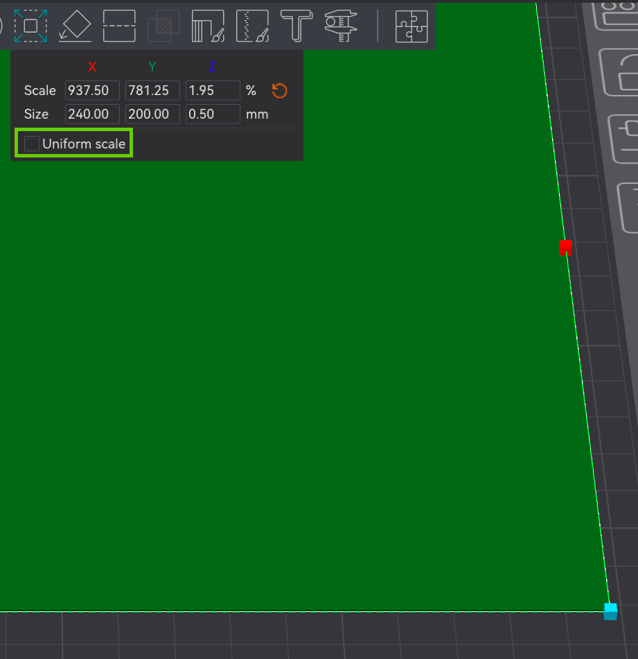

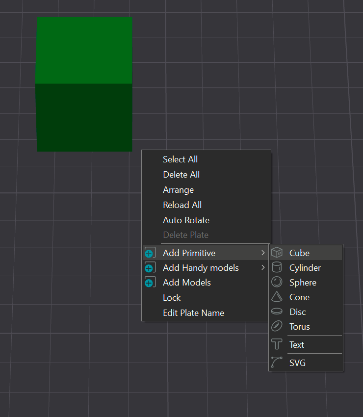

Here’s a simple process that should take about 35 minutes and if you aren’t getting perfectly flat, smooth and consistent adhesion, it will be very obvious.
  1. Hit CTRL-N to start off with a completely new project with all defaults. Select the filament profile you’ve been using.
  2. Right-click and select cube primitive from the menu.
  3. Using the scale tool, resize the cube to a dimension of 240x200x0.5mm. Make sure that the "uniform scale box is unchecked.
  4. Slice and print the model.
What this will do is extrude a single layer of filament over the bulk of the build plate. If you notice any defects, then post the photos here and any one of use from the community will likely be able to make suggestions as to what the remedy is or if further diagnostics are needed. However, start at a first layer test to make sure you aren’t experiencing other issues.
