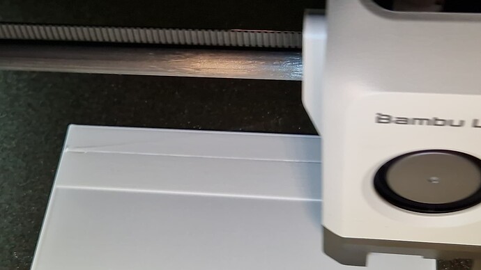

I also have p1s+AMS. btw I haven’t tested it yet. I assume it’s because of the temperature difference? The identical layer is probably made from a hotter dripping of PLA/PETG material. Or it’s because that AMS needs time to refill to another roll of filaments, and the previous layer has already been too cold.
Is there a program can adjust the temp to be a little higher before refilling using AMS?
it can’t be the diff of temp. it not pass to much time till it loads the next spool.
and then when normally would start new layer on a big print, why it doesn’t miss that entire first line or more? no, it must be something else.
strange thing is, it loads, purge and poops, so the hotend chamber is full. why does not extrude it intrigues me. the hotend just travels but not extrude.
it happened again. i specially left an end piece of filament to print first, and after, it would make the “refill” maneuver. it did. and again left some empty distance.
luckily it was in the middle layers of print and it was covered till the end.

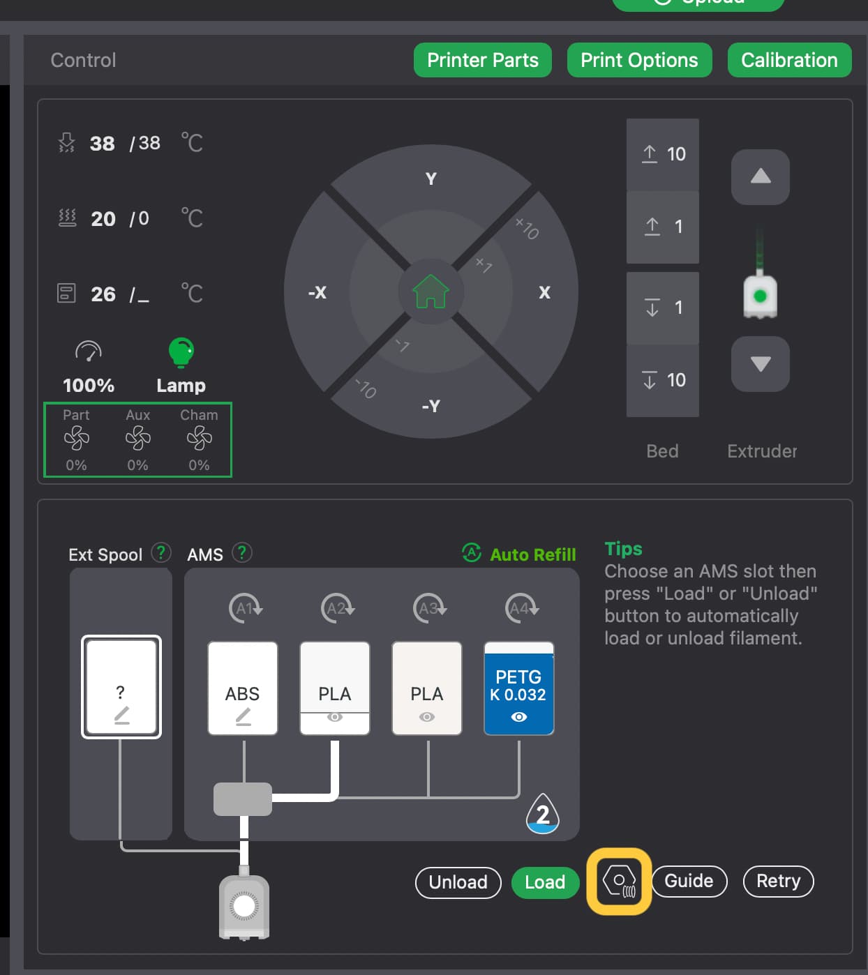

I know it’s been a hot minute since your post (six months to be exact), I was wondering if you can shed some light on how you were able to convince the printer (I have a two-week-old P1S w/AMS) and AMS that the two different slots were the “same” color. I ask because I have the green & orange partial spools that came with my printer, and I’m not sure that there is enough on just one to print the poop chute though I believe there is enough on the two spools combined. When I start a print I do see auto-refill is green. Thanks for any advice you can offer.
The easiest way is to let the spool run out and insert the second spool into the same slot when prompted.

I’ve read through your post but I’m still not sure how to convince BS that even though slot 2 & 3 are different colors (green and orange) I want them to both be orange. To JonRaymond’s point, a two tone print may not be his cup of tea, but it’s a poop chute behind the printer, so who cares. I just want to use up the filament. I have tried to find the answer myself but without much success. Any tips?
The printer pauses when it runs out of filimanet and isn’t set up to autofill. Load the next spool and resume.

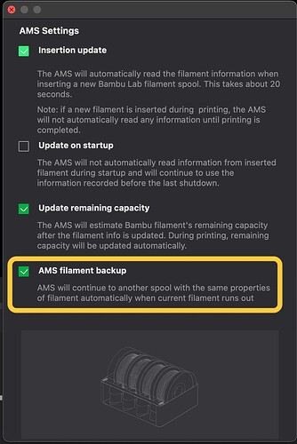

In Bambu Studio under Device you can set the AMS Spools to whatever color you like (independent of the physical color of the filament) so if you have a green and an orange filament in the AMS, in the settings just change the colors of the spools to be the same and it should allow you to do auto-refill.
Thank you so much, just the info I was looking for.
This was the trick! thank you :slight_smile:
I don’t think it works with Generic brand setting. This seems reasonable since logically, there’s no way to know if “Generic PLA” and “Generic PLA” are the exact same filament.
You could try overriding the settings in the printer (or on the Device page of the app) after the AMS is done with its auto-detect attempts. It should swallow the override and then “just work”.
On my X1C, to get the override brand to “stick” on the printer I have to change the brand to BambuLab, then the PLA to something else then back again, before confirming the changes.
In Bambu Studio, you cannot change the Brand field in the filament settings themselves but if you save a copy of a BambuLab filament setting, it will retain the BambuLab brand. Far as I can tell, this makes no odds anyway. The system doesn’t appear to do any checking that what you put there is “true” or not. It just runs with whatever you say it is.
