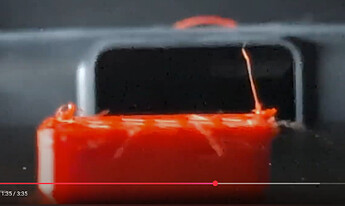

My P1S+AMS is having an unusual issue that I can’t find any solid answer for. It seems like some sensor is getting constantly triggered causing what you can see happening in the video below. It might be a bit loud if you have headphones. Tried to zoom in and out to give a better view of what’s happening when it’s piping filament, if you’d rather have a video of something else for longer/shorter just let me know:
For lack of the correct technical term, my Printhead is stopping mid print, lower the Z, and moving the X+Y to the front+right corner “randomly” (for now I’ll just call it “cornering” due to my ignorance of the issue).

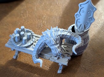

  • I originally printed this monster head that turned out pretty nice, along with other minis:

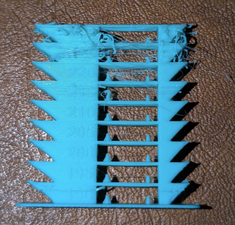

  • Ran a Temp test as I knew it printed at a lower temperature (I know it looks blue but this is the Mint Green just an odd trick of the camera):
    Note: Temp Test require altering the GCode but I reverted that.
  • THOUGHT I updated the print temp to be around 200-205 on a new copy of the Generic PLA profile.

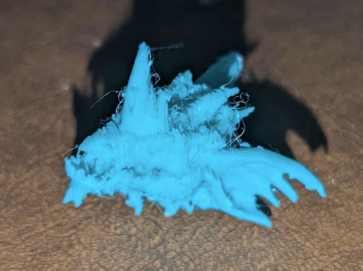

  • Tried printing the second head of the monster mini and it looked like this:
  • Updated the temps and it was better but still bad (post removing supports etc):

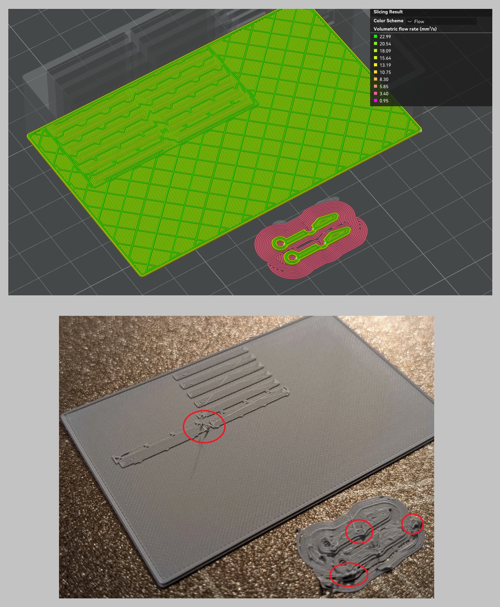

  • Decided to try a flow test as I realized the flow on the Generic might be too slow for the Sunlu Meta, but it was giving issues as well.

  • Seems to happen consistently-inconsistently

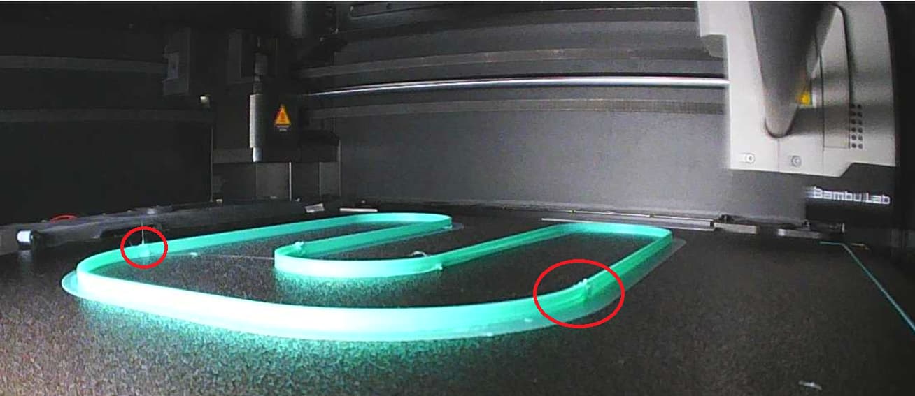

  • For instance, in the flow test I mentioned, you can see some blemishes where it started lifting up, but in consistent spots (circled 2 of the 4-6 spots that it would “corner” at), but then as the print would continue, those spots would no longer cause “cornering” and then later on it would again.
  • In this image you can see it tried to print the inside of an SD card holder and a couple of hinges. It had few/no issues printing the large base, but lots of trouble printing the hinges, and then when it went to start printing the slots on the base of the box, it started cornering again.

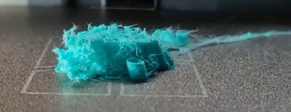

The first part of the spool printed ok, but since then, its a ragged stringy mess?
Perhaps the outer wrap was dry and the inner bits did not get dry.
Dry it.
Measure to 0.1g, write that on the spool, put it in your dryer. Try to take it out a couple times over 8 hours to remeasure. Don’t stop drying, until it stops losing weight.
