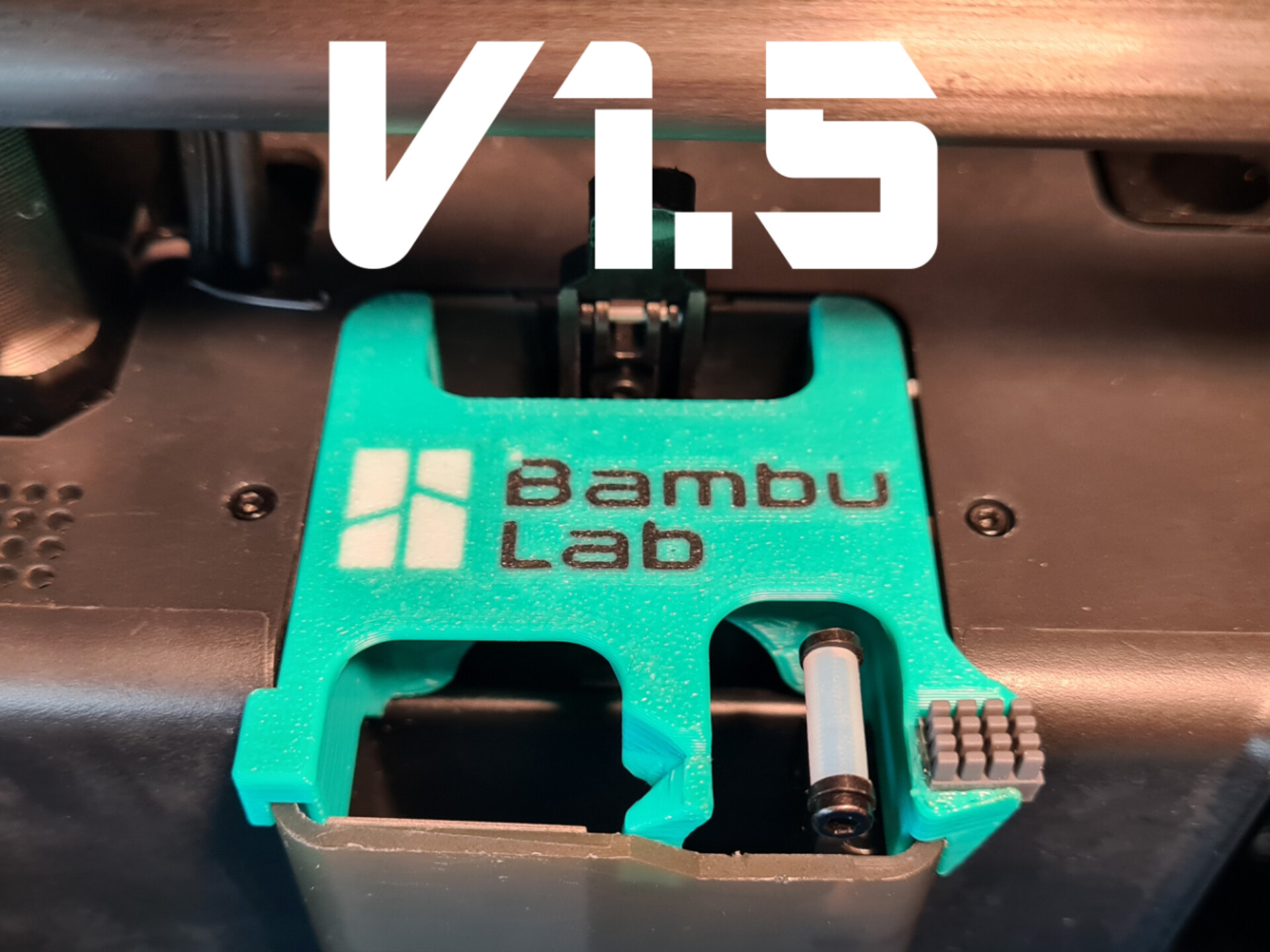

Hopefully fix incoming:

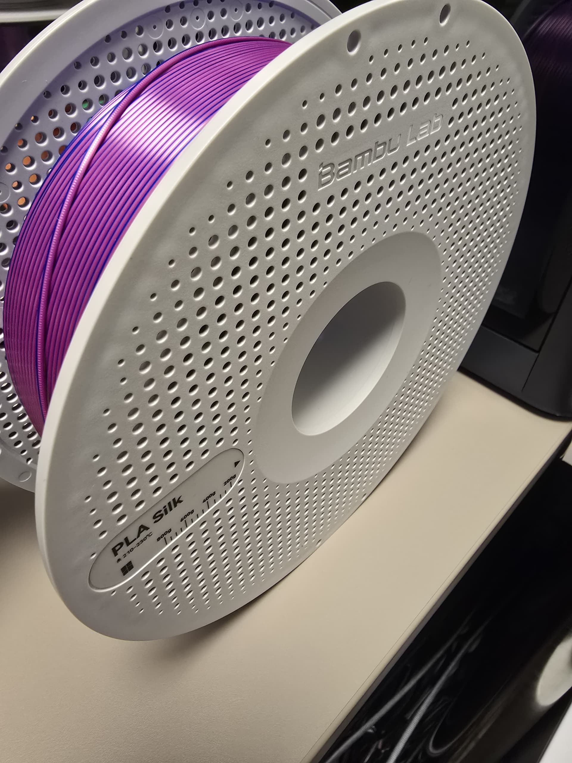

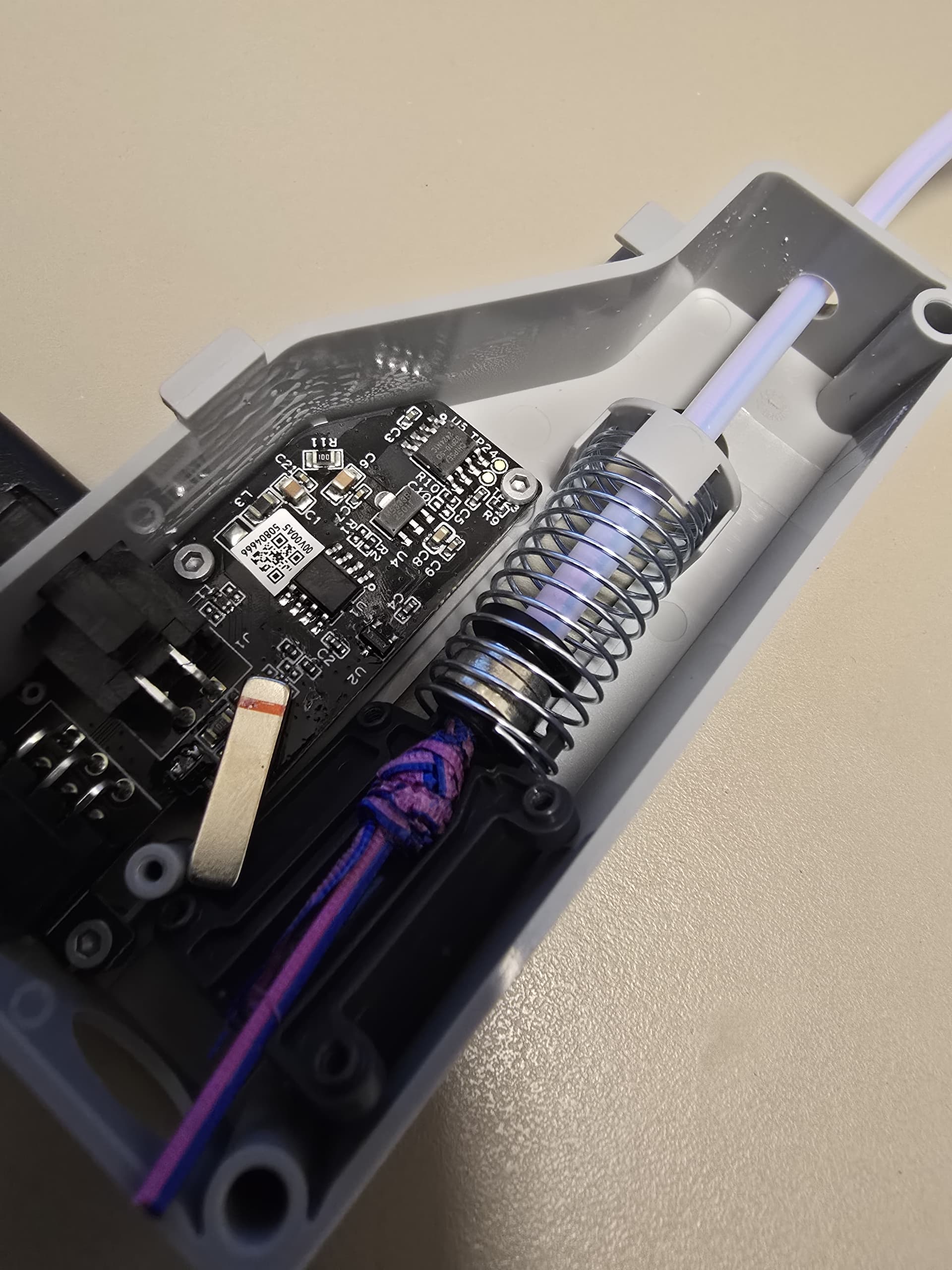

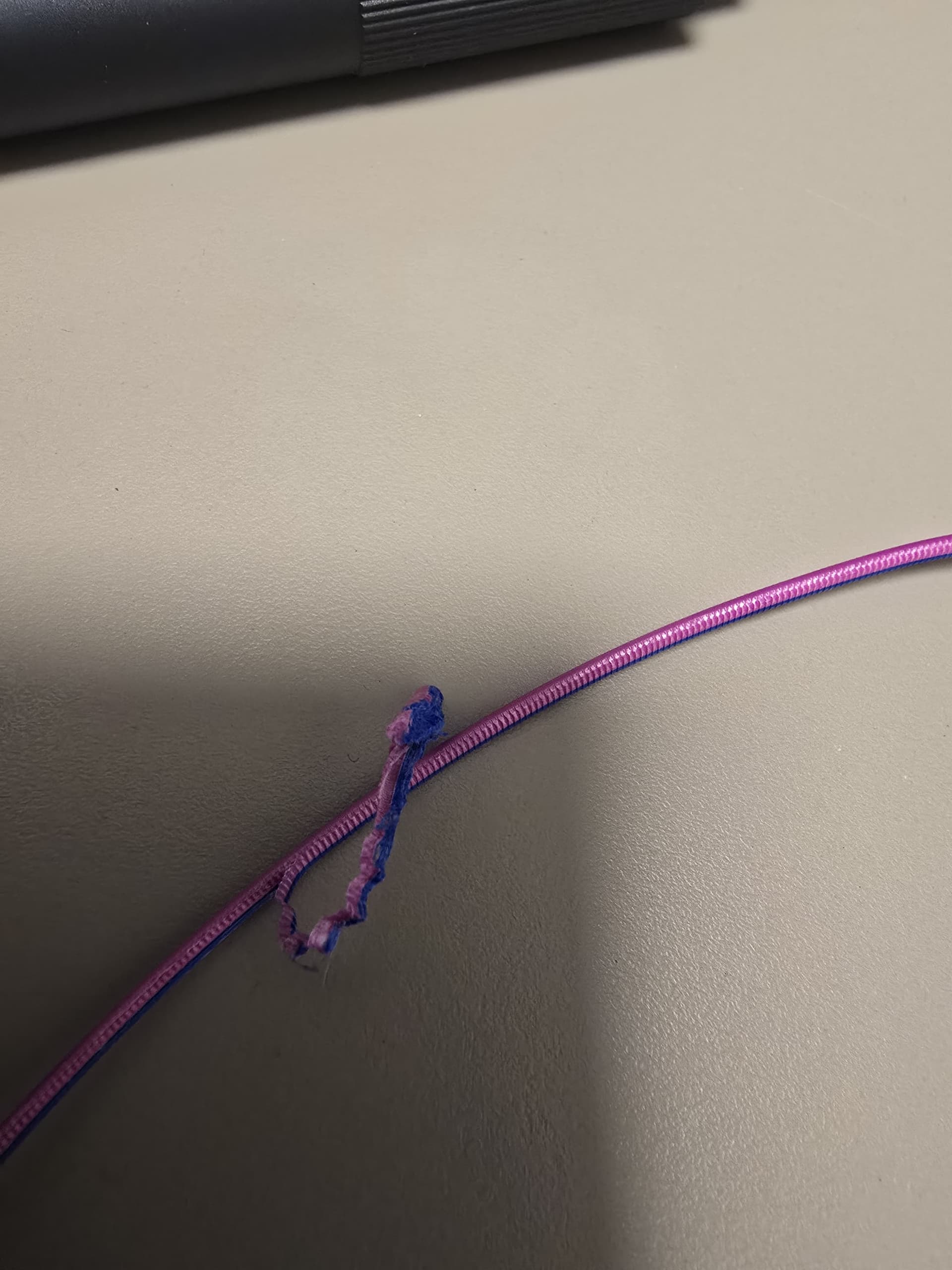

PLA Silk Multicolor (Bambu brand, dried 24h) total jam. Took apart the filament buffer, found a full filament knot. Wasted over an hour fixing it!
NEVER use Bambu PLA Silk Multicolor in AMS. You’ve been warned!

Wow, that silk failure in the buffer is intense. Never seen anything like that. Like it got peeled like a carrot.
