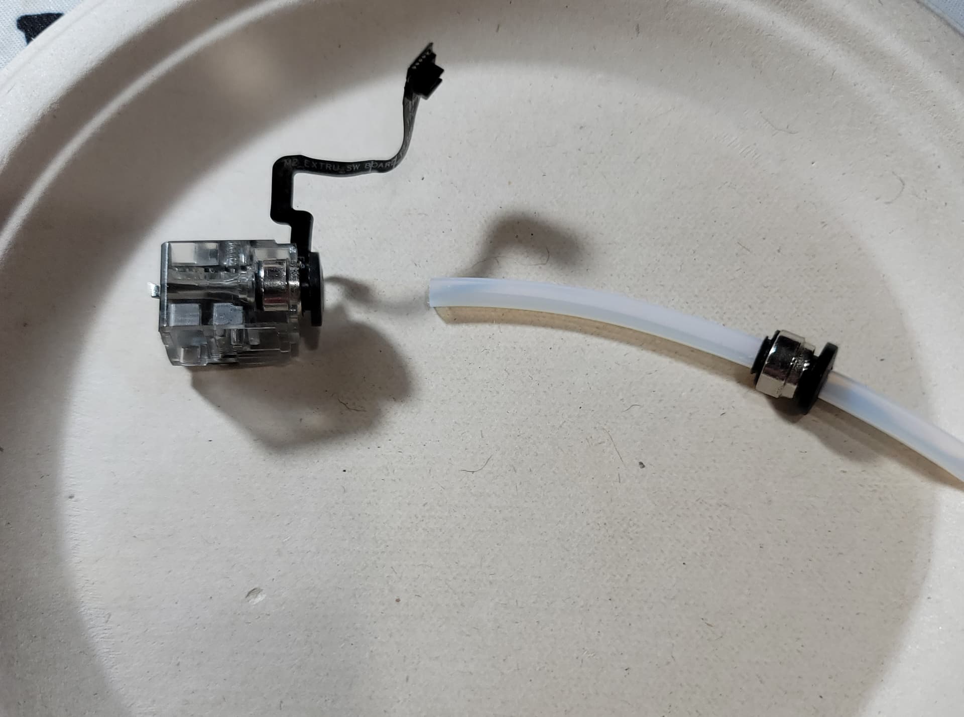

There is a microswitch between the PTFE tubing end at the toolhead and the extruder. It works to trigger the clog fault I believe and if it is sticking that will cause issues.
I have a short video that BL tech support had me film that shows. I can’t find it right now but if you are still having issues I can find it with some digging in laptop.
If you decide to remove the part in picture you need to be ultra careful you do not damage the micro-sized ribbon cable that plugs in at top.
