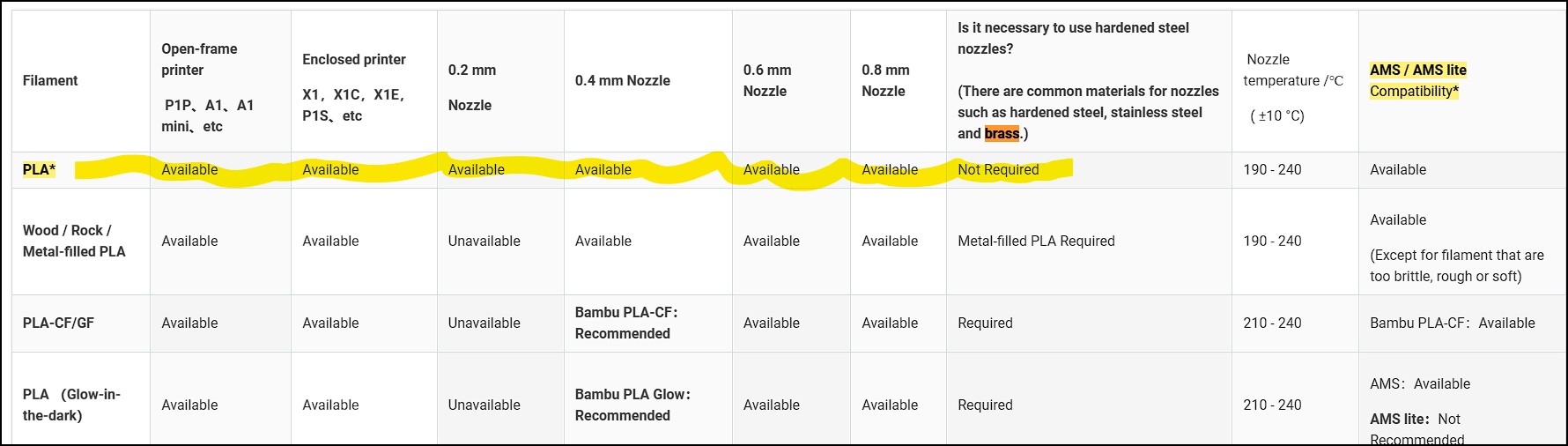

I’ve installed a Brass Nozzle on my P1S and I’m encountering a setting conflict leading to a warning.
  1. P1S Menu: The printer menu only allows selecting Hardened Steel or Stainless Steel (no Brass option).
  2. Bambu Studio: I manually select Brass under Accessories.
Despite selecting Brass in the slicer, I get this warning when attempting to print (I use PLA/PETG):
The nozzle hardness required by the filament is higher than the default nozzle hardness of the printer. Please replace the hardened nozzle or filament, otherwise, the nozzle will be worn down or damaged.
My Question:
Since I’m using non-abrasive filament:
  1. Can I safely ignore this warning and proceed?
  2. Is there a setting I missed to properly suppress this warning when using a Brass nozzle on the P1S?
Thanks for any help!

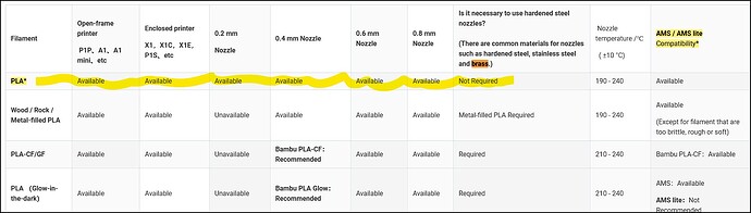

The printer only lets you select official Bambu nozzles and they don’t make a brass nozzle. Printing non-abrasive filament on a brass nozzle won’t hurt anything per se. But who knows what the nozzle itself will do.
*The PLA here refers to normal PLA, that is, PLA that does not contain carbon fiber (CF), glass fiber (GF) or other metal, inorganic non-metal fillers with high hardness and big particle size, , including PLA Basic, PLA Matte , PLA Tough, PLA Metal, PLA Silk, PLA Aero, PLA Dynamic, etc., excluding PLA-CF, PLA-GF, PLA Sparkle, PLA Marble, etc.
