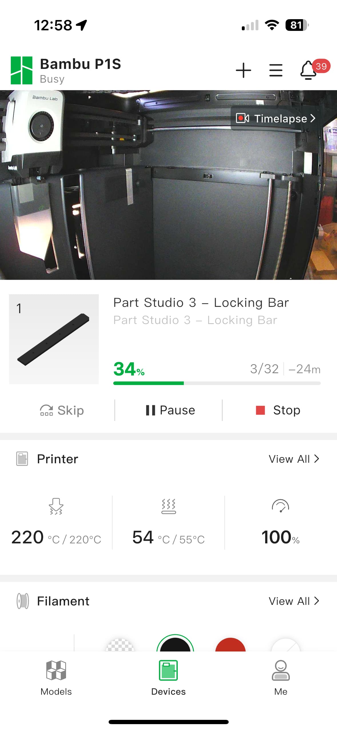

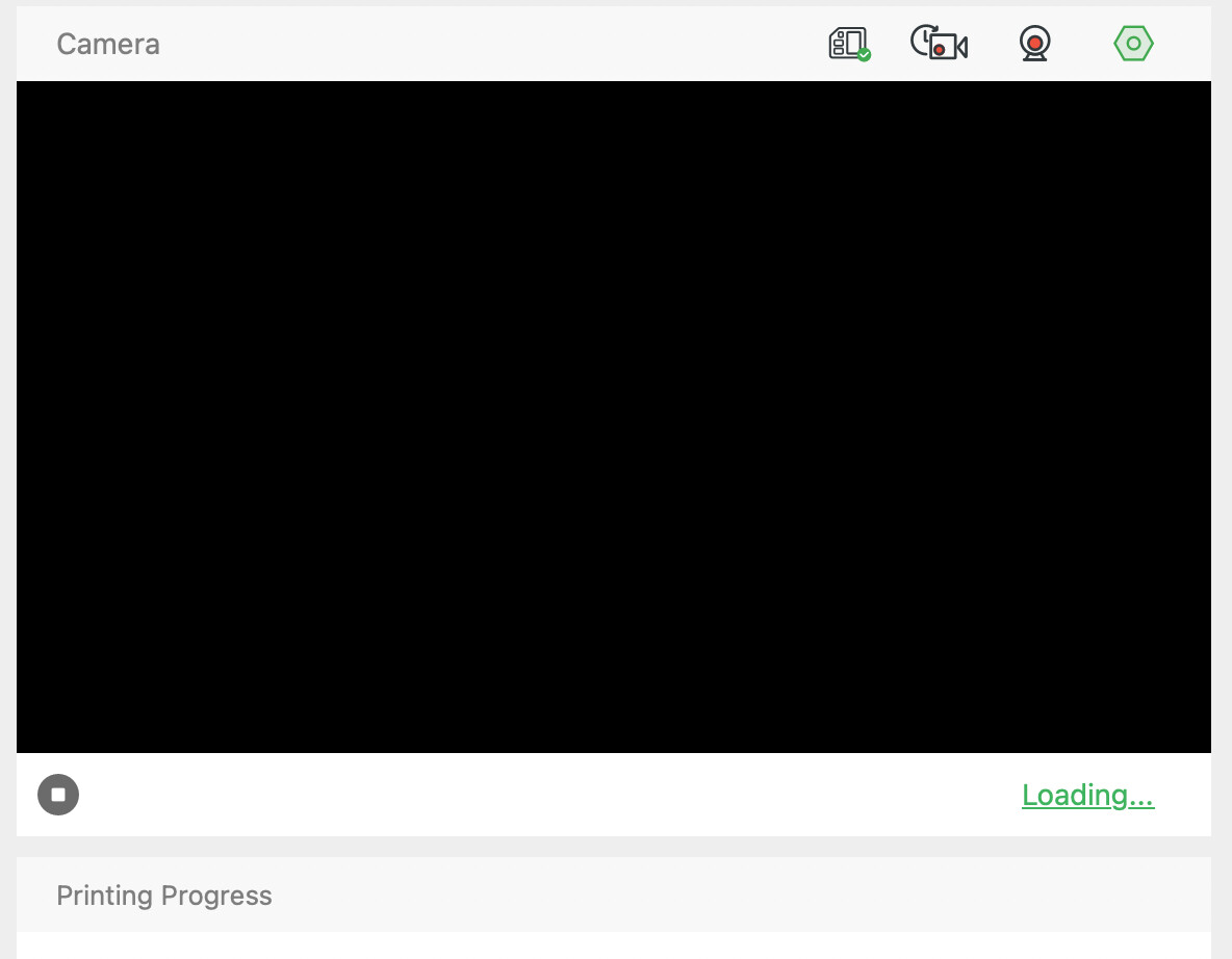

On Bambu Studio/Mac it usually gets stuck at “Loading”:

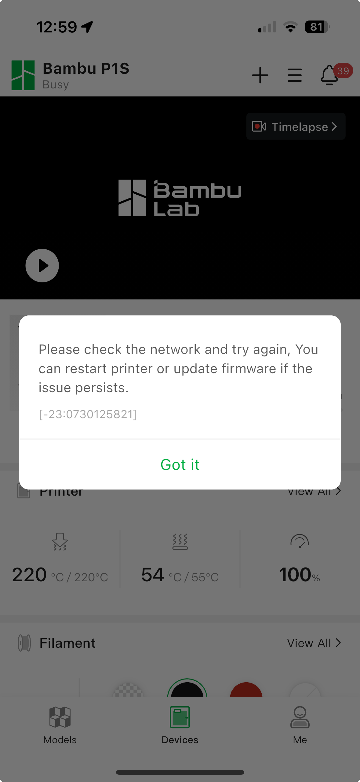

On Handy/iPhone it just goes to a black screen when clicking tapping the Play button, or worse it shows a stale image. Sometimes it gives me an Please check the network error.
Printing Progress shows without issues.

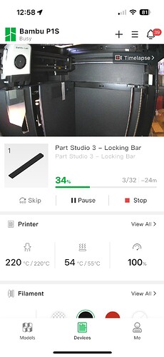

Stale image:
Network error:
Yet clearly the network is working well enough to show the progress of the print.

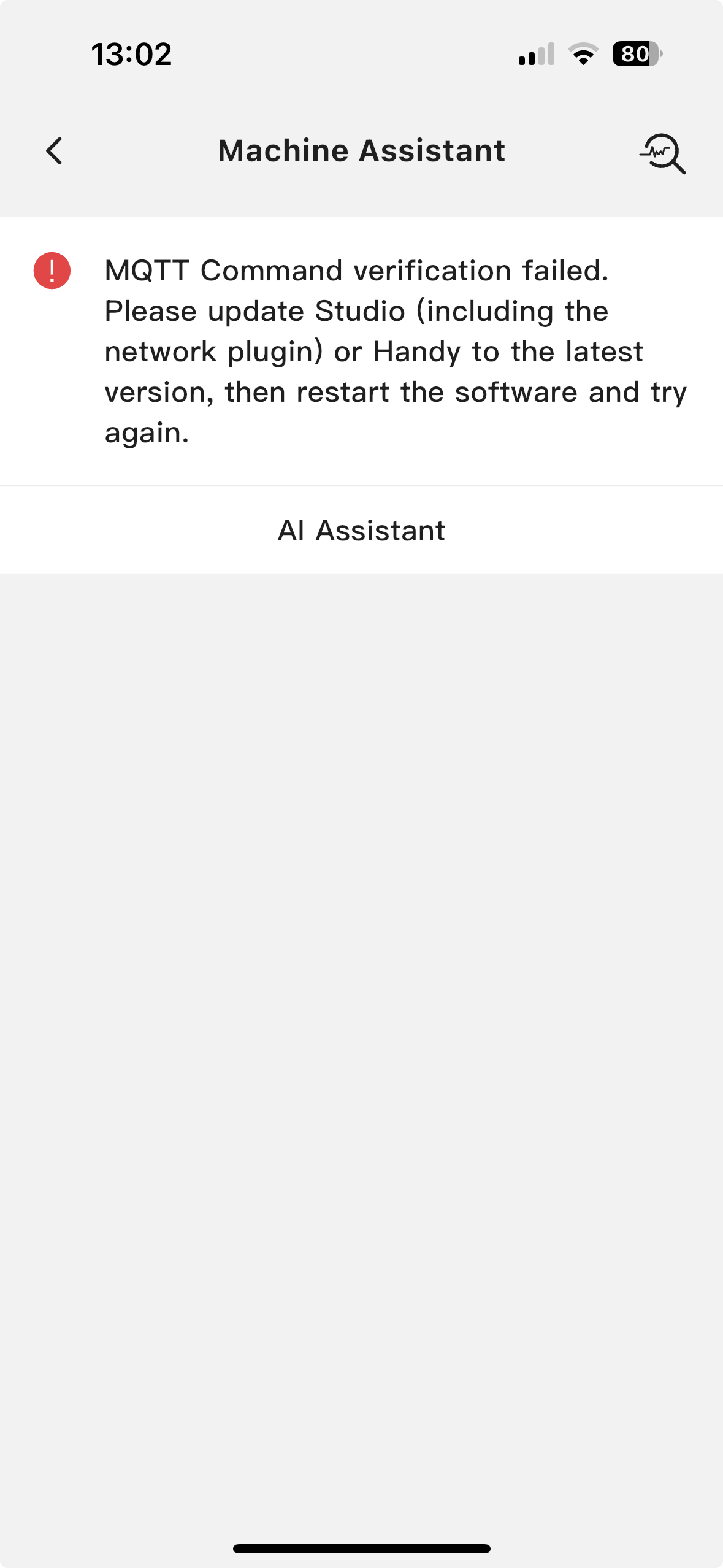

Also sometimes get this:
But there is no new version of Handy to update to.
