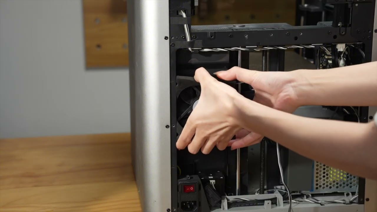

Noise in chamber cabinet on the lower righthand side. Sounds like high pitch bearing noise. When I reduce fan from 100% to 60% noise is bearly noticeable. Where do I locate photos of changing fan and place to purchase.
Lower right side - I would assume it’s the chamber fan?
This is for the X1C but the operation is pretty much the same for the P1S.

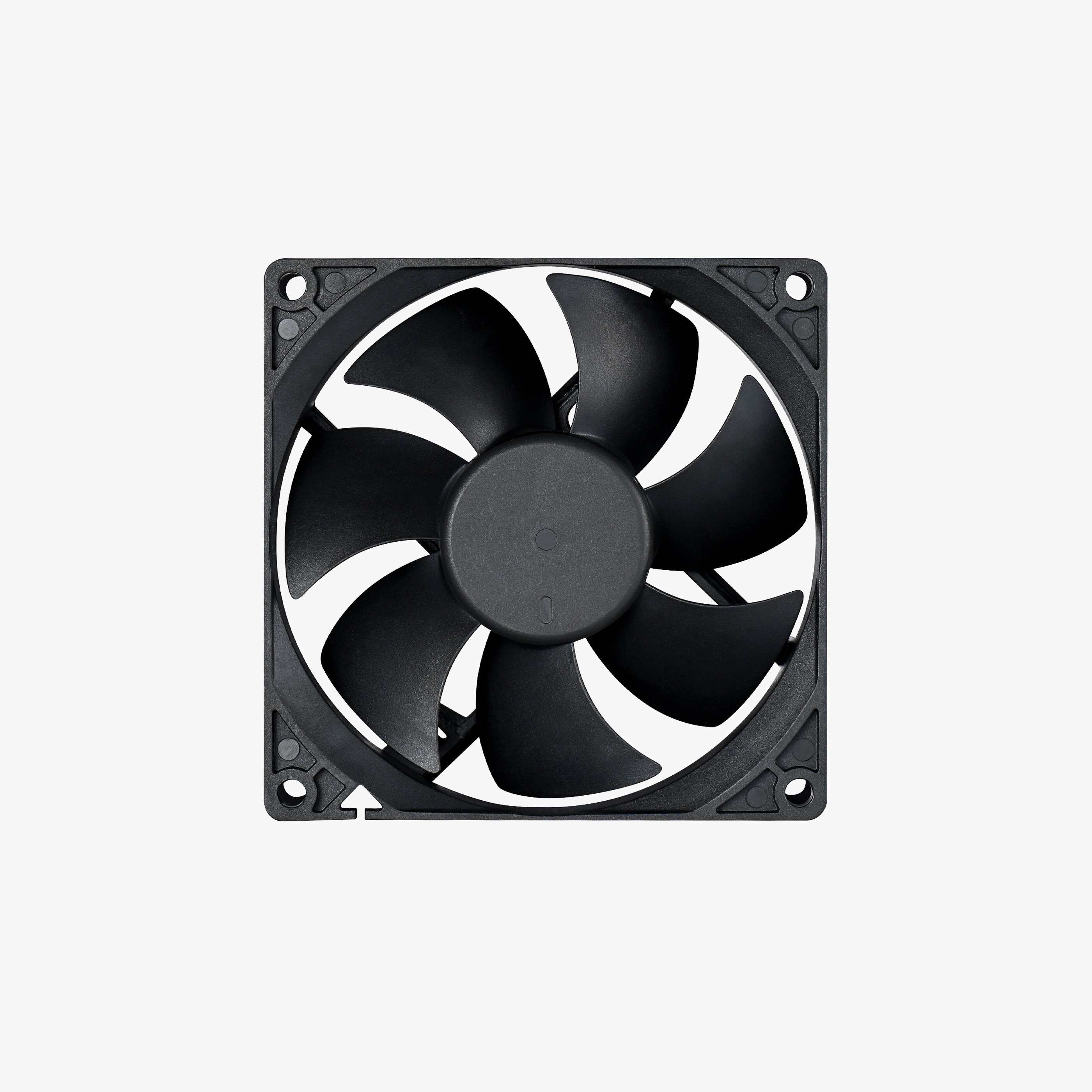

Thank you. I searched on wiki under chamber fan, but nothing was found. It looks like a std computer fan 12v. I have a bunch of these.

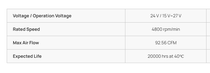

It’s a 24vdc fan, not 12vdc.
