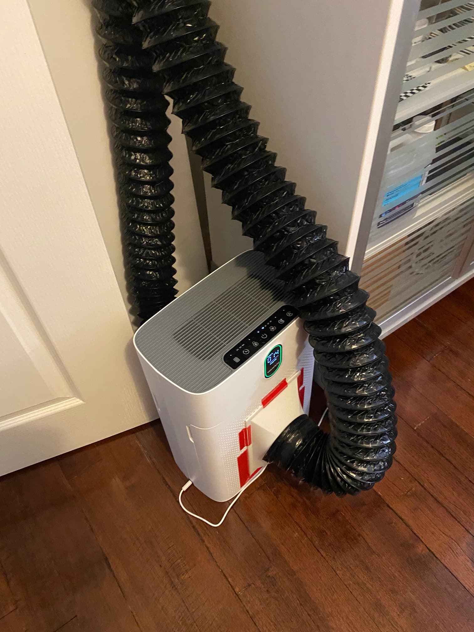

After conducting several tests and experiments, I discovered that the carbon filter inside the printer creates negative pressure. When I removed it, the fan was able to exhaust all the air efficiently. I then connected the exhaust to an air purifier equipped with both carbon and HEPA filters. Now, I can print ABS without any unpleasant odors
My testing showed the same effect. Removing the internal carbon filter, plus the rear panel restrictions gave the best airflow.
