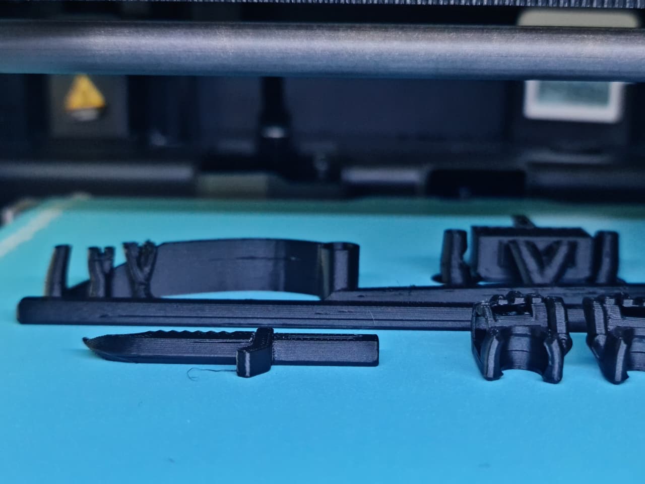

A few days ago, my P1S extruder started experiencing underextrusion.
I tried the basics, like changing the filament, replacing the nozzle, and cleaning the extruder gears, without success, until it started making grinding noises.
I tried replacing the bearings, even though I thought it was unusual for them to fail after only 3,500 hours.
The noise stopped for a day, then returned the next.
I replaced the bearings again, and the noise stopped again, but the underextrusion problem still persists.
What could be the problem?
I’ve already opened a ticket for BBL to evaluate the situation, but I’d like to know if there are any other reports of this in the P/X Series and if it could be something more serious, like the motor itself.

I had the same issue. Mine turned out to be the extruder motor. Cheap fix but at the time I wasnt 100% sure so I brought all the parts possible for the tool head just in case.
Motor is fairly easy to replace. My advise, go through the process of changing the motor on wiki and once the motor spindle is visible try turning it by hand. Mine was really rough, clearly something had failed inside. Then you’ll be sure if its the motor.

My motor failed at 1300 hours so 3500 on yours is incredible. Does the motor spindle turn smoothly…

I’ve got the same issue, but mine started on day 1 of ownership. Just unboxed my P1S, set it up, and printed the benchy. The very next print it stops extruding altogether and has the same grinding noise.
I’ve confirmed that rotating the yellow gear by hand does pull filament down, but once it’s hooked up to the drive gear, the grinding occurs. Seems like there is slippage on the shaft, or the motor is dead
Update, I definitely have a bad motor, and suspect yours will as well.
I took the three screws that hold the hot end assembly to the rest of the head out but left the ribbon cables connected. I turned the machine on and selected extruder “down” 6 times in a row while watching the drive gear spin. Not only did the stuttering and grinding still occur, but the direction it spins changes randomly (L,R,R,L,R,L). I took a video of the whole thing but the format is incompatible with the forum.
