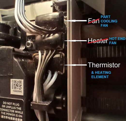

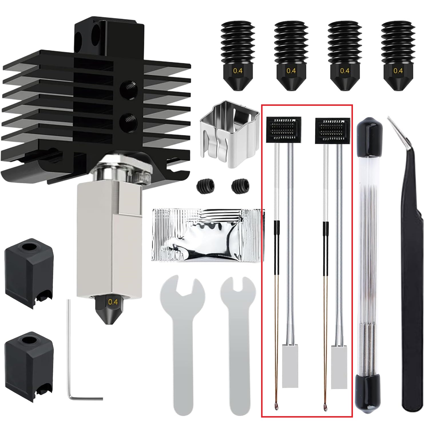

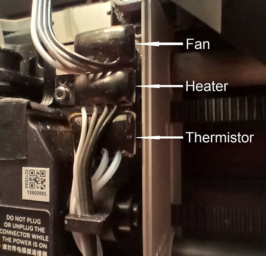

When did Bambu labs change from a two connector P1S heater and thermistor to a single connector. I’ve had my P1S since March of last year, and over the weekend I decided (for various reasons) that I wanted to change my hot end to one with removable nozzles. The one I ordered says P1 (P1P, P1S) series compatible, but I’ve noticed that the heater and thermistor are on one connector, whereas my P1S has two (one for the heater, one for the thermistor). At the top of the Bambu Labs Wiki page for replacing the P1S hot end, it shows a picture of a complete hot end, with the fan connector and a single combined heater/thermistor connector. The video however shows them unplugging three separate connectors; fan, heater, thermistor. The Bambu US store only shows the combined version for sale. Before I go beyond the point of no return (to be able to send it back to Amazon) has anyone tried plugging in one of these new, single, combined connectors onto an extruder that has two (plus the fan)? I’m including a picture of my extruder and the hot end I bought. The heater/thermistor provided is in the red box. It’s the same thing that Bambu Labs is selling on their site for the P1S. Any ideas, thoughts or suggestions?
Yes, you are absolutely right. It didn’t dawn on me until I had it off the extruder and in my hand. At the moment, I am smacking my palm against my forehead, in my best Homer Simpson voice, saying “Doh”. Thank you for your gentle correction, in the face of my stunning ignorance.
