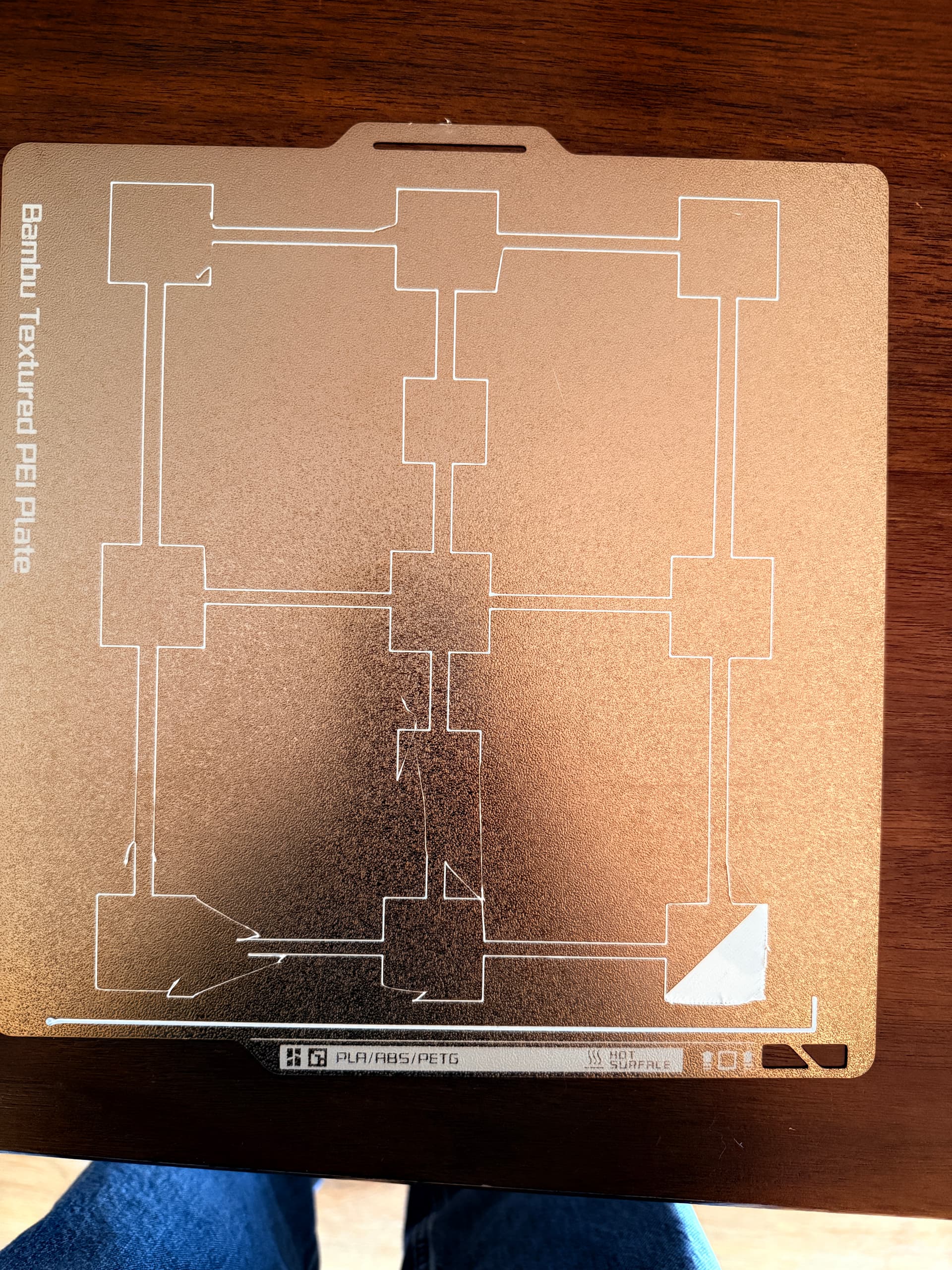

P1s intial print issue
after more than a year of successful PLA printing with minor hiccups . i started having ? extrusion ? adhesion issues .
did the whole thing calibration , clean up , change hotened changed filament .
nothing works at normal speed that i used to print with
one thing helps a bit is slowing first layer to 25 mm . any suggestion where to start ?
Welcome to the forum!
I see you said you cleaned up… did you take it to the sink and really scrub it with dish soap and water?
Only to add to what @PrinterMcgee has said.
Yes I washed it multiple time with dishwashing detergent scrubbed , followed IPA . Same issue persists .
Auto bed leveling before the print? The IPA was before or after the scrubbing?
