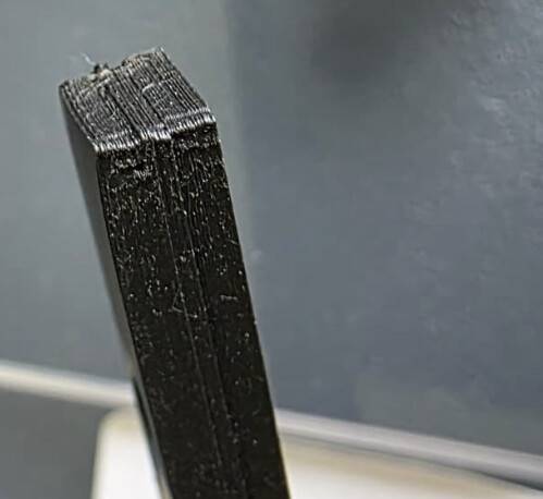

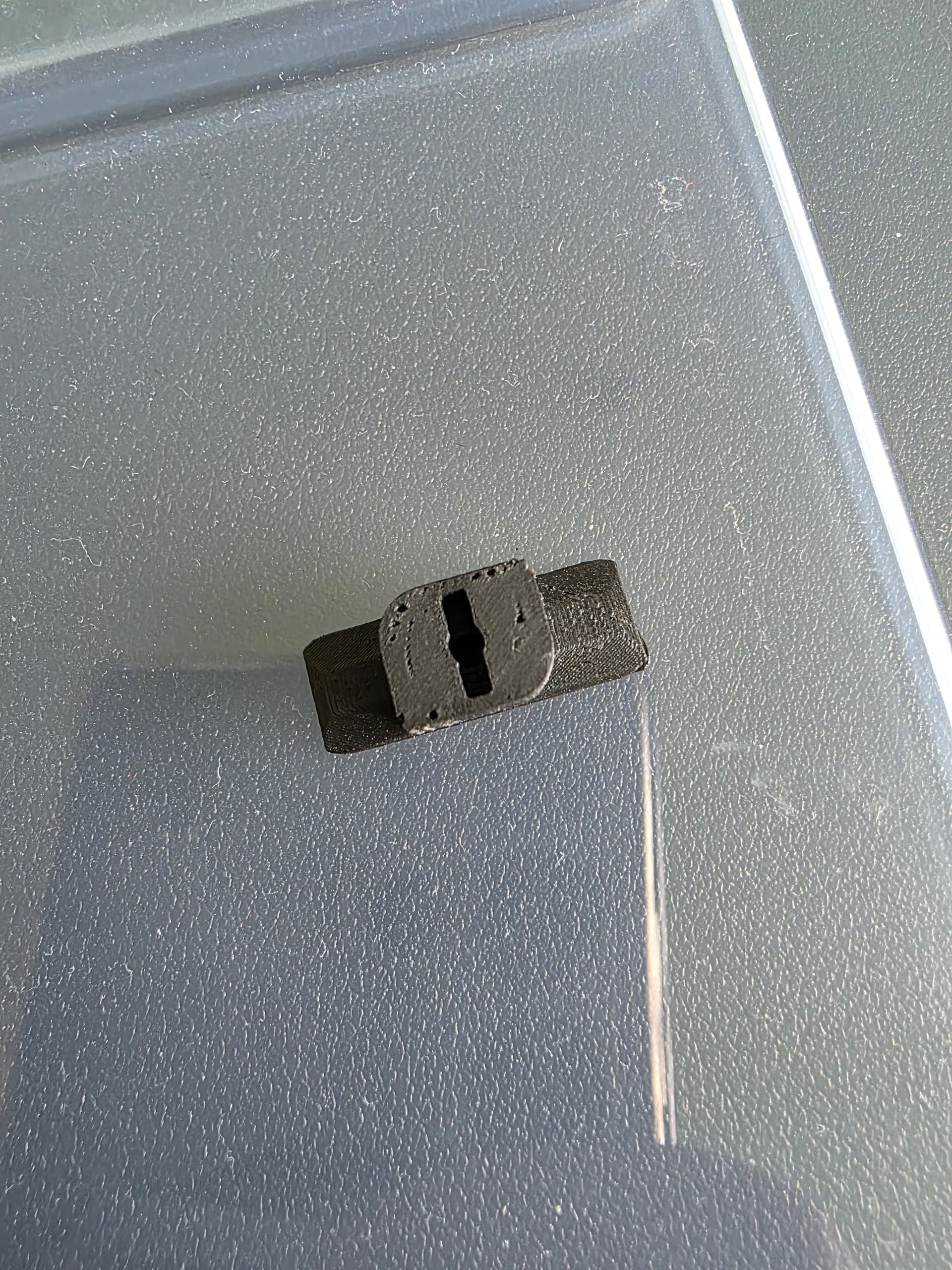

P1S no longer prints properly
Hi everyone, I’ve been printing the same parts in small batches for two months now. However, my P1S has suddenly been having problems for the past two weeks. Sometimes the prints don’t stick together, or they stick too tightly, small holes appear in the print, or it’s extremely stringy. I haven’t changed any of the slicer settings. So far, I’ve cleaned the print bed (Smooth PEI Bamboo Plate) several times and calibrated it via the printer. I’ve performed a few cold pulls on the extruder until it was completely clean, and I’ve even taken the entire extruder apart to see if there’s a problem.
The filament actually comes sealed out of the package and goes straight into the printer. To compensate for this, I’ve increased the flow in the slicer, which makes the holes a bit better. However, I feel like the problem is getting worse, and I’m slowly running out of ideas about what else I can do or what the cause is.

corner lifting → bed adhesive issue, need new plate or not clean enough, or maybe bed temp is not high enough
What is this waviness here, does it protrude out due to excessive of plastic?

Since you said that it needs a new plate, do you or does anyone here know of a smooth plate? If so, how long does it last?
The waves do not protrude, but rather there is a lack of filament and grooves are created.
