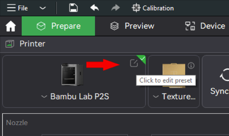

Can you explain how did you exactly? Thanks!

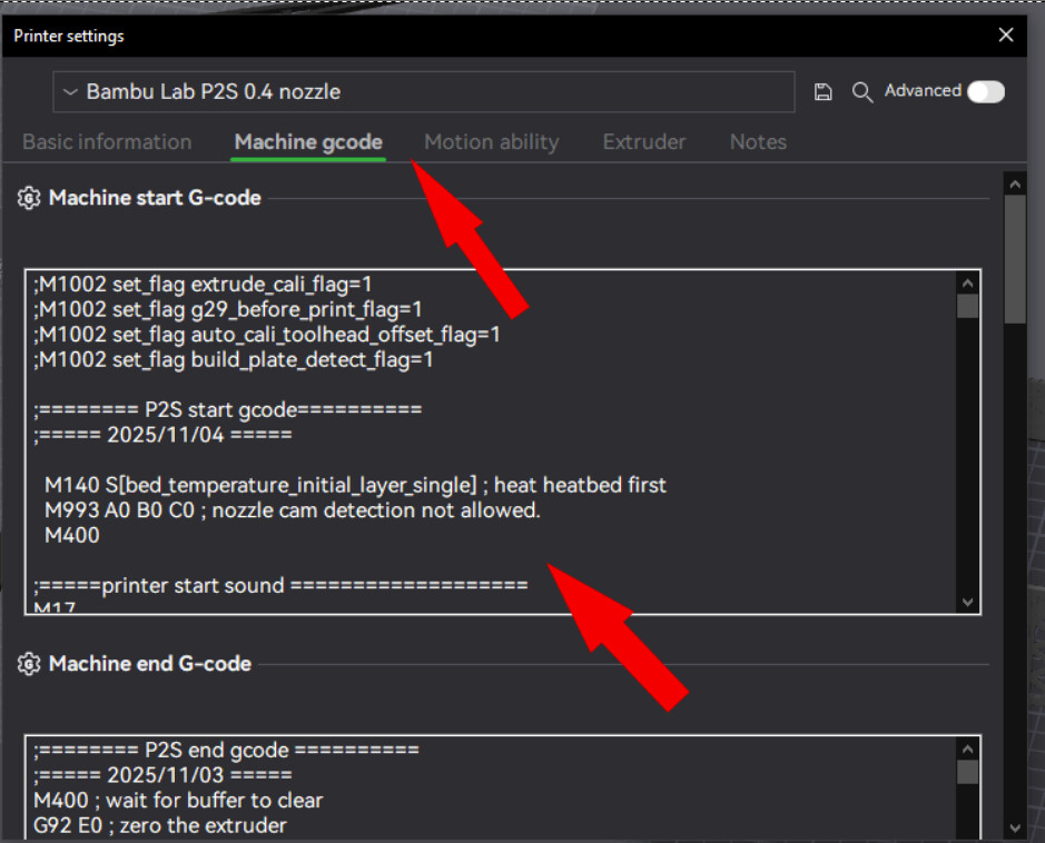

In Bambu studio you need to open the Printer Preset
Select the machine gcode and then start G-code (if that’s what you want to edit)
There you’ll find every code that gets executed before the actual print starts.
I can’t give you any specific spots as it’s been 2 years. Also - do it at your own risk. I personally have had 0 issues.
