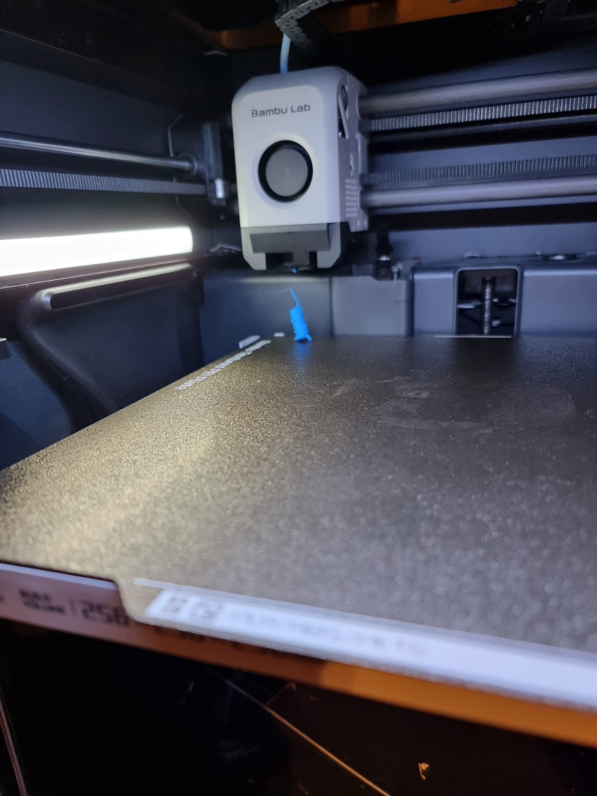

Now I moved th head several times in all the four corners. After this, the homeing got well. I tried another print, it startet fine, but with an offset. (See the blue line in the front). After the first filament change, the print continued in the correct place (dark blue).

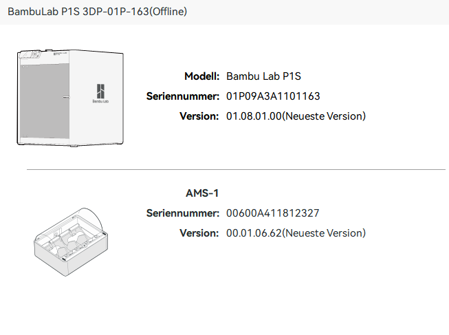

How can I downgrade the firmware? If I try to get an older version, I get the message:
no content available yet.
