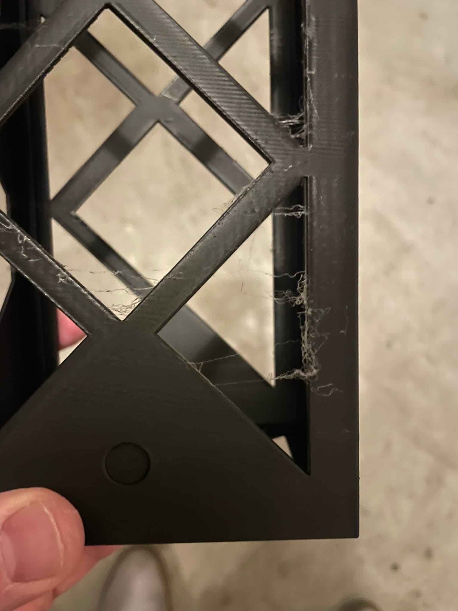

P1S print stringing issues on parts with lots of retractions
I have tried drying the filament, increasing retraction distance .5mm and 1mm (if anything issue got worse), Slowing retraction speed multiple different settings. Nothing has fixed this issue. I did not have this issue for a long time, and it has started more recently on this part specifically that has a lot of retractions. Don’t have this issue on other parts.
I am printing on a P1S with Bambu PLA basic filament. .4mm nozzle base settings. Variable layer height.
Nothing I try seems to improve it at all. Other parts I print that don’t have as many retractions don’t have the issue at all. It is just mainly this one part. I can clean it up with a butane torch, but that is annoying and the finished part does not look as smooth.

IMG_9989
I run a lot of these parts I have probably gone through 15-20 spools all doing this. I dry using a Creality space pi dryer 2 spools at a time.
It isn’t wet filament. I have dried it so much it became rubbery and still did this lol :joy:
You’ve appeared to have done most of the common troubleshooting tests. Three things I did not see mentioned though that may be something to review.
  1. If you’re using an AMS, have you tried running it directly to eliminate the AMS from interefering with the retraction?
  2. Have you inspected the extruder gears when you replaced the nozzle for wear and tear and when you replaced your nozzle did you go back after this stringing occured to make sure the extruder did not somehow come out of alignment. Extruder slippage can influence stringing.
  3. Did you inspect the PTFE tubes for wear? That’ really unlikely but try it to rule it out.
One test you can run is a stringing test with the filament hand-fed directly into the nozzle without the PTFE only to see if it affects the results.
A simple 3 prong string test will be enough. Here’s a cut model I use from the String Hell Test from Orca slicer. It takes only 10 minutes to run.
Orca Stringhell.3mf (56.5 KB)

The one question I did not see addressed here which really should have been the first question. Does this do this with any other filament?
I ask because Bambu filament lately has gone through some changes and there have been lots of quality complaints. It could be as simple an issue as a bad spool. Trying another manufacturers filament will at least rule out a bad batch if the same issues occur. Of course you will want to calibrate that spool from another maker and simply not rely on defaults.
I got a couple suggestions to try here I will try out.
  1. Adjusting temp of the nozzle down a bit I need to test again.
  2. Checking the gears for wear on the extruder.
  3. Not using AMS to feed the filament.
  4. Using non bambu filament.
I’ve had success by reducing the extruding temp down a few degrees. Try the lower-end of the extruding temp. I also have a very sharp exacto knife and one of the little irons used to smooth out PLA. I use those a lot when it comes to intricate prints that tend to spiderweb a bit.
