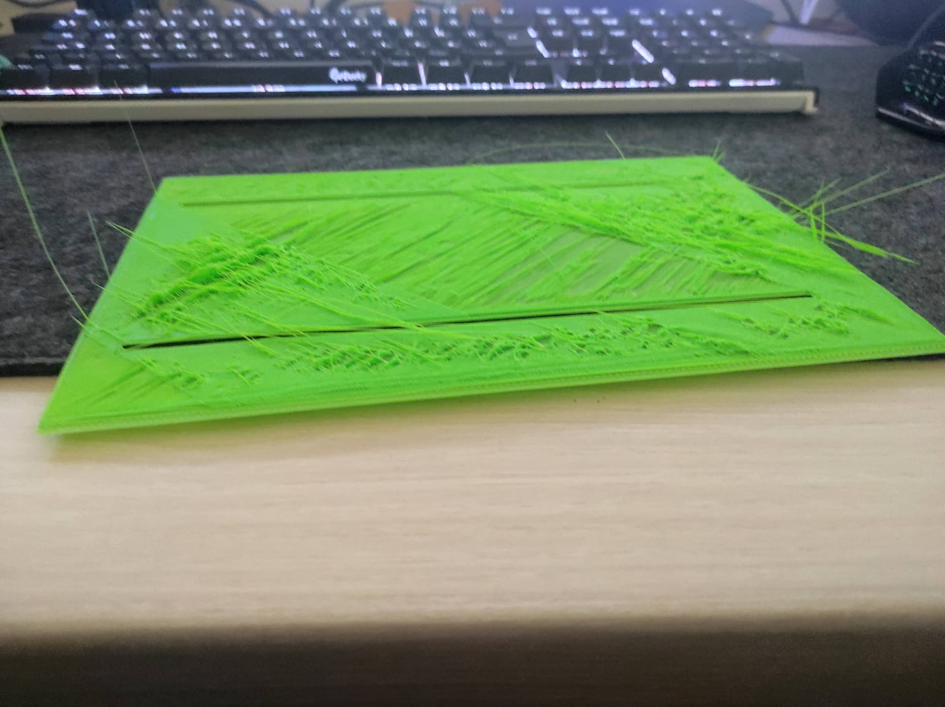

Yesterday a lot of my prints got messed up (you can see below).
My problem is, I printed other models from these filaments without any issue, and they are perfect. Like the drawer below (this one is 1 day earlier than the one above (green mess))
What could be the problem?

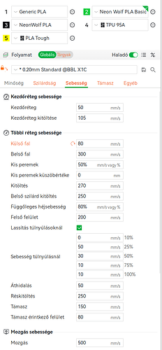

Slicer settings:
Not sure if its relevant here since i managed to print a perfect drawer before, but for that model i used these:
Filament:

I would do two things:
  • dry your filament
  • do the flow calibration
Even if you had succesful prints with the filament, there is no guarantee, that your filament is dry enough. You have a lot of stringing and maybe some underextrusion (maybe line width)… you may share your filament settings.
And for the next print try to print slow to see if it works.
Thank you for the response, a friend pointed me that, at the filament settings i had minimum 100% - maximum 100% cooling for the vents, set it to 50-100 and calibration is a LOOOOT smoother. trying a print now, but i think that caused all the issues.
