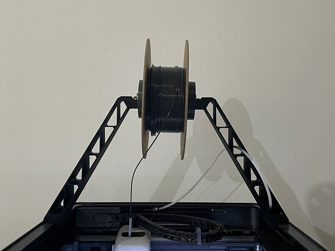

on makerworld, search for p1s top mount spool holder by ATSF. I had the same problem, and that solved the whole issue. Also, you dont have to have the bearings for the print

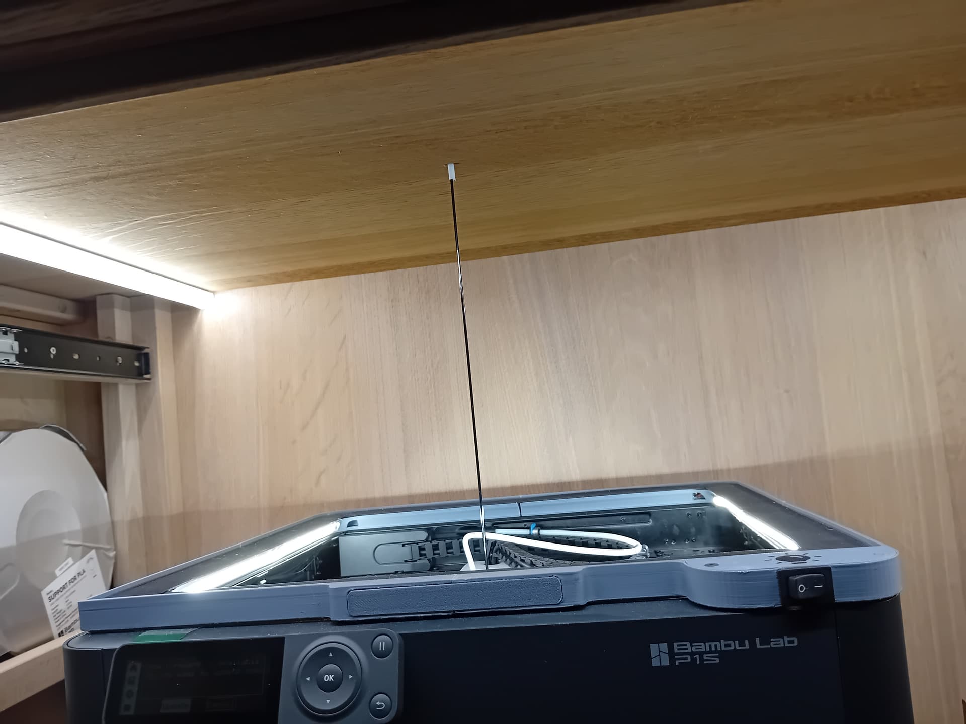

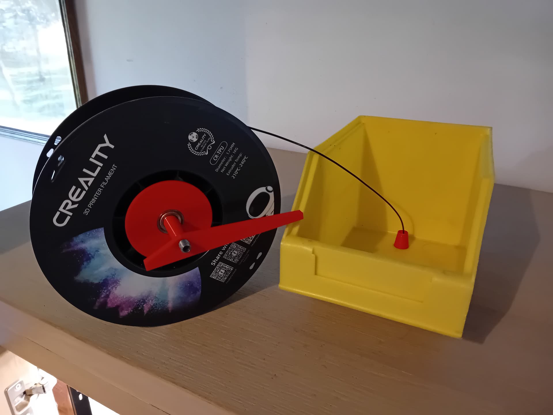

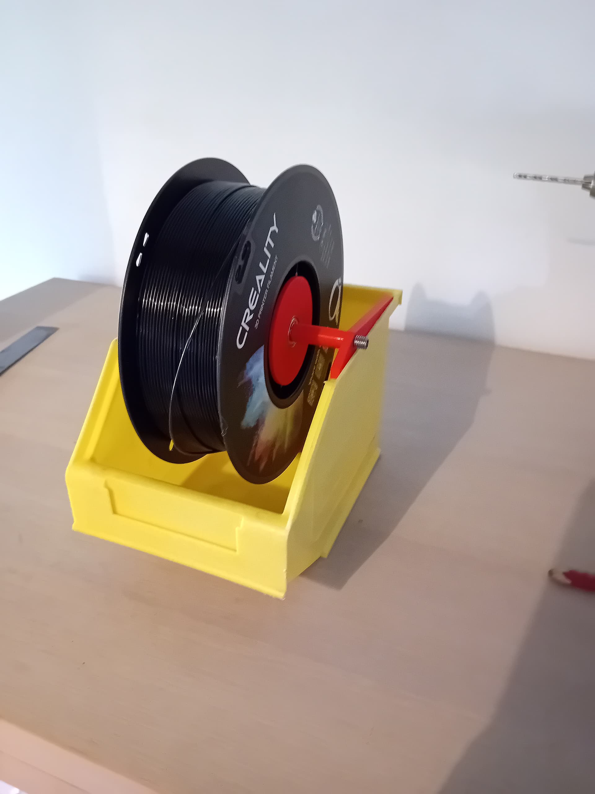

I enclose a couple pictures of my (temporary) solution: Placed roll of filament on a shaft with bearings, put that in a warehouse tray and drilled a hole through the top of the cupboard. I will then put some silica in the tray, and place a bucket over it during printing, hope this works.

In case you refer to the 3 pictures above: no I did not document this any further, as it is a very specific , and untested (yet) solution, with items I had available, or made on my lathe. I merely placed this to let contributors above know what I had done so far.
I think that solution looks great. Let us know how it works out. Look out for the telltale “too high of tension pulling the filament off the reel” - shows up as ragged underextruded layers that tend to resolve themselves. But I think you have a good easy path.
Here you go!

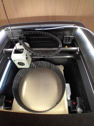

To conclude this story, I can now report that my solution to this issue did work. The print of 10 hours was completed without any problems and to finalize this I’ll add a couple pictures, taken just before the finish @415 lines high. It is a model 1:14 conveyor belt, which is just fitting my P1S.
