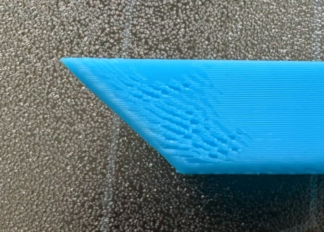

But it looks like your calibrations are a off. That top surface looks underextruded and both flow and pressure advance could be part of the root cause for the lower pic.

The two specific areas that come to mind is pressure advance and flow rate.
Evidence of faulty Pressure advance.
Note: Try this quick fix before anything else. Reformat the SD Card. There are reports that a faulty read from a marginal SD card has been diagnosed as also causing this kind of issue. The theory behind this is that printer filament flow pauses and stutters because it struggles to read a block on the SD card. One thing worth trying is reformatting the card or replacing it. It’s a quick fix at any rate.
This one is a little easier to interpret. You will want to re-run a flow rate calibration.
This too adds more weight to that argument. It looks like the nozzle is running out of filament at the end of the stroke.

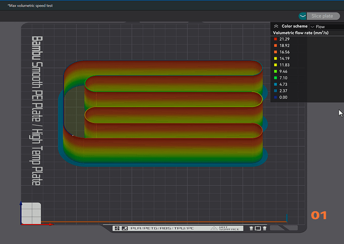

Also, another quick fix experiment in lieu of slowing down the print is to go into the filament settings and reducing the max flow rate. This will likely have the biggest impact on the last image I noted above.
In Orca, their is a test specifically for Max Flow Rate. But for experimentation purposes I would just set it to 10mm³/s for now.
The Orca test varies the GCode to change the flow rate for each layer. View their tutorial if you’re not familiar with it.

  2. I am using bambu studio and I will recalibrate again, it might be that I didnt do it properly since I am fairly new to this. And I will try to reduce the volumetric speed down to 10 and see what happends!

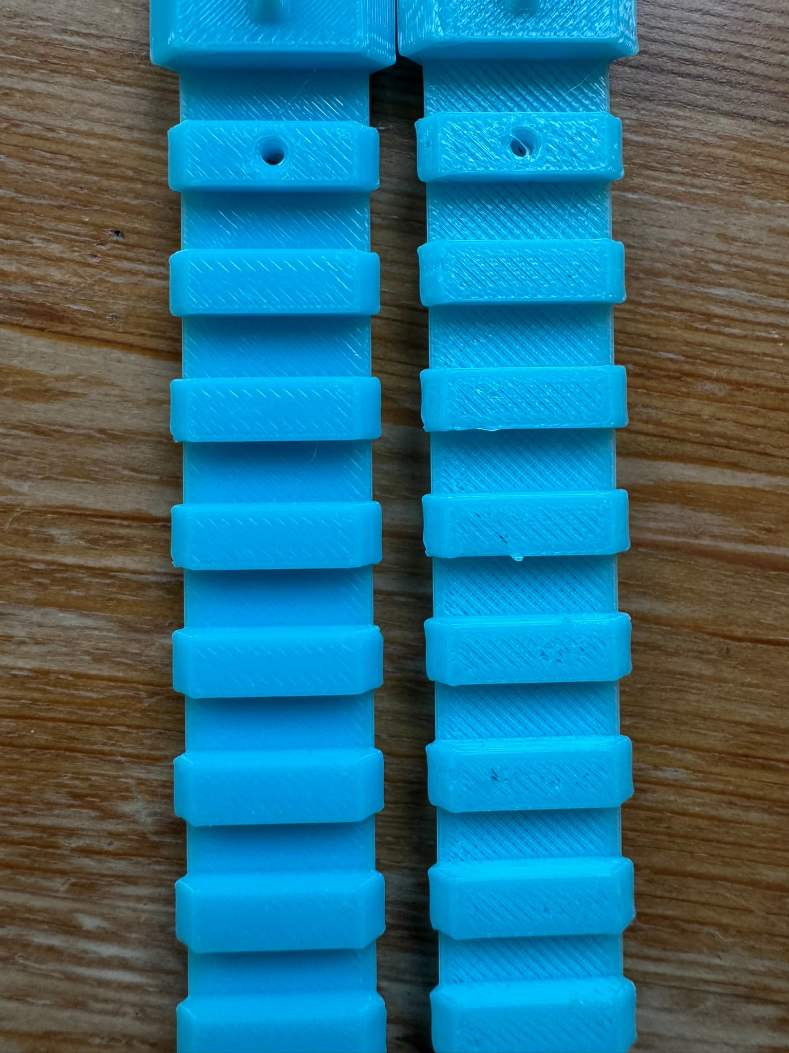

I did a recalibrate and here are the results, right was the old one and left the new one. It is way better! On my second pic, I still have those little holes. I read about that I should probably decrease my retraction lenght a bit? Its at 0.8 at default so I am trying now to lowering it down maybe 0.1 per print and see how the print will look like?
These bursted bubbles are in the same layer.
I think it is more of wet filament than retraction or SD card reading problem.
Drying filament in the oven could take days to fully dry, in some extreme case.
I am pretty sure I dried my filament in my S4 for at least 6 hours and then it was sitting in my ams for 2 days with a humidity of less than 10%. But you could still be right.

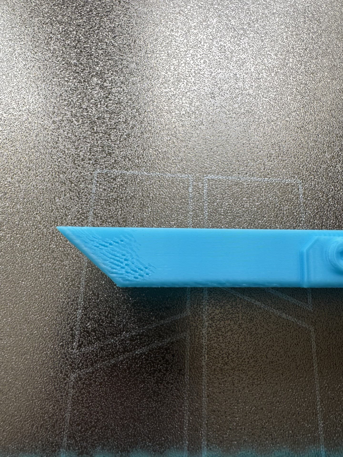

Do you perhaps know what is causing this overhang issue here? Which I have lately? Is that some cooling issue?
Looks like a curling defect to me. Additional drying may help with that. 6h is a bit short for new/wet PETG as it is quite sensitive to moisture.
Once dried fully, you may also improve curling behavior using adaptive layer heights. Aim for a halving of the layer height at overhangs.
