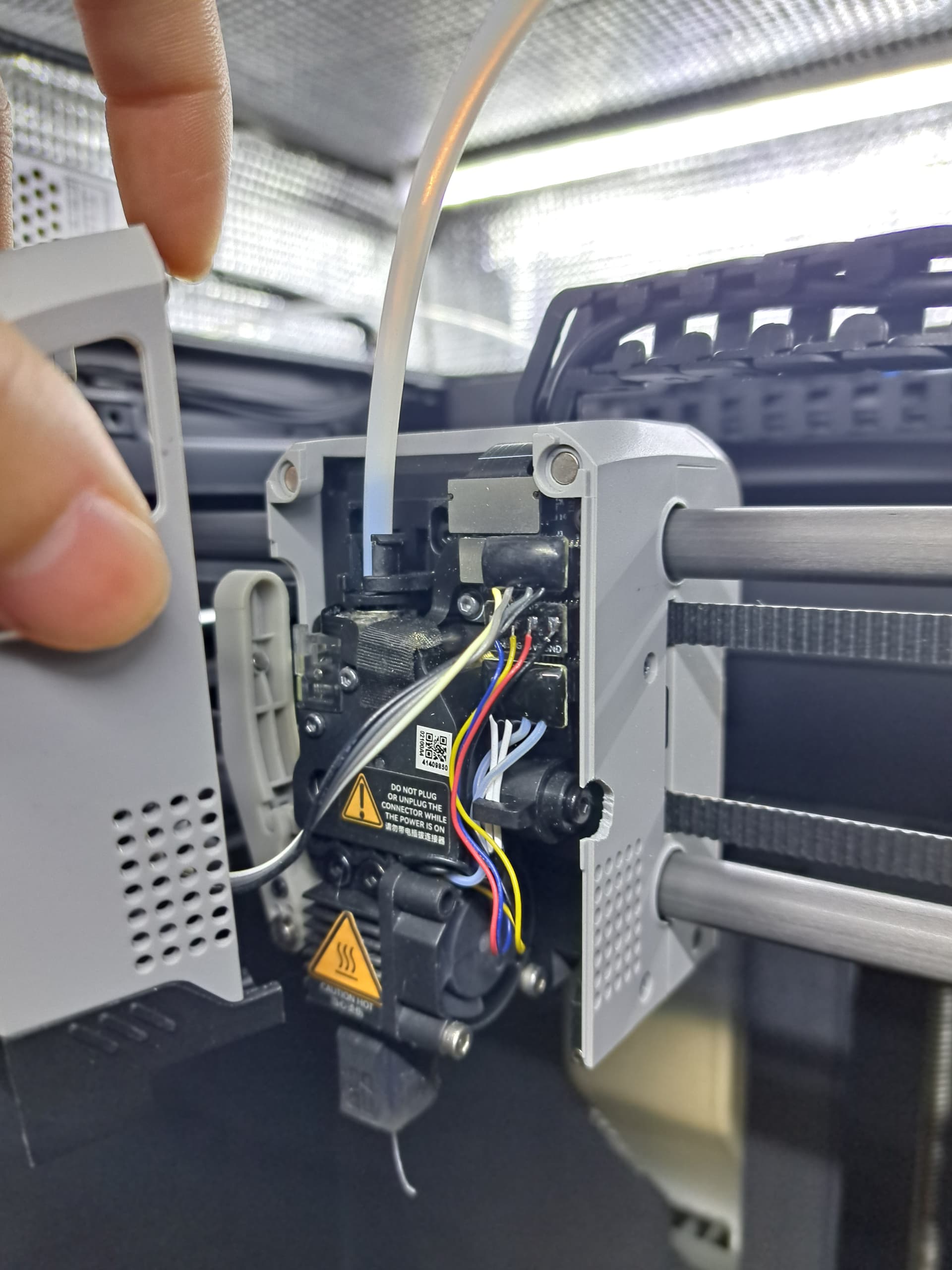

I did this mod to print soft TPU.
What exactly is the mod for the extruder?
Drilling/cutting a hole on the side of the head enclosure plastic so you can easily access the tension screw.
I think they prefer to be called “Speed Holes”
I thought they were called Burr Hole or Trepanning? :laughing:
Oh! I did not even notice it!

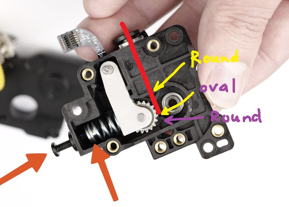

When round filament squeezed so hard that it becomes oval, then isn’t it harder to push it through the plastic throat there?

A couple weeks ago I went through a saga… or I could say a nightmare. A whole weekend, starting from friday night going through the weekend, ending at monday night, with a partial solution, almost 90% complete solution. And this solution is this same mod. I don’t remember being so angry as that “TPU weekend”… I couldn’t sleep, eat, think… TPU was destroying me. My P1S simply wouldn’t print TPU. A dozen minutes printing, and it started a severe under extrusion. If I didn’t stop the printer, it would clog the nozzle.
I tried everything throughout those 72 hours… stock nozzle, hardened steel nozzle and gears, tried every possible combination of speed, flow, temperature… nothing… filament was drying for 48h straight on my Creality Pi… tried printing directly from it… with PTFE, without PTFE… fed from the back spool holder with PTFE, and without PTFE… finally I printed a top spool mount, to feed TPU DIRECTLY from above, without ANY interference.
I had more than 12 clogs that weekend, I stopped counting after that… after each failure I did 3 cold pulls sequences, and used a needle to unclog the hotend… I diassembled my extruder 9 times… cleaned everything, everytime I opened it… checked my fans everytime… I made sure that I wasn’t having heat creep issues… door opened, top lid removed, controled room temperature…
NOTHING WORKED!!!
Than… after some last resort research… I decided to mess with idle tensioner spring… did exactly that mod, a hole to be able to access that bolt… Manually fed the TPU with a 250ºC nozzle and started extruding, while unscrewing the bolt at the same time, and observing the thickness of the extruded material, until it turned a fatter line. And finally I managed to print flawlessly…
Loose the screw, just do it! How many turns? Three, four… seven… don’t know. Just loose the bolt while extruding at 250ºC and look for a fat extruded molten material.
So… the problem is inside the EXTRUDER… too much tension, squeezing the soft filament, making it unable to be extruded correctly. And, when I said 90% solution, it’s because sometimes I still have under extrusion issues. Sometimes I need to cancel the print, and sometimes the extruder “corrects itself”. Perhaps I still couldn’t find the REAL sweetspot on that spring.

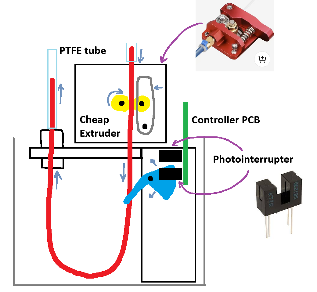

This setup basically replaces the filement buffer (detect when extruder needs assist) + AMS (with assisting motor)
But not really sure if this can be used with P1S.
Anyhow, I am staying outside of walled garden: Orca + old firmware P1S so I don’t think I will go and buy this TPU feed assist module + AMS HT.
Meanwhile, I’ll take my time to do this as a hobby
I know this setup works flawlessly with TPU 85A because I already did it, but don’t have time to perfect it into open source project.
